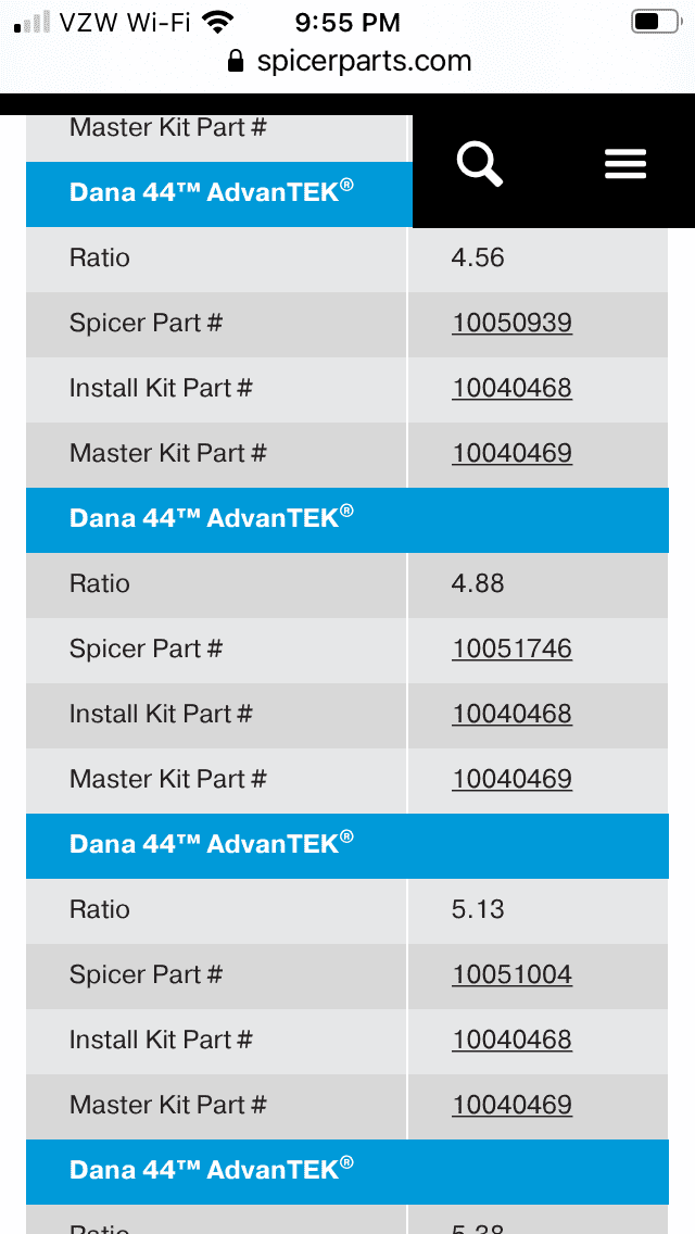

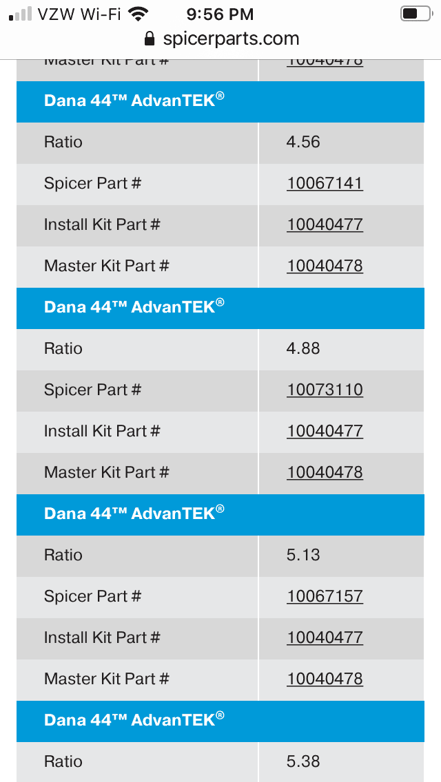

Dana sells just r&p sets, they also sell r&p kits that include pinion bearings and shims, then of course the separate complete master kits.
Since they are Mopar, they can probably get away with selling you just the gears, crush sleeves, and pinion seals while still being covered under warranty?
Every gear job that rolls out of my shop gets a master kit....I dont care if the vehicle has 5 miles on it.....Mopar isn't going to warranty the bearings after I'm in there and I can't warranty Mopar's bearings either.

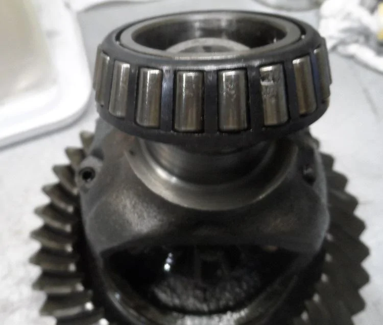

With the master kit - you have the MOPAR warranty on the parts in the kit. Isn't that something like 2 years?
Jeep Gladiator Need Help: 4.88 Mopar Re-Gear Issue sx4-carrier-brng_3654 (1)
Idk, I don't buy gear parts from the dealer......way too much Mopar tax!
