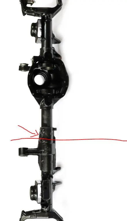

I have bought a 2022 Altitude with a broken front axle.On the picture you see where the axle is cracked. I had shipped the car to Germany and need now some input to repair it.
I think that the are two chances to repair it, no...three.
1.Buy a new one 2. buy a used one or the 3. repair the broken one.
I will first remove the axle to check with a company who is specialized in fixing Jeep axles if the can repair this one.

If broken at the red line. That is the FAD housing. Which is cast iron. That's going to be fun to weld.

If you end up swapping out the complete axle make sure you have the same gear ratio front and rear. US Rubicons/Mojave/Max Tow have the long 4:10 ratio axle. Other models come typically with the short 3:73 gear ratio axle. Rubicons also have the front locker.

Hello , thanks for answers and tips. Local pickup is a little bit complicatet. :)-)) . I found a company in Poland wich replaces the FAD housing and put an axle truss on it. I will post some pictures when it is ready here.
