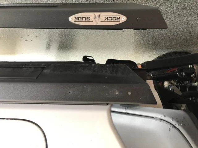

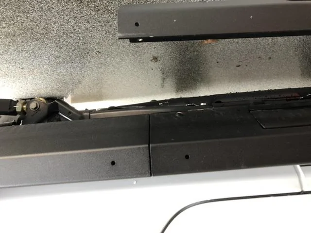

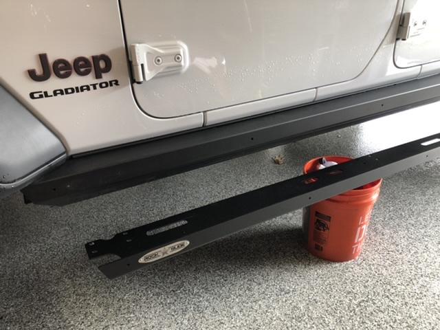

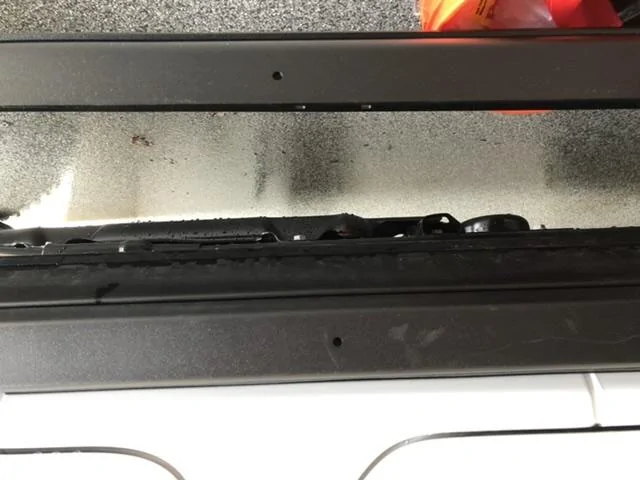

I purchased a set of Gen 3 RSE slide steps and armor. I installed the slide steps no problem; however, the armor holes didn’t line up at all.
My request is to the folks who have both the Gen 2 or the Gen 3s is to measure the distance from the first hole back to the end of the long section and between the holes on the short section. Can someone take some time to measure yours and tell me which Gen you have?
The measurements, the first hole being zero From front to back.
RSE Step Slider first hole to second is 21 3/4”, first hole third 43 5/8”, first hole to fourth 65 1/2”. Short rear piece measures 15 1/2”.
Armor from first hole to second is 22 3/4”, first hole to third 45 1/2”, first hole to fourth 68 1/2”. Short rear piece measures 15”.
