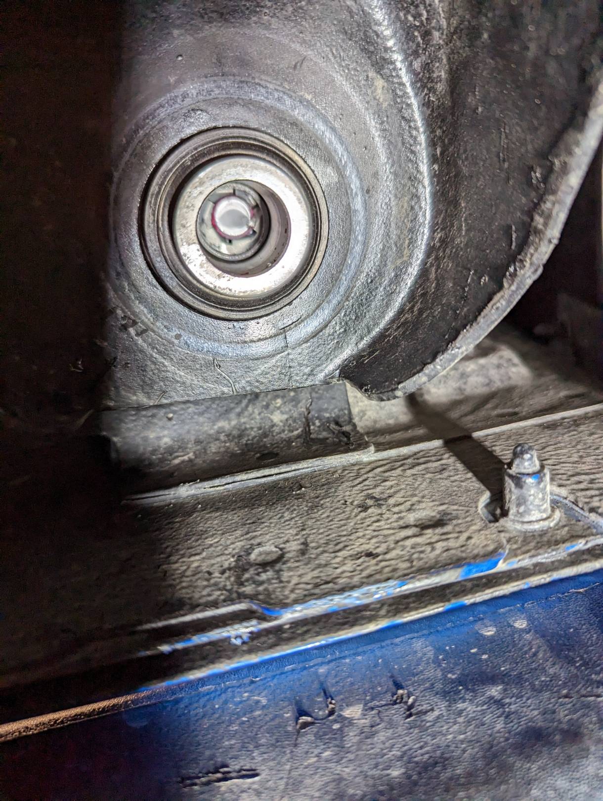

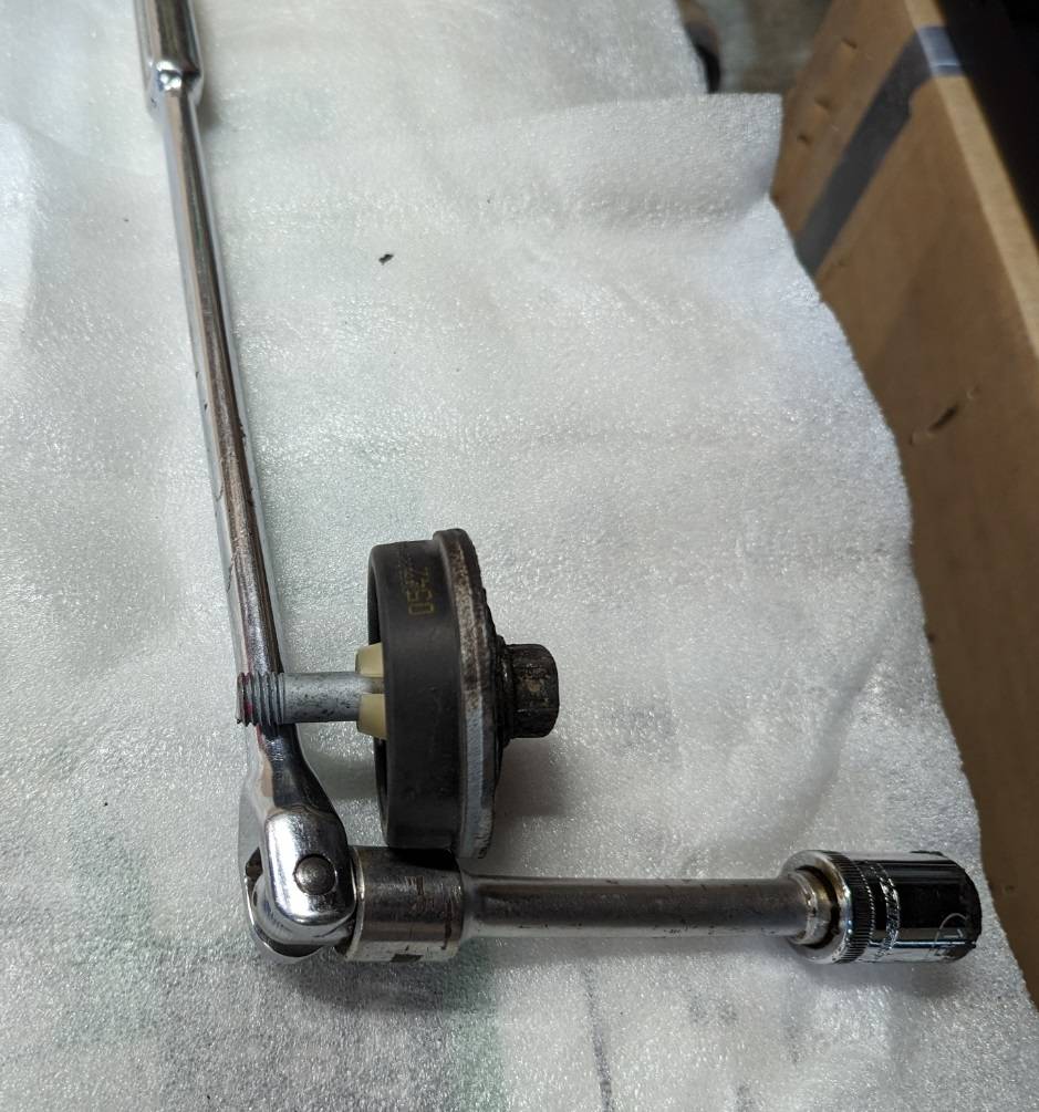

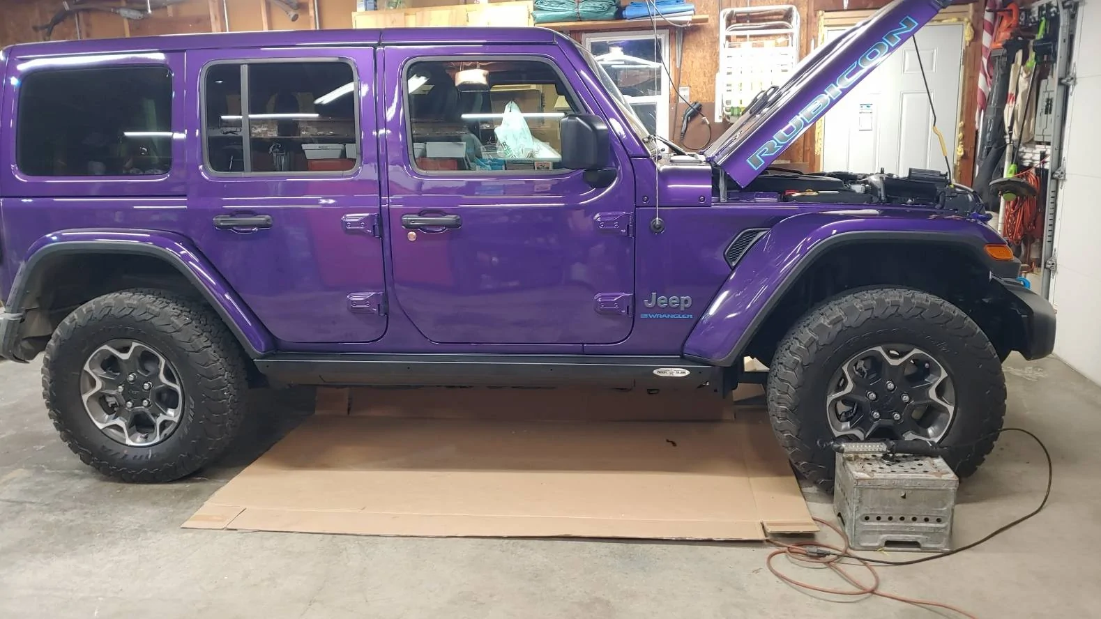

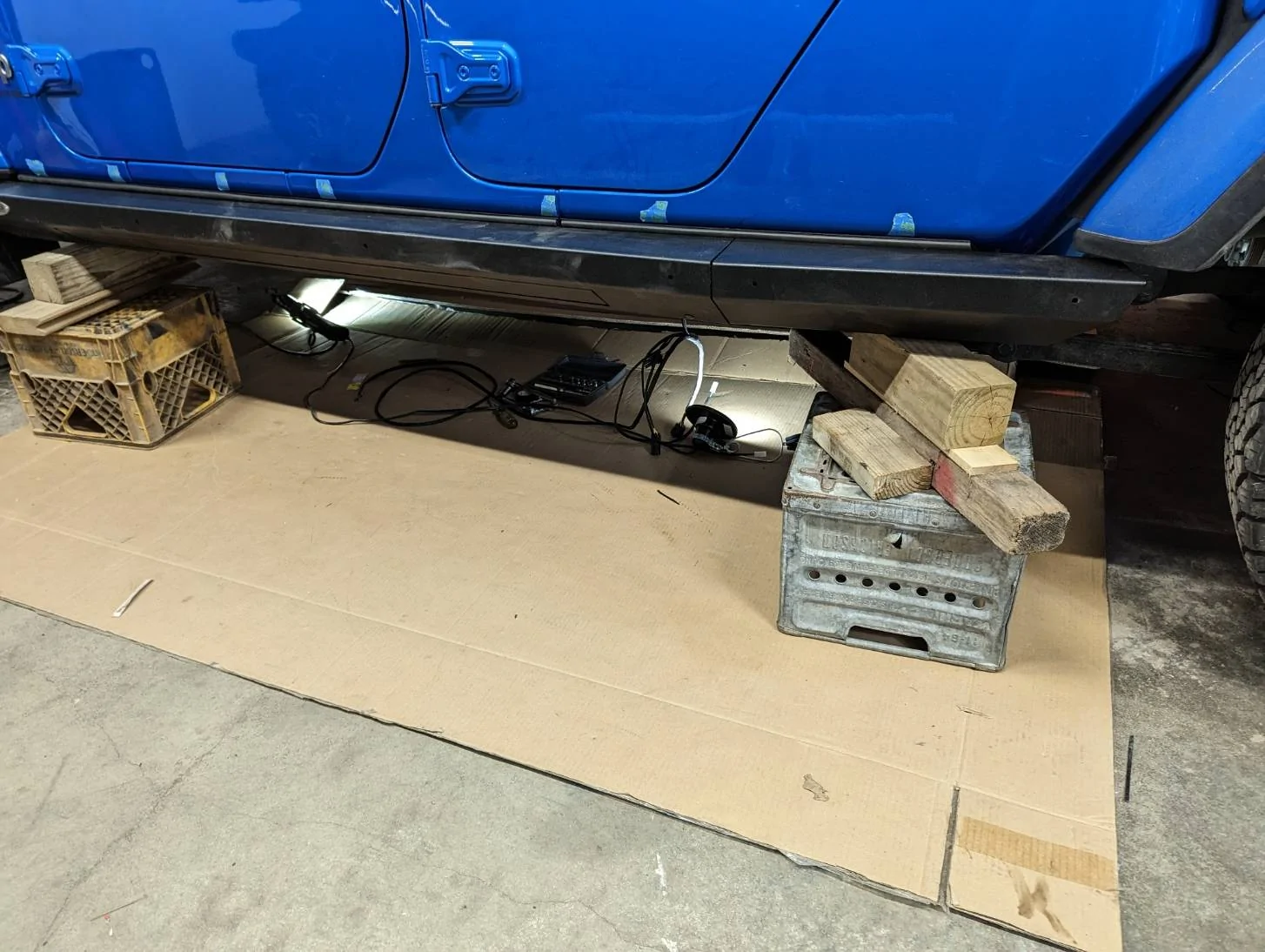

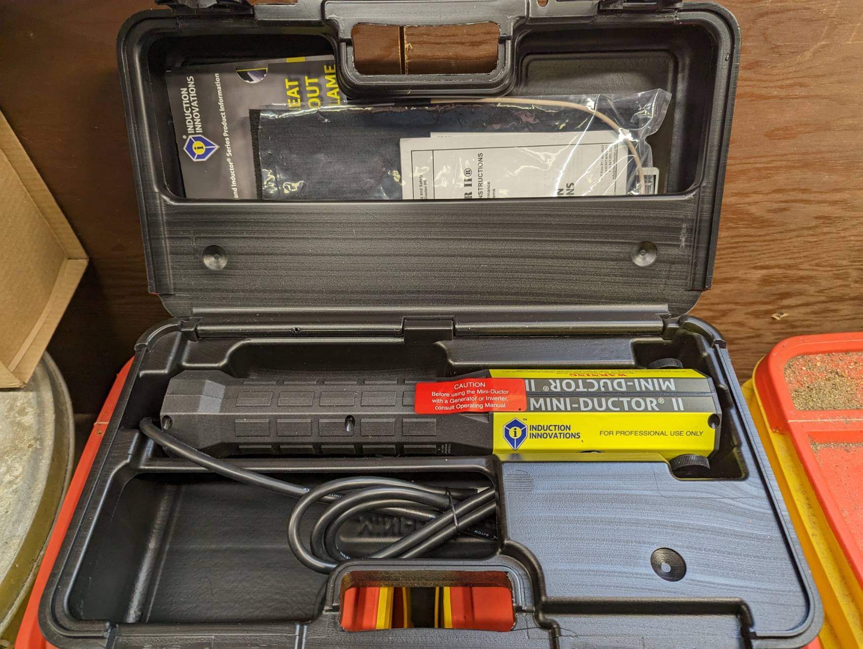

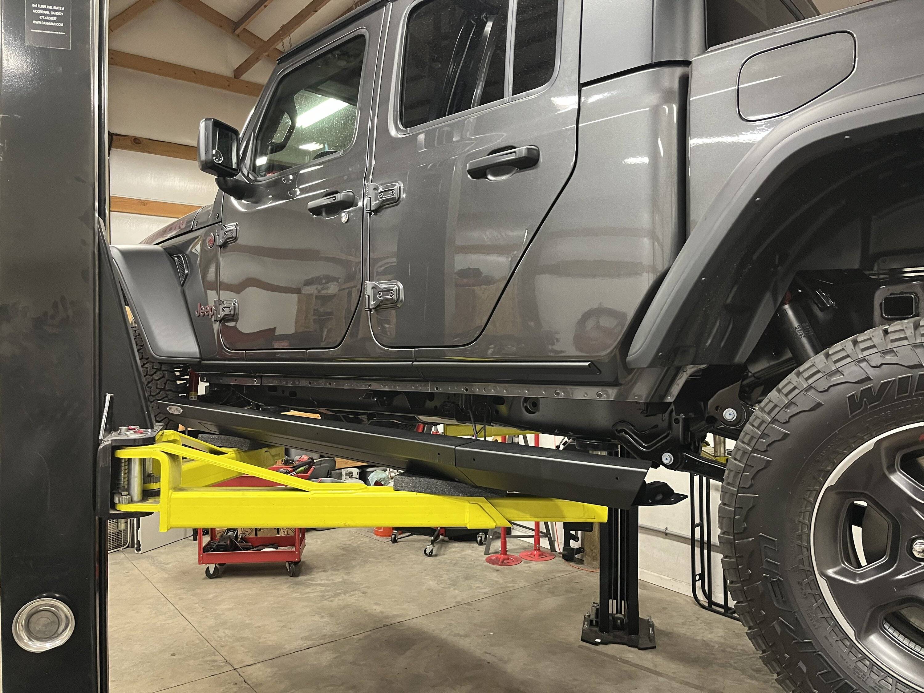

Guys, I was able to loosen all the body bolts and get the step sliders installed! Decided to create a video for it (to help others) as I couldn't find one out there doing the process that you guys explained to me.
I heated the bolts to about 300F. They were still a bit tough to remove EXCEPT for the front passenger bolt that I accidentally heated to about 325F. That one came out so easy that I thought that the bolt sheered off (it didn't!).
By the way
Thanks for all the details to help me get over my nerves on doing this!
