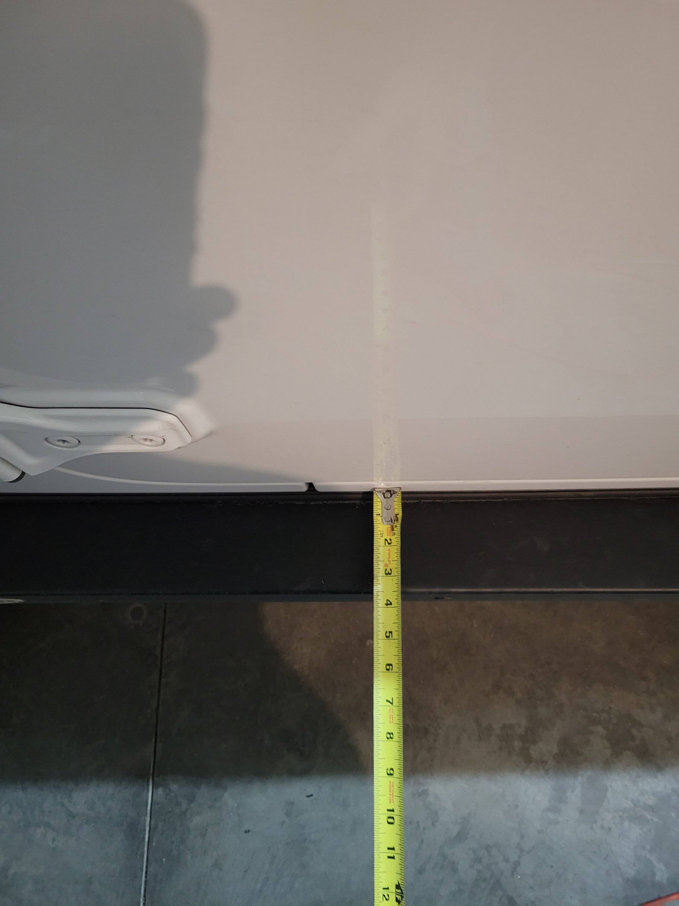

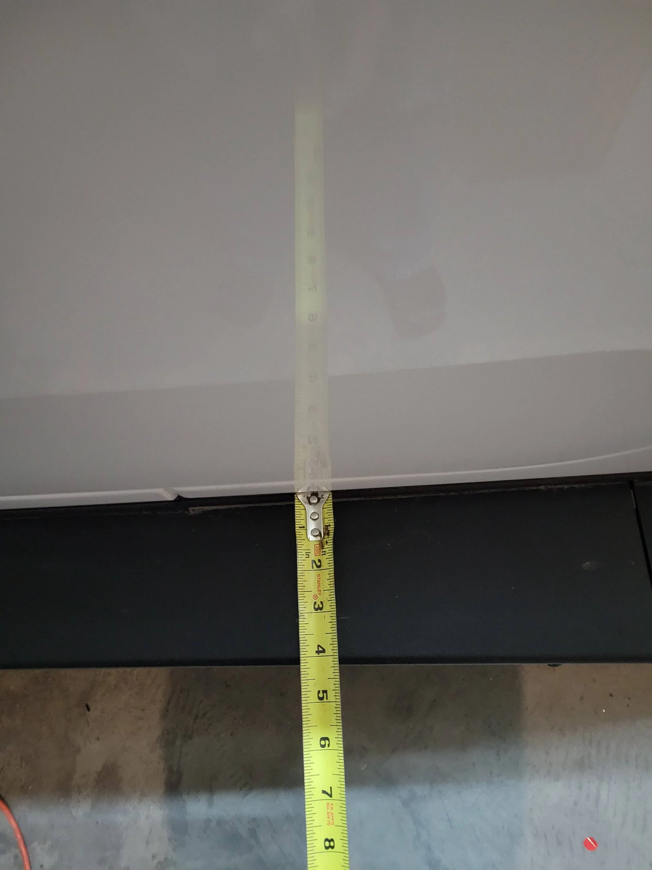

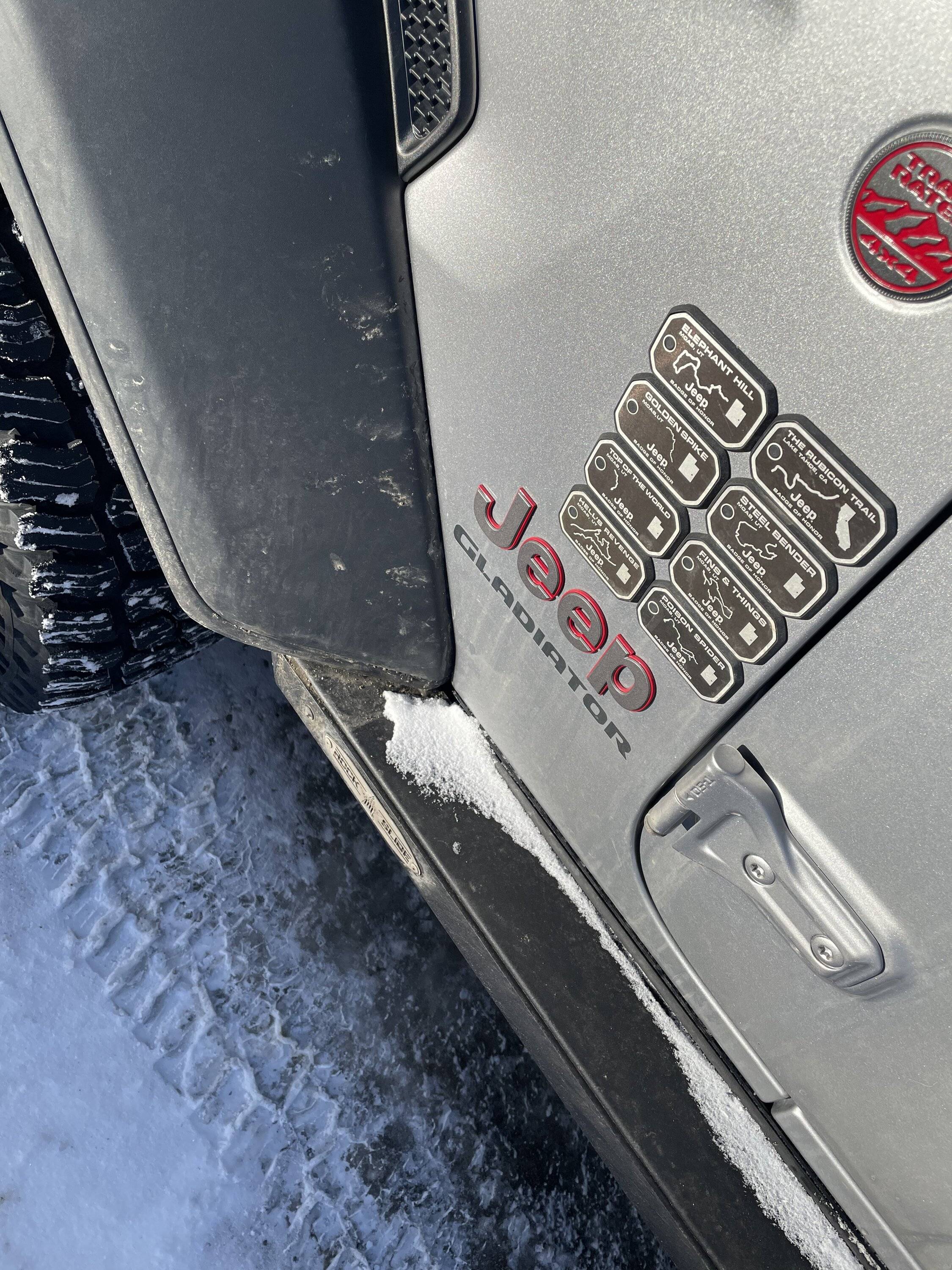

Jeep Gladiator Rockslide Engineering Power Steps 20230112_203023
Back door
Jeep Gladiator Rockslide Engineering Power Steps 20230112_203101
Back door by hinge
Jeep Gladiator Rockslide Engineering Power Steps 20230112_203125
Flare
Glad to grab other pics if those aren't quite right. Coming from the Rubicon rails, these are fantastico for splash

Wow, thanks. That was fast.
It looks like you are measuring from the rocker panel face itself.
At first I thought - rats, those are 3" narrower at least.
I measured from the pinch weld under the rocker so that may be part of the difference.
I'll try to measure mine again tomorrow to see if I can duplicate how you measured for a more accurate "apples to apples" measurement to be fair.
Looks like my running boards sit just a bit lower so I was able to slide the tape measure up against the flange with the spot welds and that likely accounts for at least 1" of mine appearing wider.
I sure would like these to work for me - but don't want to give up the width - or too much width.

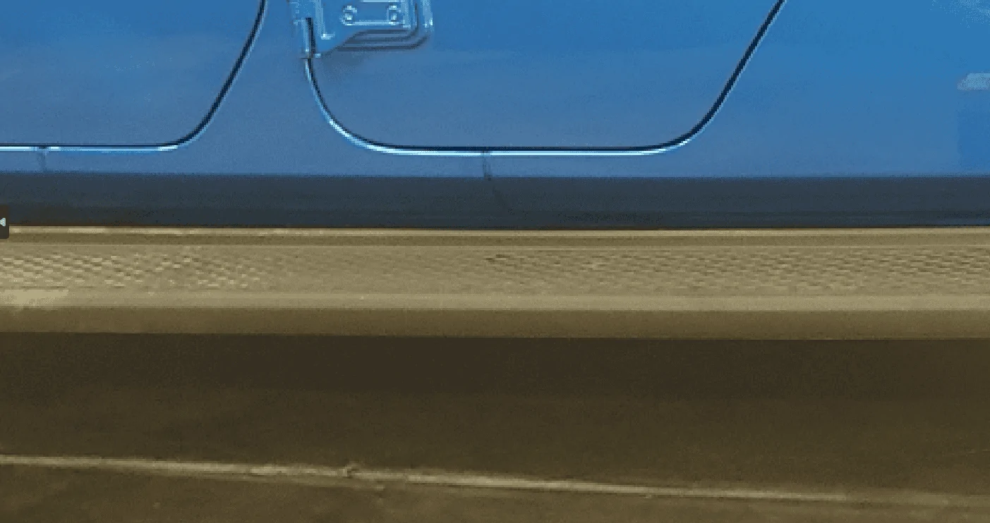

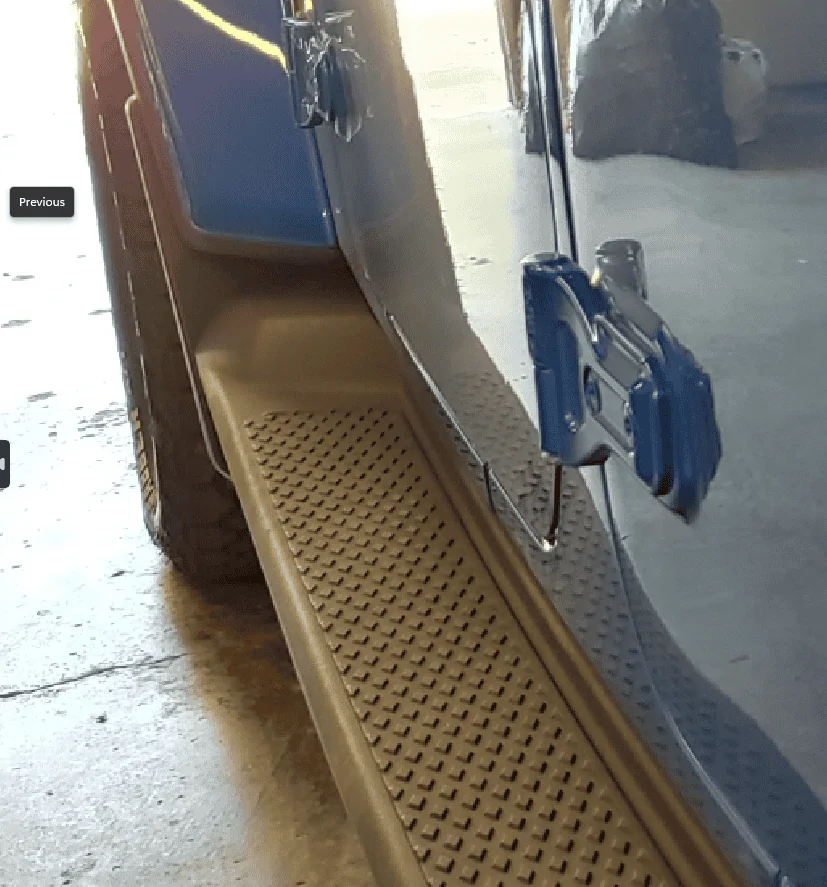

Stock Overland running boards sit low so you can see under the rocker panels to the pinch weld area with all the spot welds below the rocker.

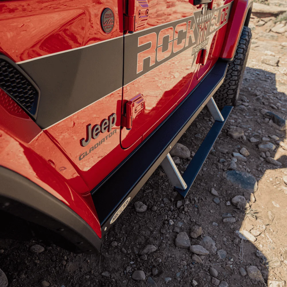

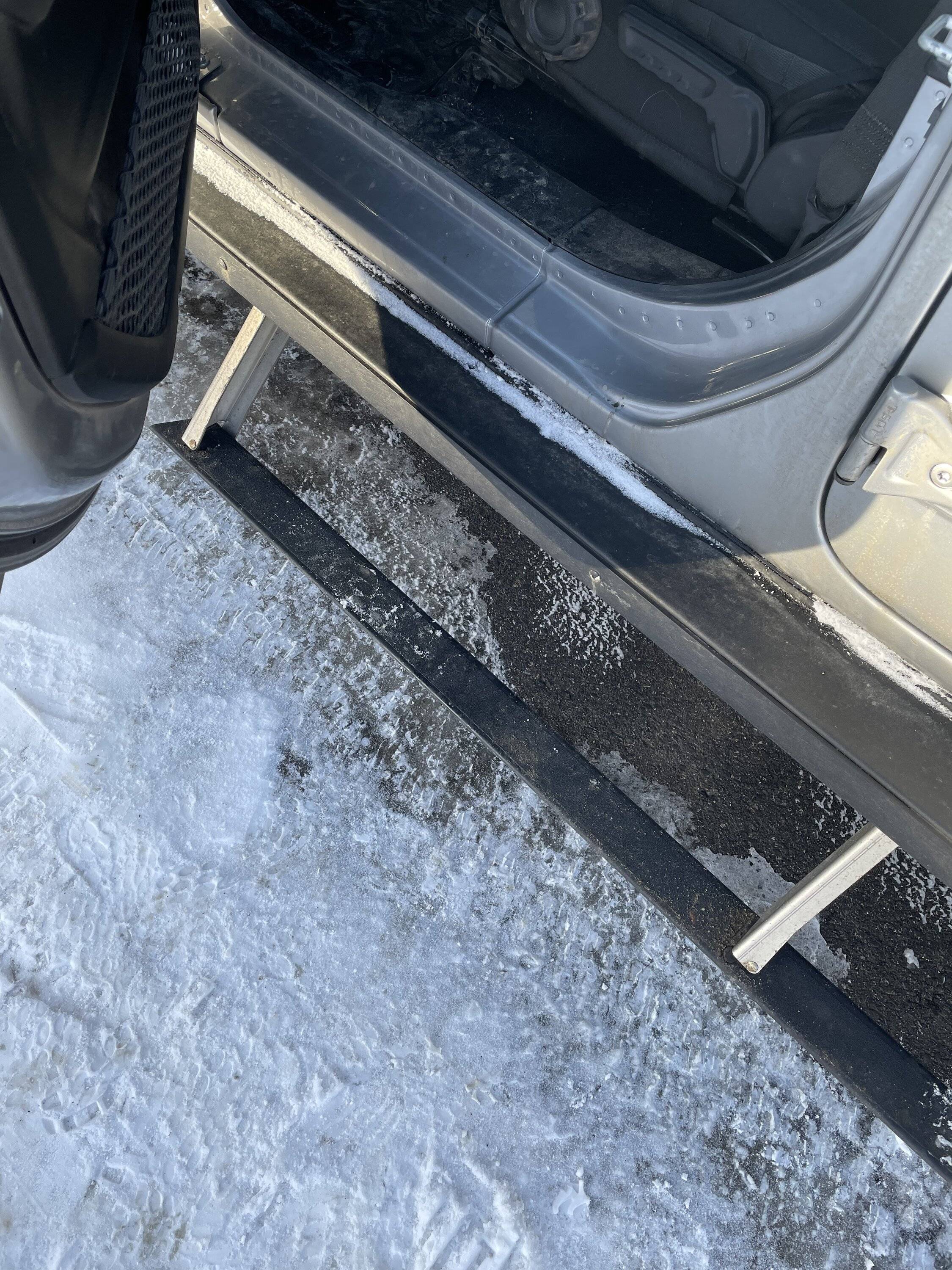

Here's a picture of the steps deployed.
Jeep Gladiator Rockslide Engineering Power Steps 1673614239140
You can step and stand on the piece that lowers down but I don't see any reason why you couldn't stand on the upper part of the step. You may want to put some traction tape on top of you're going to make that a habit but I believe the slider will take the weight of a person (assuming you're under 250 lbs) while washing without flinching. (I'm 250 lbs so that's why I gave that estimate)
Full disclosure about my step experience:. I LOVE the steps. I've had a bit of a challenge with the passenger side unit. Rock Slide could not have given better customer service in sending me a replacement sensor for the doors in a timely manner.
I've had my steps on for about 6 weeks or so. I'm probably just coming out of the "honeymoon" phase with an expensive purchase.
So far the biggest issue I've had is making sure the supplied magnets are in the appropriate place to activate and deactivate the steps. I've had a little trouble with deactivating the steps on the passenger side. It is winter here in Utah and a VERY wet one so far. Being an electrical device exposed to salted roads, it would be unrealistic to expect optimal performance during the road conditions I have had these in. However, there is a pretty steep entry price and I could understand someone being a bit grumpy about needing to call customer service
My "real" evaluation is that the jury is still out on if they are worth the cost. If I have the steps shut off, I REALLY miss them. For the trail use my truck sees, I NEED these to not stay deployed, ever.

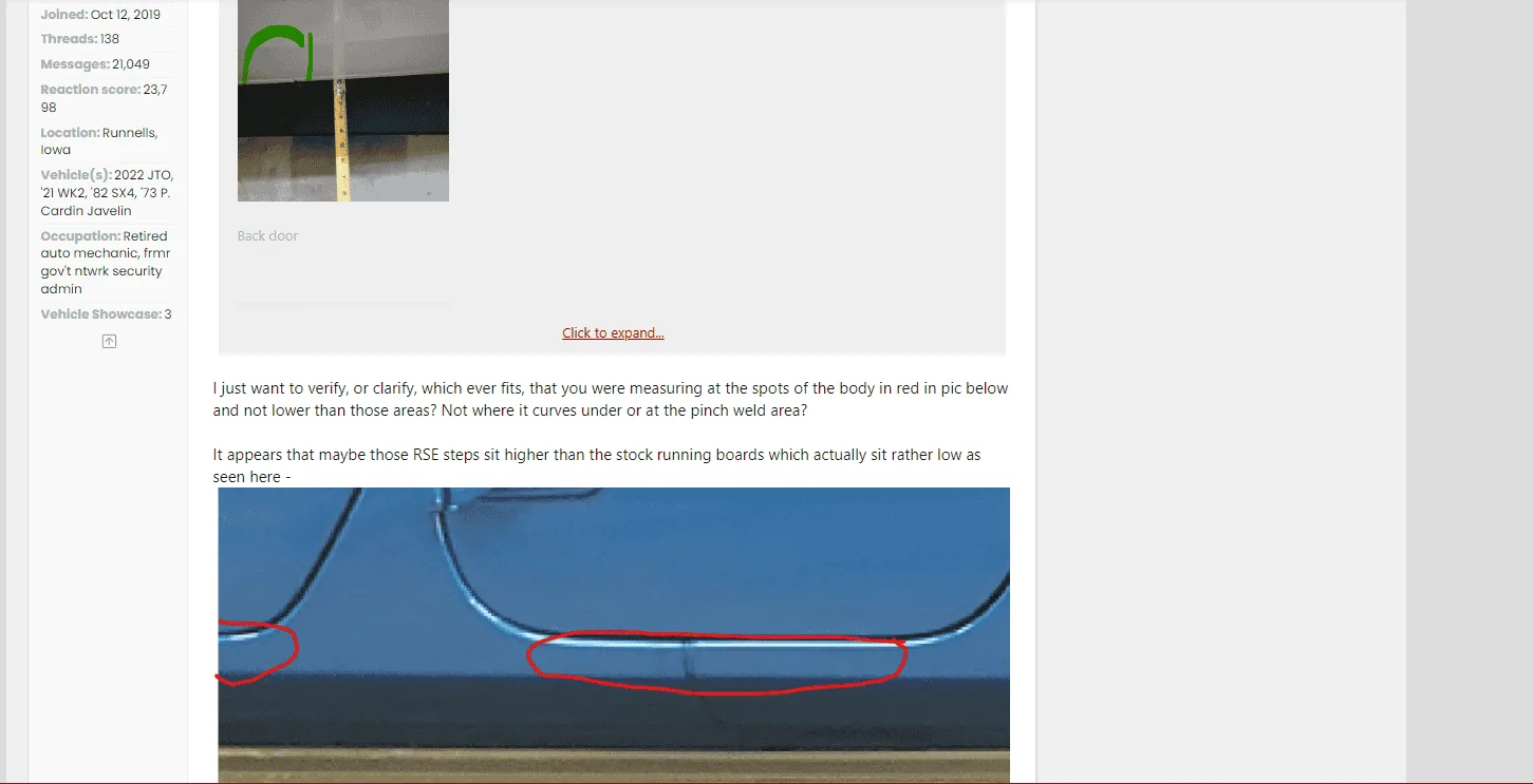

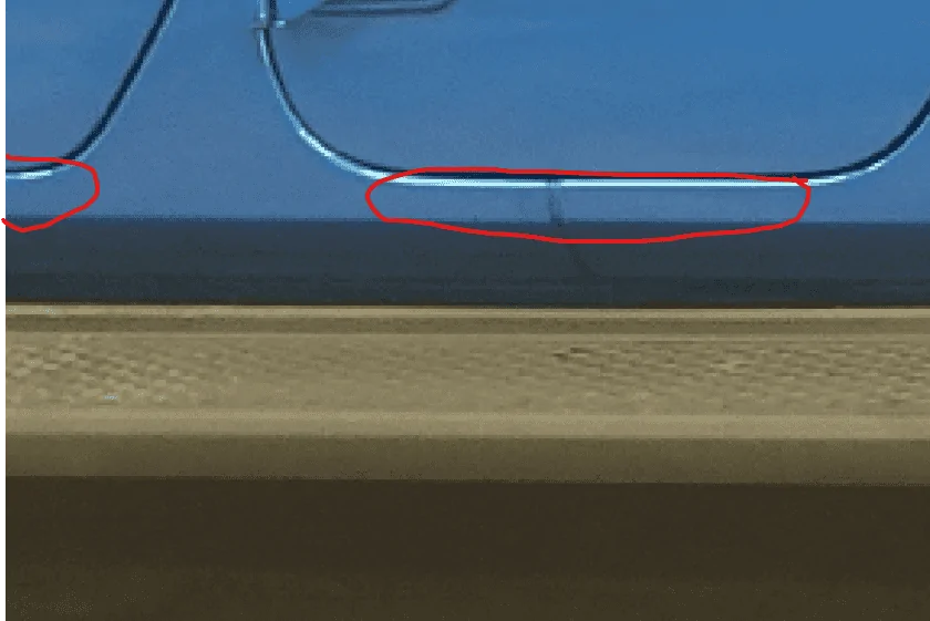

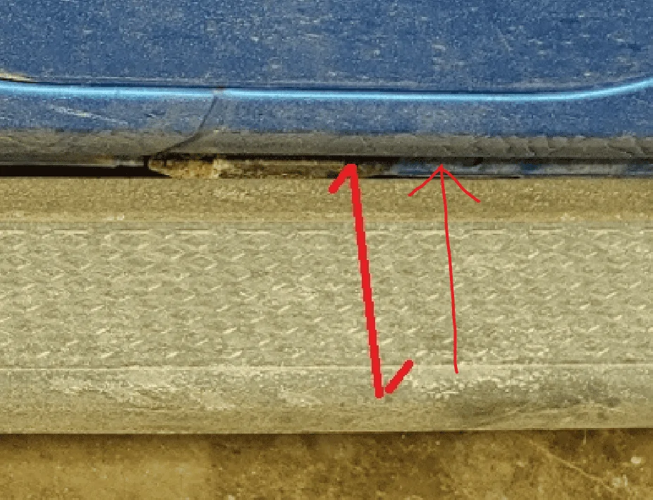

I just want to verify, or clarify, which ever fits, that you were measuring at the spots of the body in red in pic below and not lower than those areas? Not where it curves under or at the pinch weld area?
It appears that maybe those RSE steps sit higher than the stock running boards which actually sit rather low as seen here -
Jeep Gladiator Rockslide Engineering Power Steps 1673998269892

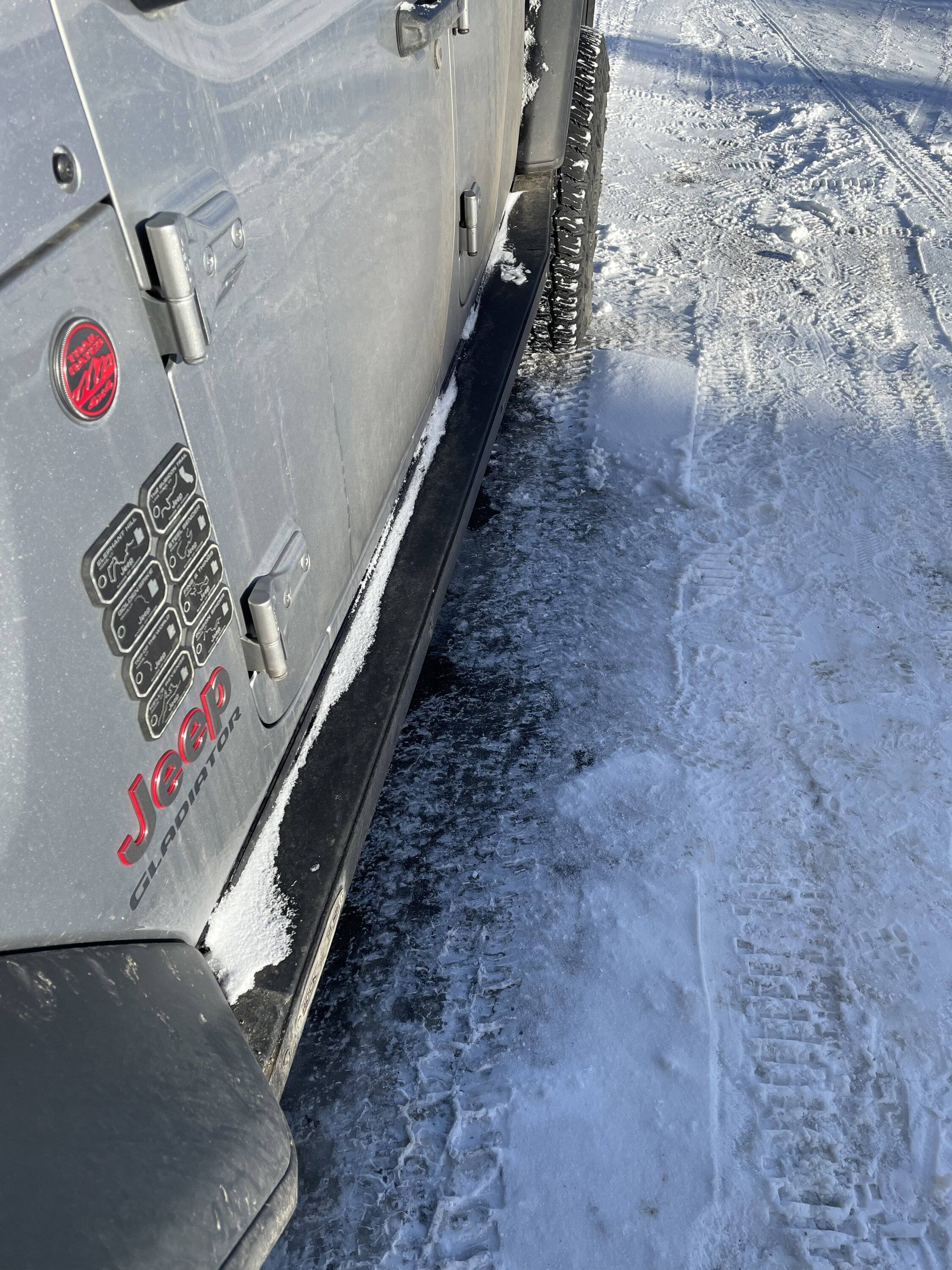

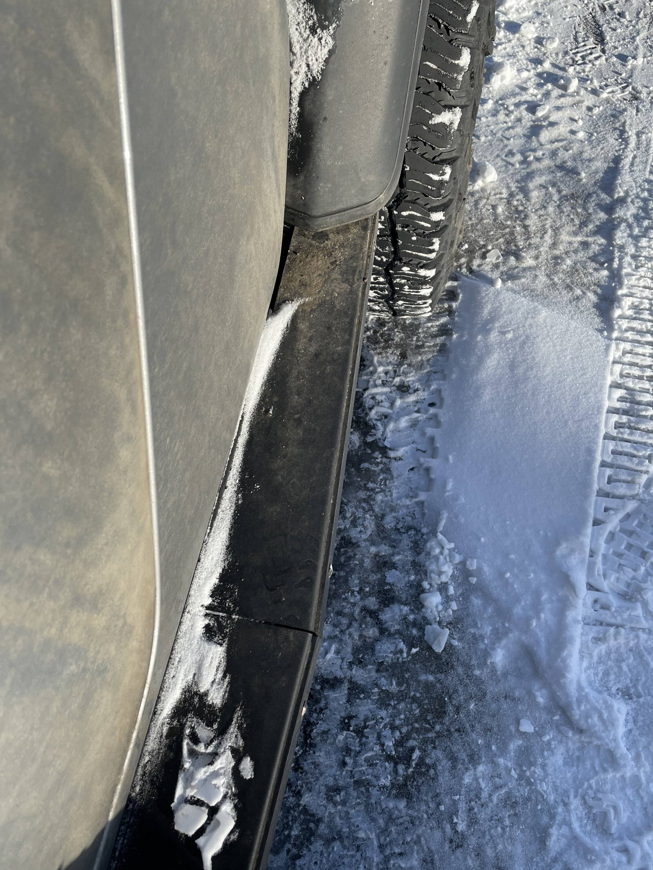

I texted these to you Bill, but maybe you didn’t get them on that number I had. They suck right into the pinch weld, so you really can’t see it. I didn’t have a ruler on these, but they’re narrower than your steps. Either way, they’re plenty stout to stand on. What do it frequently. And even though they’re narrower, I’ve never had a stability issue standing on them. They also do a very good job keeping most crud off the doors, even without mud flaps running wide 37’s.
Jeep Gladiator Rockslide Engineering Power Steps 8ACAF96F-DB55-47E6-9ED7-BB37393BE1B6
Jeep Gladiator Rockslide Engineering Power Steps C9F71FE1-B361-42BA-B5E5-E5F9EDF7A37E
Jeep Gladiator Rockslide Engineering Power Steps 236C7DAA-8322-4D99-9628-A43C2F4E57D6
Jeep Gladiator Rockslide Engineering Power Steps 9B9B06A5-6538-49B4-AC86-BA2CCB923A52

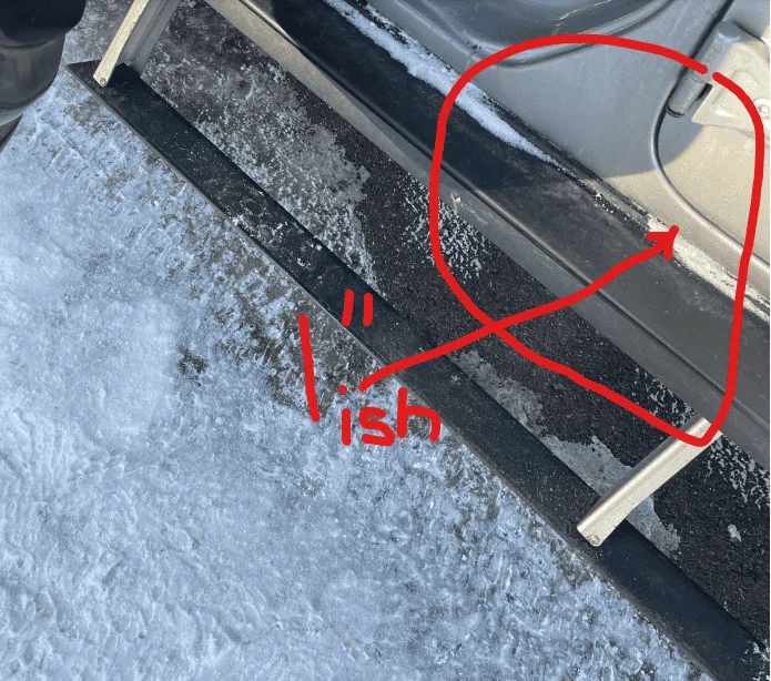

Jeep Gladiator Rockslide Engineering Power Steps 1674001493573

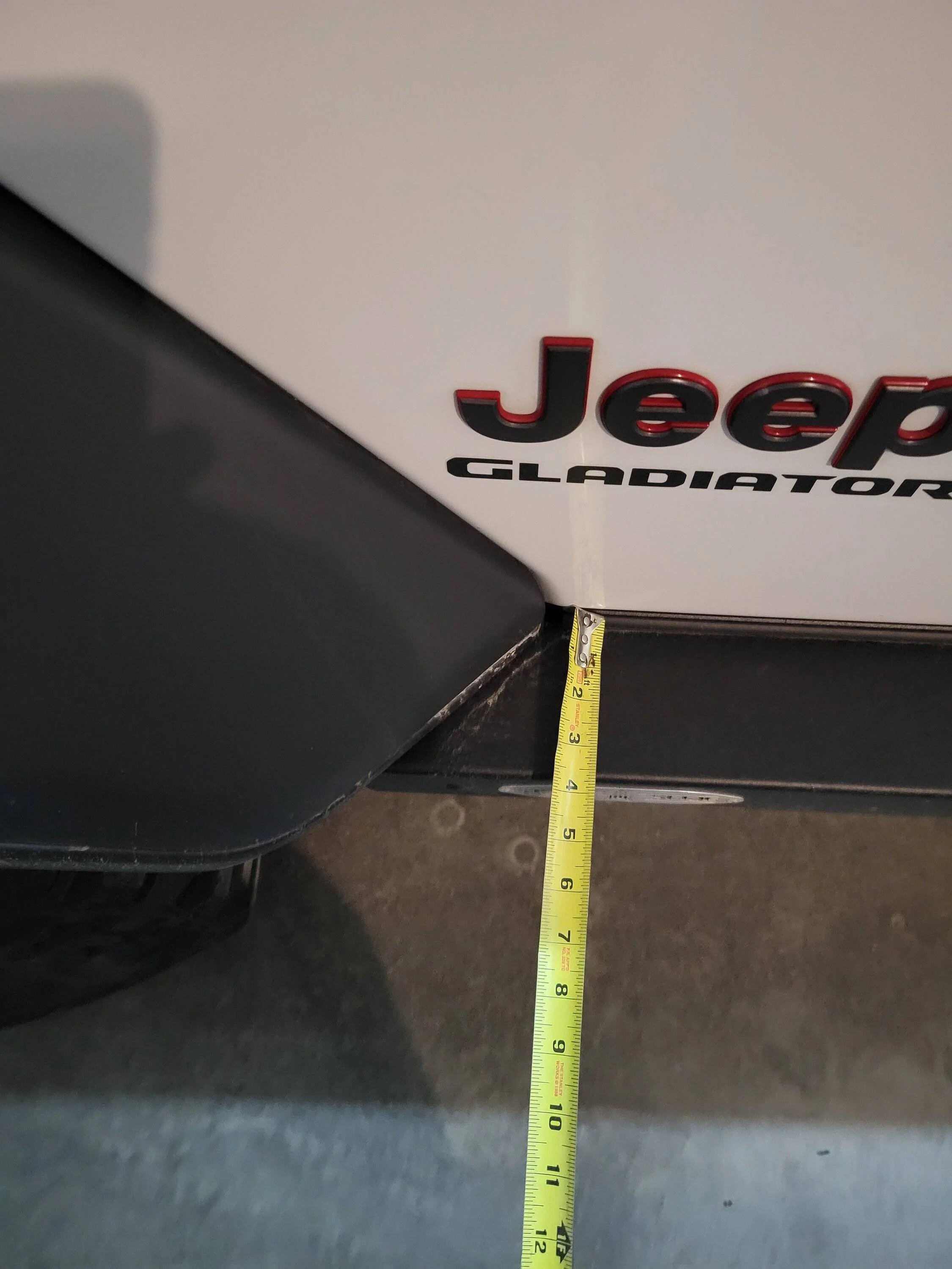

I think we are measuring from the same space? I only have the 1"ish vertical space between my door sill and the slider/step. It looks like my tape is about 3" back from the pinch weld on my white JT. It does appear the tops of the Rock Slide steps are at least 2" higher (they are pretty much right at the angled bend in the sheetmetal) than your stock runners
@Summitdan is exactly the same as my setup.
