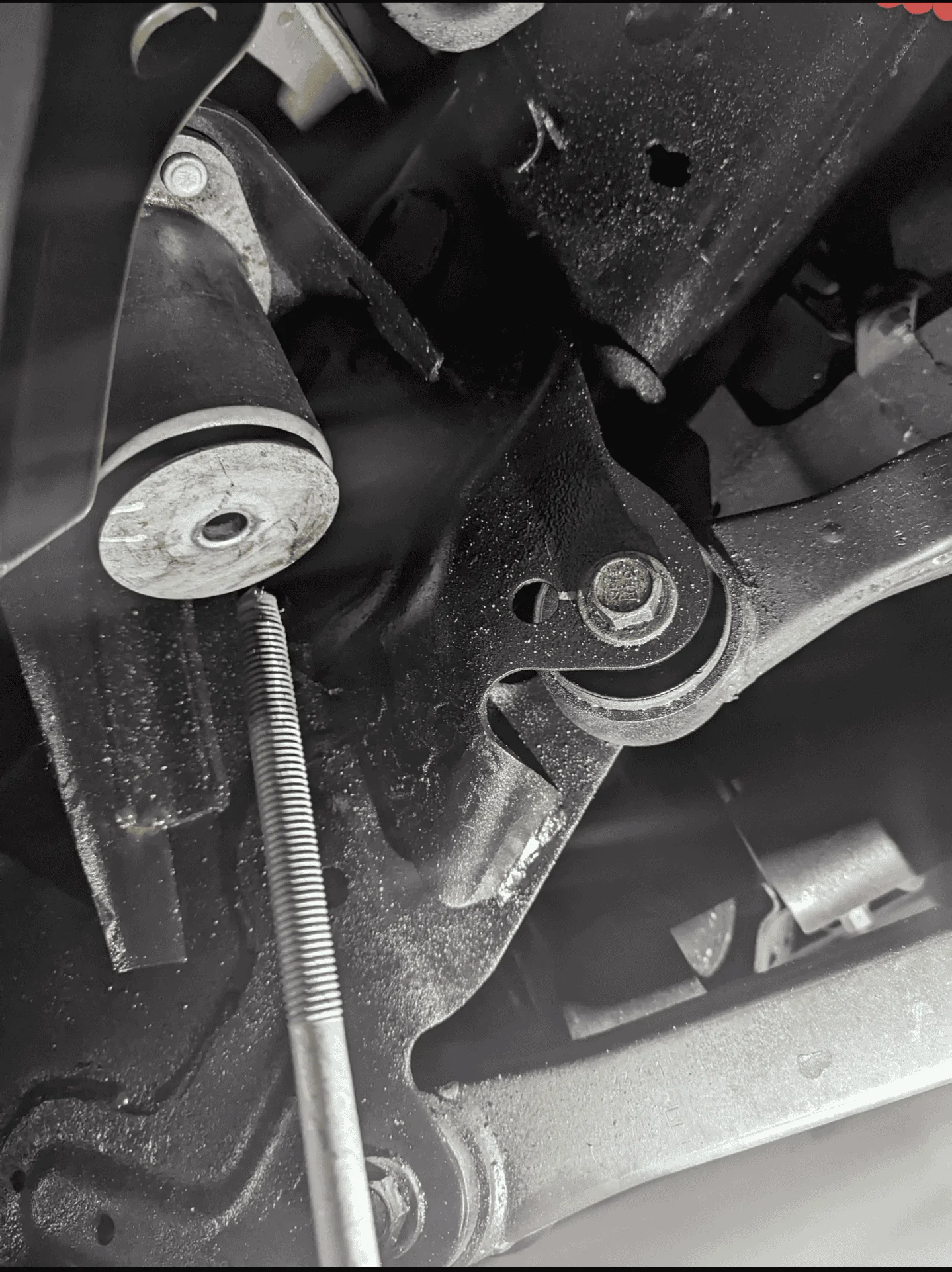

Well, I just joined the broken bolt club.
The Wrangler went fine - the left front was a pain in the butt but a propane torch and patience did the trick. Took a long time but the brackets when in and the steps all done before our trip.
Today I decided I'd put the brackets on my Gladiator. Trying to time things out so we could use it today and Saturday, then do the bulk of the work on Sunday and Monday as far as wiring and mounting the steps.
The right side went beautifully. I had all 3 brackets in place without a lot of trouble. The center mount was easy, the front not really bad, the rear was the worst, but still went ok.
Moved to left side - center was fine, bolt not really all that tough. Went to the left front...... took almost an hour with propane torch off and on, work it 1/50th of a turn, heat, another 1/50th of a turn, more heat, got it just far enough out to work the bracket in place.
Applied more heat with propane torch, started to tighten the bolt - SNAP. Really?????? Got it loose, bracket in, tried to tight it and it snapped.
Great.
I can see the bolt broken off up there - in the threads. Not a bit of it sticks down at all. In fact, I'd say it's broken up about 1/2 a thread or so, it's not even even with the bottom of the threads so there's nothing to heat, nothing to grab.
I so very rarely ever break bolts. It just doesn't happen, especially not on newer stuff. Last time was long ago on 40 year old rusty bolts (and I frankly didn't care as I could mill out the remains on my tiny cheap mill as the part was in my hand)
So now I'm screwed. It's broken off way up in there, too deep to heat, and likely a hard bolt.
To those who have broken body mount bolts - can it at least be DRIVEN until fixed??
Great.

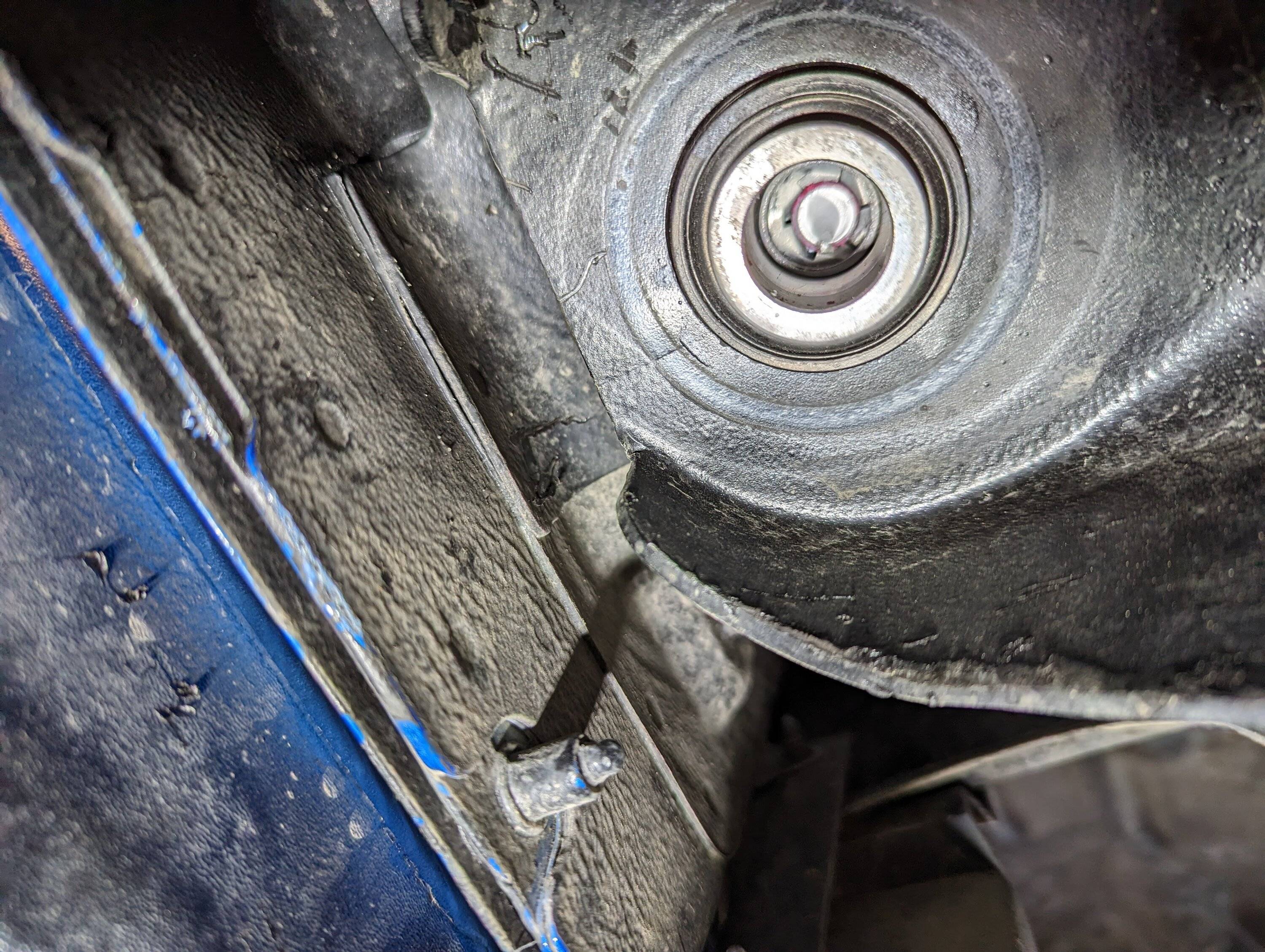

The front one is way up in there............. not going to be an easy task.
Thanks for the thought on driving it as it may be days or even a week before I can get to getting that bolt out. You can't see it unless you are 100% directly below it, which means using goggles, etc. and a long bit. (and praying you are centered)
Not sure how anyone could even heat it up in there. It's really recessed.
Yeah breaking the front ones scared me. No way to get the mount out of the way short of lifting the cab off.
I even had the steps mounted up missing the one rear bolt mount until the new bolts came in.
I plan on going ahead and mounting the steps, getting them all working when the temperatures are above 50 in the next week. Bit cold out there today - didn't warm up much and my shop is too full of stuff and cars to get it in where it's warm to work on it.
Using my finger as a measure, it's about 2" up in there.
Jeep Gladiator Rockslide Engineering Power Steps broken-mount-bolt
Give your favorite service advisor a call and see what they can do for you. I would expect they have some experience with this repair.

They will either drill in from the body or lift the cab depending on the dealer from what I read.
