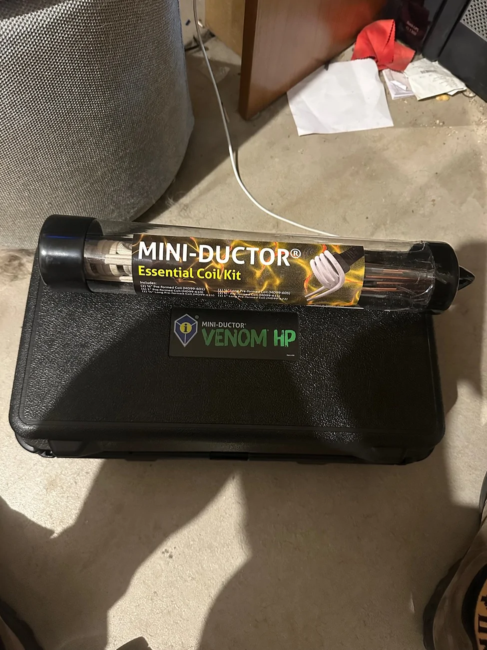

I just ordered the one linked below. I wanted the most wattage in a handheld. Same brand. I also ordered a pack of various coils. I know when I get it back I’m going to need to hit 6 body bolts on a 5 year old jeep. I’m not risking it. Even though this was expensive. And I’m pretty sure it will all but replace my propane torch.
https://a.co/d/0aiy1MJK
WILDHOBO
Sep 24, 2021
78
12,477
19,122
2021 Gladiator Rubicon
Network Engineer
Arrived just now. Let’s see if that alternator bolt comes out of the block on the Willys.

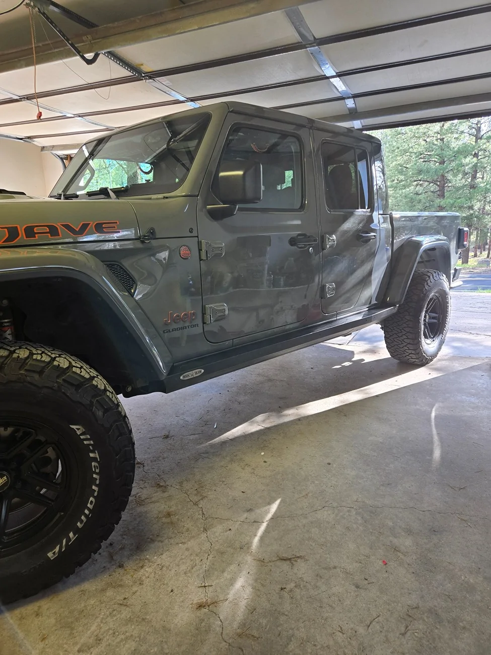

I finished the install yesterday. My body bolts came out fine, as I had just installed the Rockhard 4x4 rails about a year ago.
The rubber seal on the body is WAY easier to install after the rail is on. No measuring is required.
Everything else went pretty smooth.

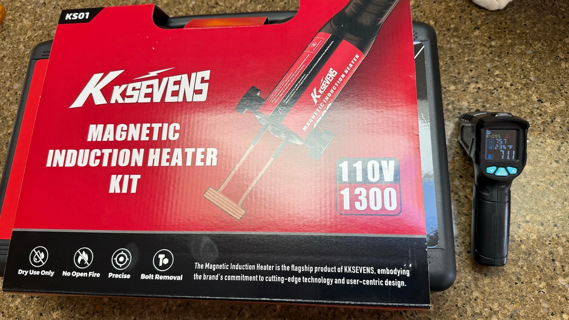

I'm at the step of putting on the Rock Slide Engineering Step Sliders on my 2025 Jeep Wrangler Rubicon and freaking out on seeing all the posts on broken body bolts. The repair for all of them seems like what nightmares are made of and something I don't want to even consider getting myself into. Local truck accessories shop wants to charge $800 to install just the sliders (not the wiring). Way too much!
So, I'm hoping a good induction heater would do the job right. I ordered a 1300w model that should arrive tomorrow. Best method of using it is 5 seconds on, wait 5 seconds, then repeat 3-4 times (to avoid melting rubber bushings)? Then slowly remove (reversing as needed). Would a torque wrench with 18mm torque socket work (set to about 50-60 ft lbs) or is it better to get an impact wrench?
Do you know if the locktite reforms after it cools? If so, would I need to heat up again to tighten down to 80 ft. lbs.?
Any advice you can give me would be appreciated! Thanks!!!!

Great advice guys! I appreciate all the details! It's not good when you don't see anyone using heat when installing the step sliders on YouTube...and then hearing about the bolts breaking in the comments.
I do have a thermo gun for outdoor pizza making that I'm going to use. I'll get them to about 300F and plan on using a 1/2" torque wrench to loosen them up to get the brackets on. Will also re-apply heat to get them back on. Will let you know how it goes!
Thank you!
