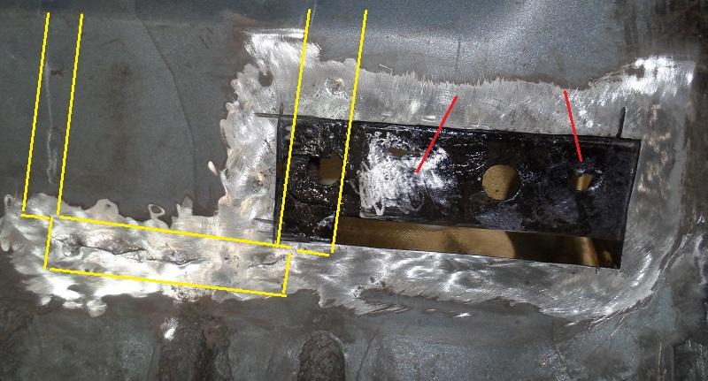

There are places that even Ziebart can't guarantee protection - where panels are welded together, say, floor panels. They overlap and are spot welded. If the protection should open for any reason, dust, dirt, sand, water, whatever, gets between the floor panels and the floors will rust at those joints - UPWARD, by the way.
Cars are made with many many boxed-in areas - good places for water and dirt to accumulate. If drains plug, wet dust and dirt sit in there. Where the parts are against each other but not sealed, you'll have rust.
A good job of rust protection gets into those areas - but lack of care, age, bumps, flexing and twisting can open joints up exposing unprotected areas.
In this example I repaired a while back on another car, it was rusted thin on the top layer where things overlapped. The rest of the floor solid. So I cut the rot out, removed as much rust as possible on the brace below, used RUST CONVERTER (NOT SEALER OR ENCAPSULATOR!) converted the rust, primed, painted, and welded a patch in place. (I then cleaned up the underside of the patch and treated and sealed it)
The brace is where the rear of the front seat attaches. No way Ziebart could get in there.
Jeep Gladiator Need Some Advice on Rust Protection floor-patch-right_3851
