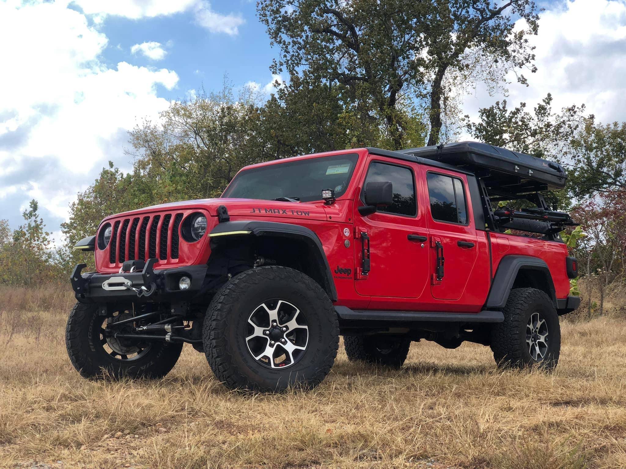

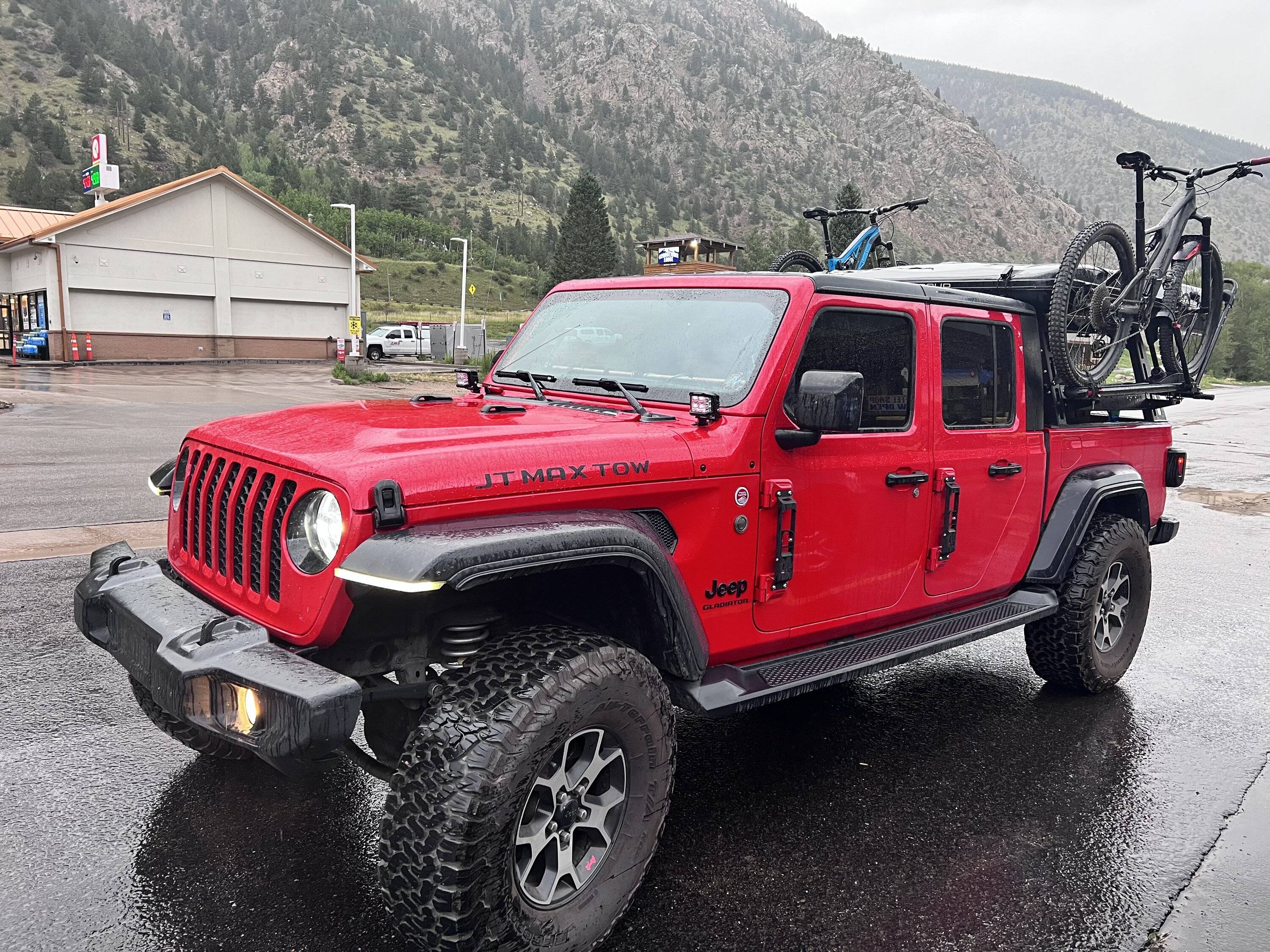

MY 2 PENNIES: CHANGE YOUR ENTIRE LIFT SYSTEM!

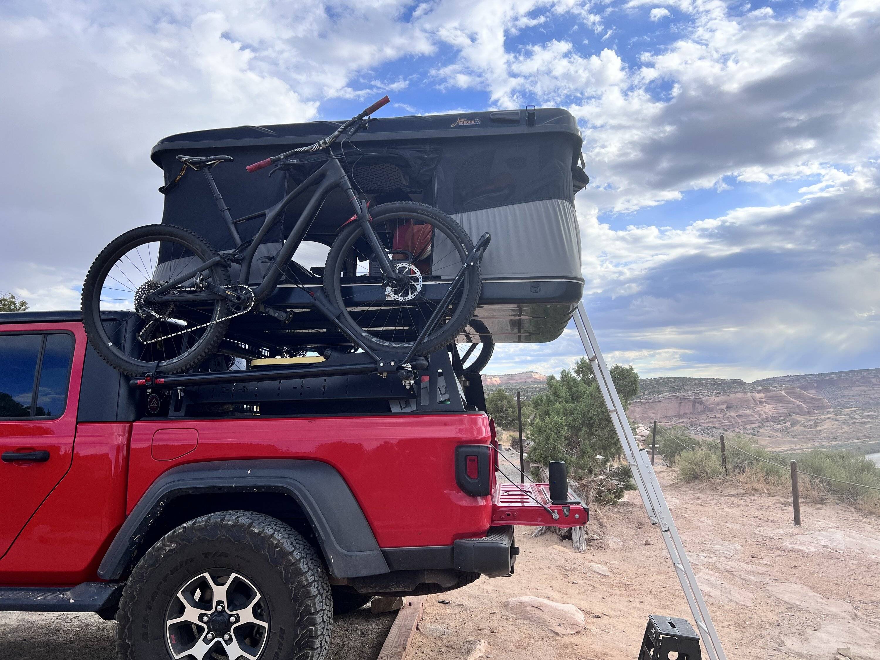

The problem I ran into was my Rubicon Express 3.0” lift and base shocks were not up to the task of towing and also hauling my overland set up. They sagged like yours and driving home from our out west trip was definitely difficult and my JT looked like it had been “bull dogged”.
I know people say to unload the overland gear from your JT when not using but I am very spontaneous. My wife and I could jump in our JT and head out camping this weekend… still waiting for that diesel heater I ordered!
I purchased a complete Tereflex overland kit with all new adj control arms, HD steering, adj Falcon Shocks and Adj Falcon steering stabilizer. Then had the Rubicon Express lift with 30,000 miles on it removed and added the complete Tereflex Overland 3.5” kit. I am so glad i did that!
I have the stock rake back again which I wanted and the lift is easily 1.5”es taller than the 3.0 Rubicon Express lift. The adjustability of the Tereflex falcons are fantastic! Very easy to do.The springs are much heavier duty and the HD steering kit that comes with the complete overland kit is perfect. Added HD Tereflex ball joints I’ve towed 6500 lbs with only minimal sag only down to level. No more bulldog! The JT drives and handles better than stock or than it did with the RE lift. Rubicon Express is not bad, I just wasn’t using that lift kit for what it was designed to do. I still love Rubicon Express lifts too.
I do have the BfG AT KO2 37’s so smaller diameter than other 37’s. They are on stock wrangler Rubicon wheels with 2” hub centric spacers all the way around (I’ve had those for 50,000 miles with zero issues! ) I often daily drive it but slowing down on that as it is at 92,000 miles. I just love driving my JT.
you can’t get individual springs for just the rear as far as I know. They have come out with HD springs now for front and back, I believe Tereflex had them first though. I am not going to air bag the JT now, I didn’t want to previously because of reliability issues with bags and off road travel. I am surprised how the stock 4:10 gears and brakes of the max tow handle the 37” BFG’s with no problem. I have plenty of power both stopping and going… really i am shocked how well it goes even in the high elevations out west in 104* heat and loaded to the max.
I have owned only diesel 1 tons before this JT for towing and hauling and I still own a 2013 Ford Mustang GT with a mildly built Coyote 5.0…. So I know what torque and speed feel like. No the JT isn’t that strong speed and torque wise but it does the towing and hauling very well in all conditions. With rack, tool box with camping gear and the RTT on it all the time, it does fine as a DD and can easily cruise at 75-80 (250 lbs of James Barroud). I don’t see 8th gear much with the auto but I do see 7th gear all the time. MPG is right at 15-17.
okay, my point: if you love your JT like I do, just replace your current lift. I recommend the Tereflex lift with the falcon adj shocks and steering stabilizer, the HD steering kit and the HD ball joints. I seriously think with your gear change you will be good and love your JT for a long time.
