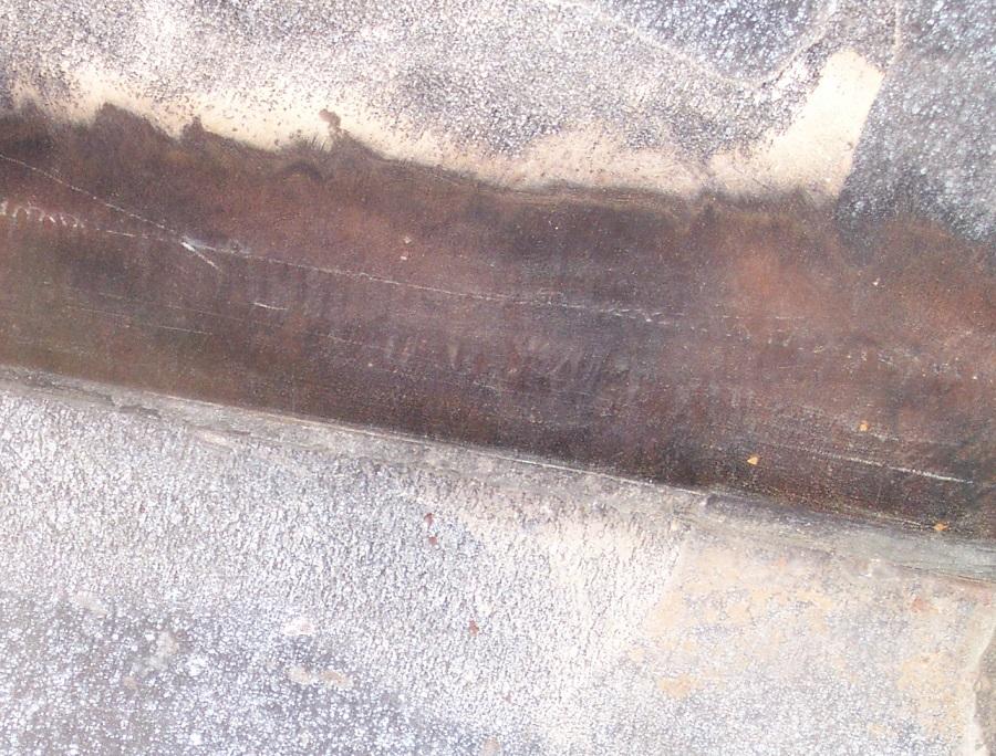

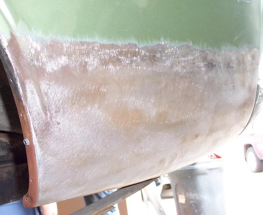

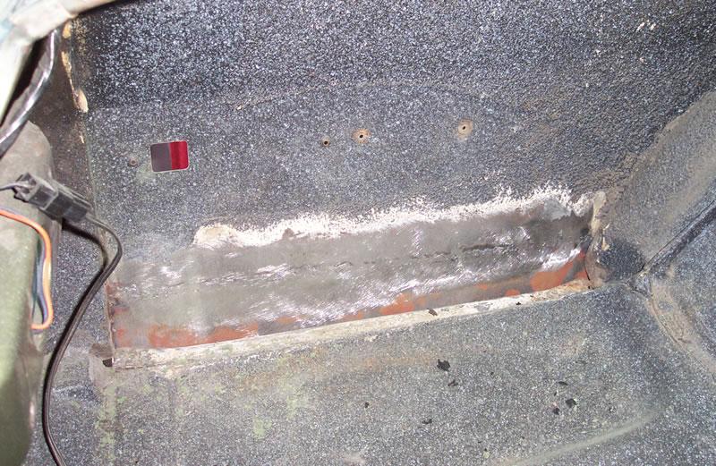

I need to post pictures of the job a fellow did on quarter panel patch panels on my 70 when I had it. You can buy exact fitting panels to patch the lower quarter panels on Javelin and AMX. Mine were just starting to bubble a bit behind the wheels. I bought the patch panels. They held them up to the car and marked a line to cut - a bit below the top of the patch panel. Once the piece was removed from the car, they held the panel up again and made another line - exactly even with the top of the panel. No gap, no overlap. They used a die cutter to trim a perfect straight line o the quarter panel so when the patch was held in place it was a perfect fit edge to edge.
Then he had pieces that held the patch in place. He did this for both sides at once.
He'd tack a spot, then move a few inches and tack another spot and so on occasionally moving to the other side.
Once he had a tack every inch on both sides he'd tack in the middle between those until finally he was just filling the tiny gaps where there was no tack. When he was done he used a small grinder and smoothed down the welds. It was so perfect it was smoothed over with "Icing" on the outside and high build primer. No bondo, no real filler.

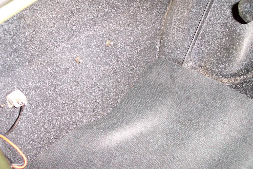

On the inside it was so perfect. I sanded, primed and used a special order paint to touch up the inside of the trunk. I didn't use any filler of any sort on the inside. No one could tell there had been any patching his work with that welder was so perfect and precise.

Jeep Gladiator Advice for welding needed weld-inside-trunk
Jeep Gladiator Advice for welding needed jav-all-apart-005
Same area after I primed and then touched up the trunk paint (NOT RATTLE CAN)
Jeep Gladiator Advice for welding needed hood-trunk-004
Patch in place -
Jeep Gladiator Advice for welding needed patch-panel-weld
