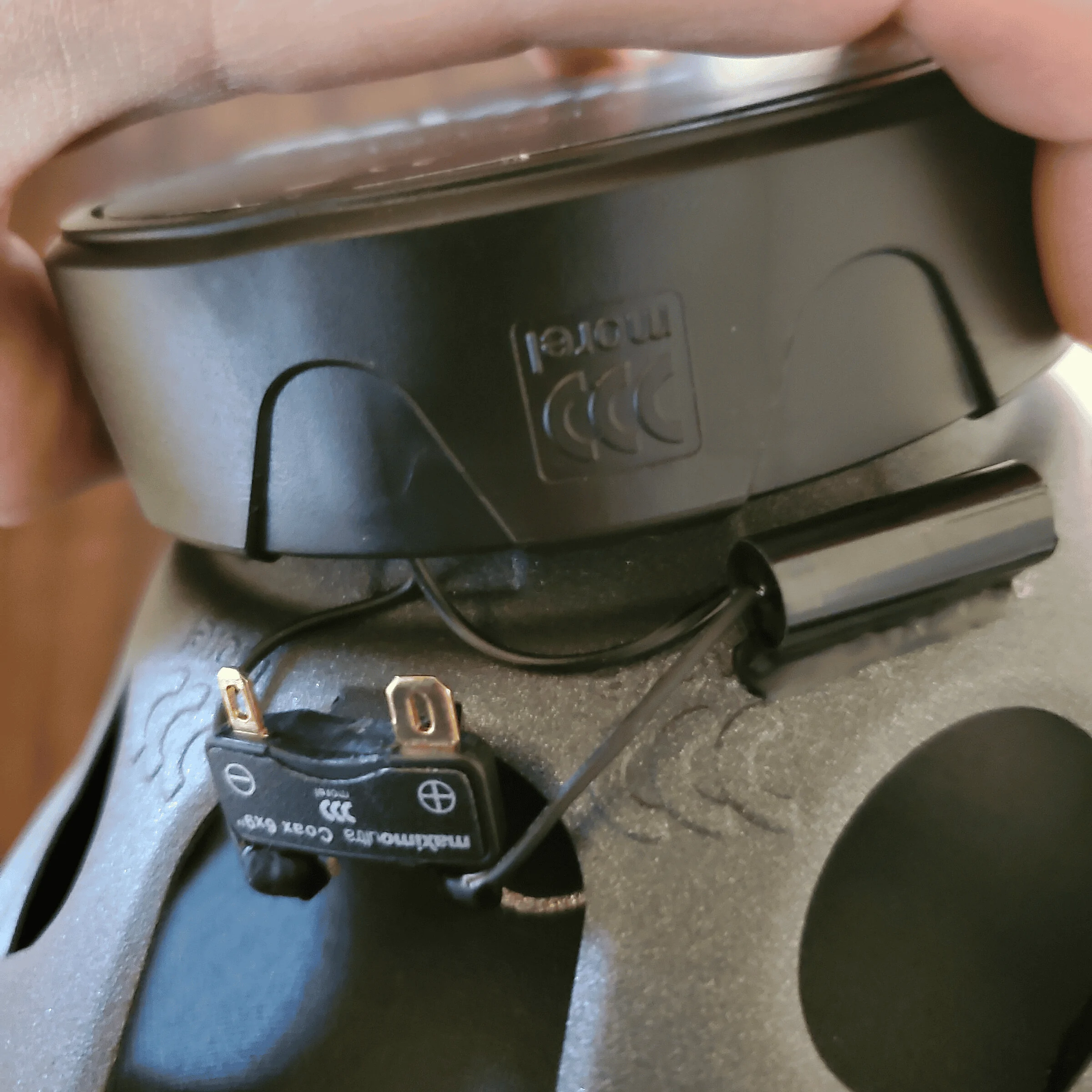

Ok, so I purchased the MB quart 6x9 adapters and a pair of Morel Maximo Ultra 6x9s. I have the 8.4 with the premium base system in my Gladiator. I have read through everything on this forum and the JL forums to figure out the best way to wire them up. I contacted MB and Crutchfield. Through all this, I'm still getting different answers on what to do.
*Do I cut the tweeter wires and wire them directly to the 3.5 plug?
*The speaker has a capacitor wired to the tweeter wire, do I delete it?
*I read to just use the 3.5 plug and not the 4 inch plug?
Any help from those who have done this conversion with the premium sound package would be greatly appreciated.

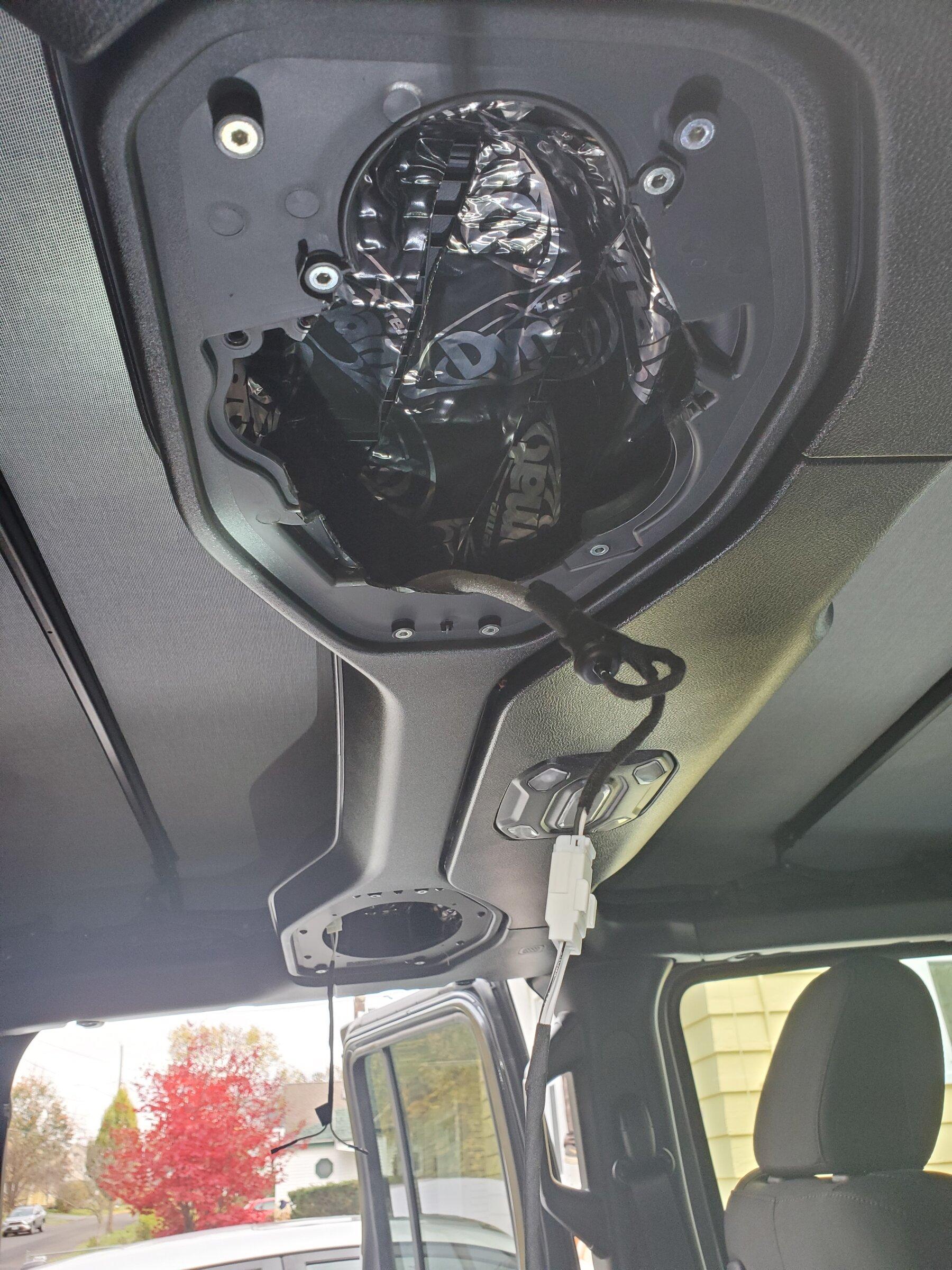

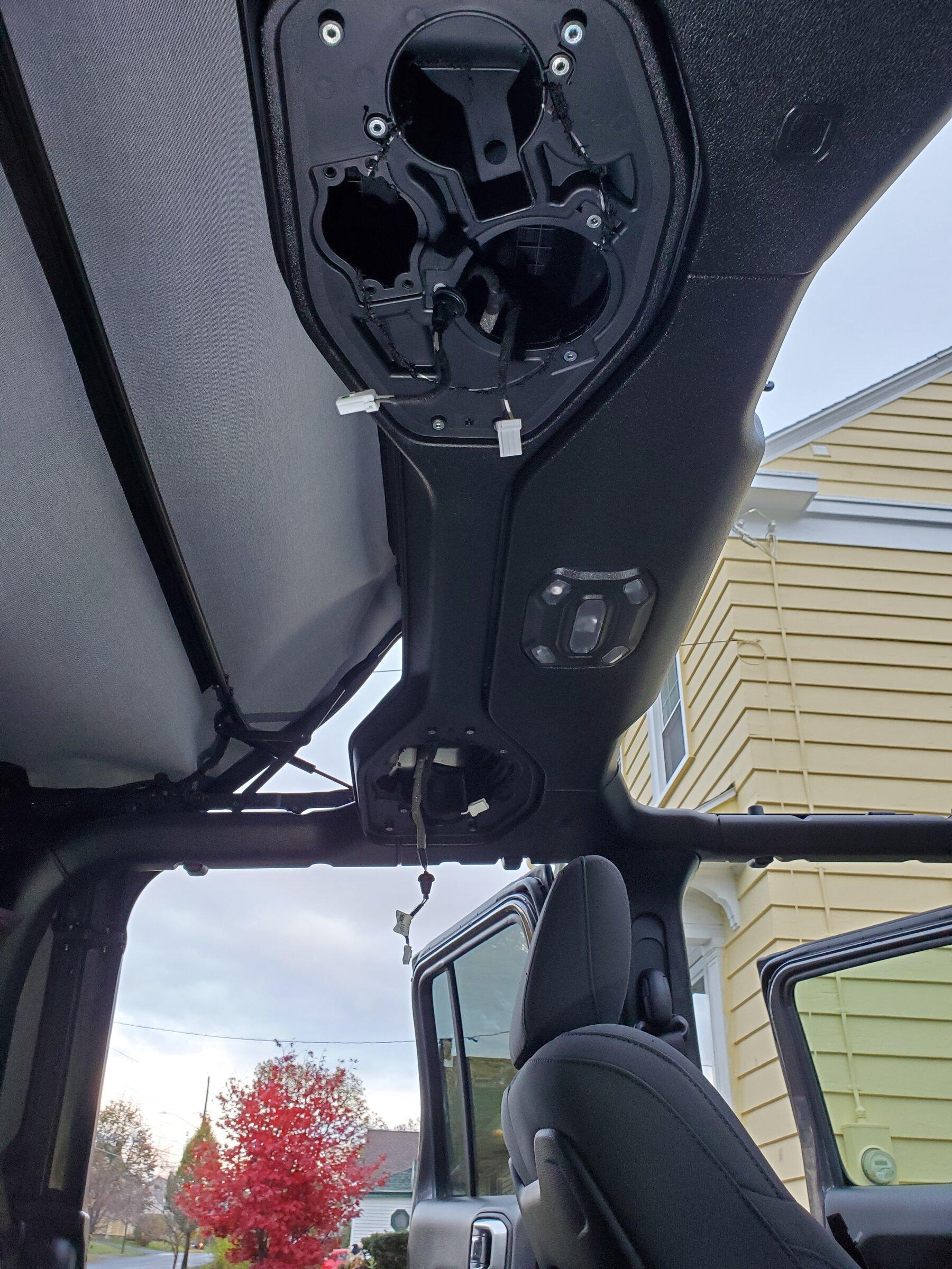

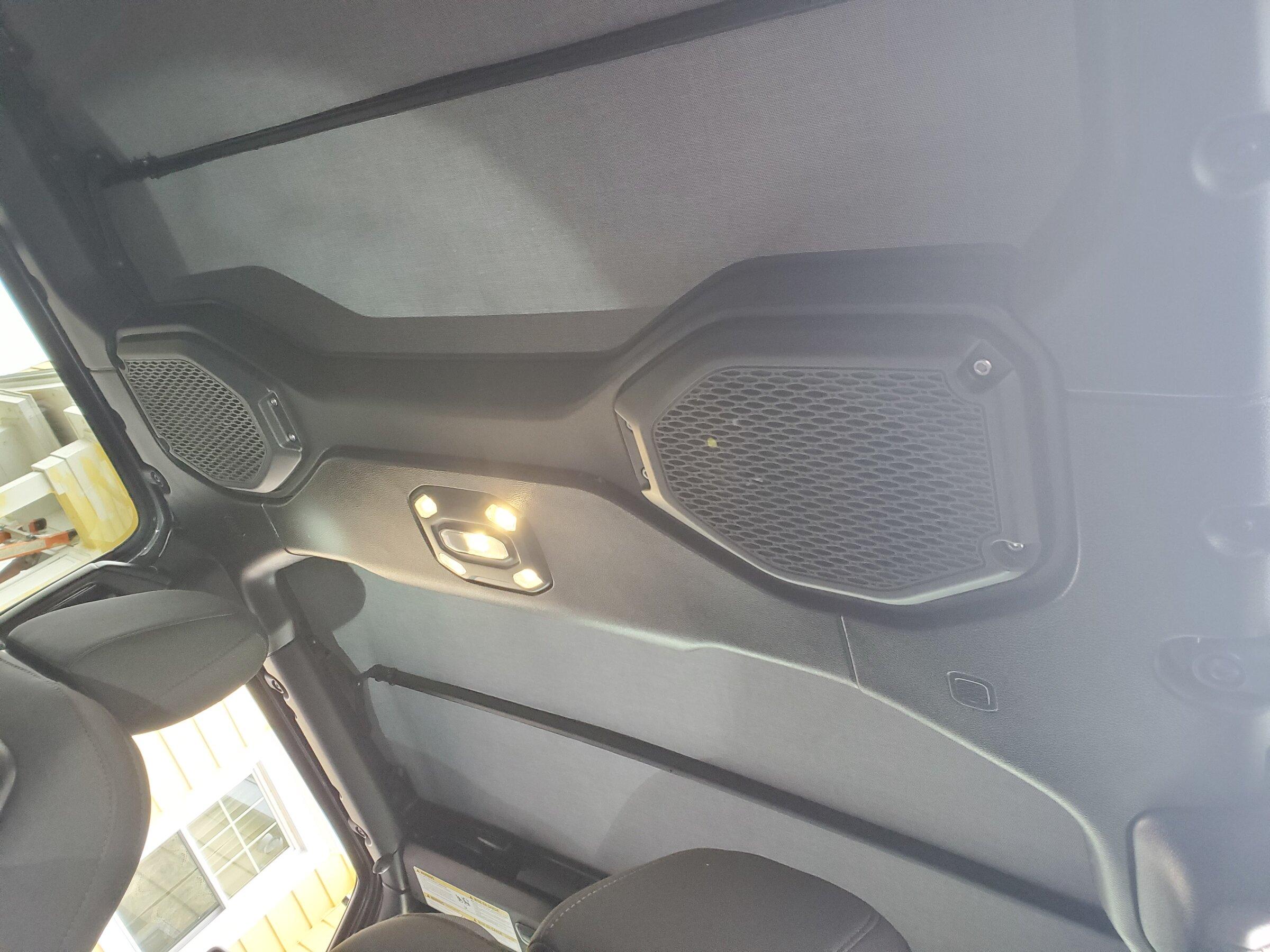

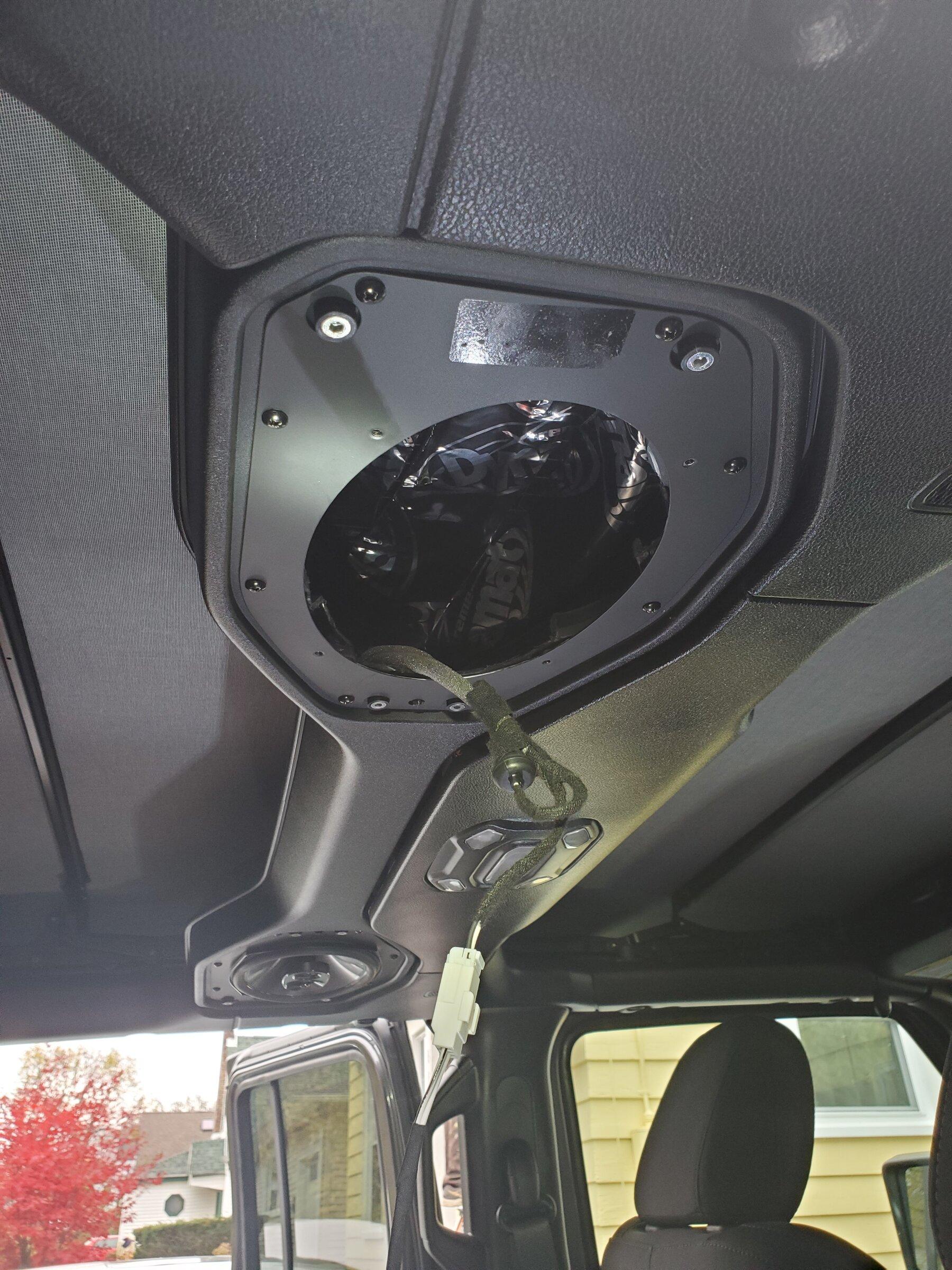

6x9 fit, you just need to cut up the opening using the adapter plate as a guide.

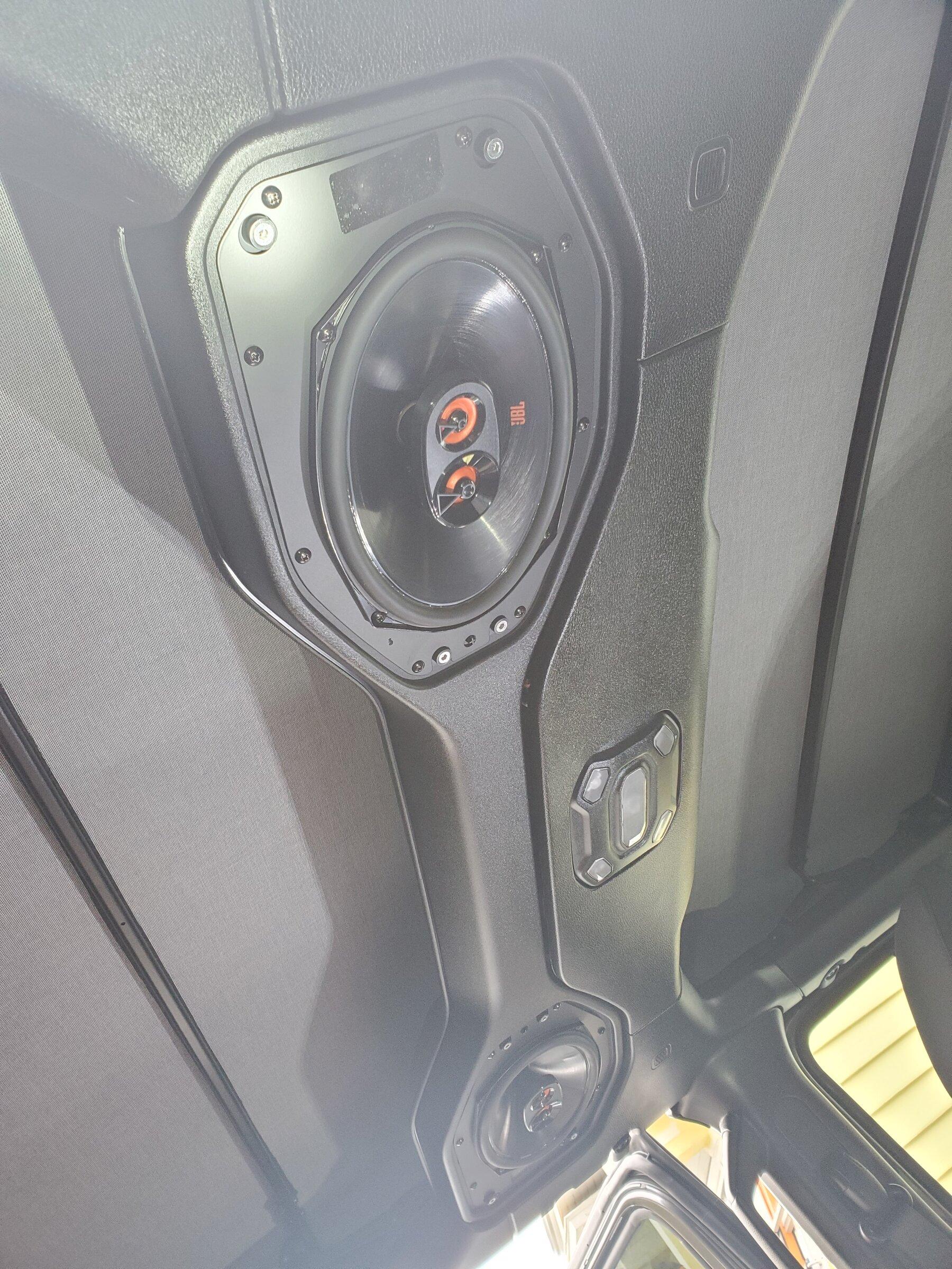

I recently did this upgrade using the MB adapter as well amd a pair of JBL 6x9.
I do not have the upgraded alpine system though, so wiring may be different than what I did.

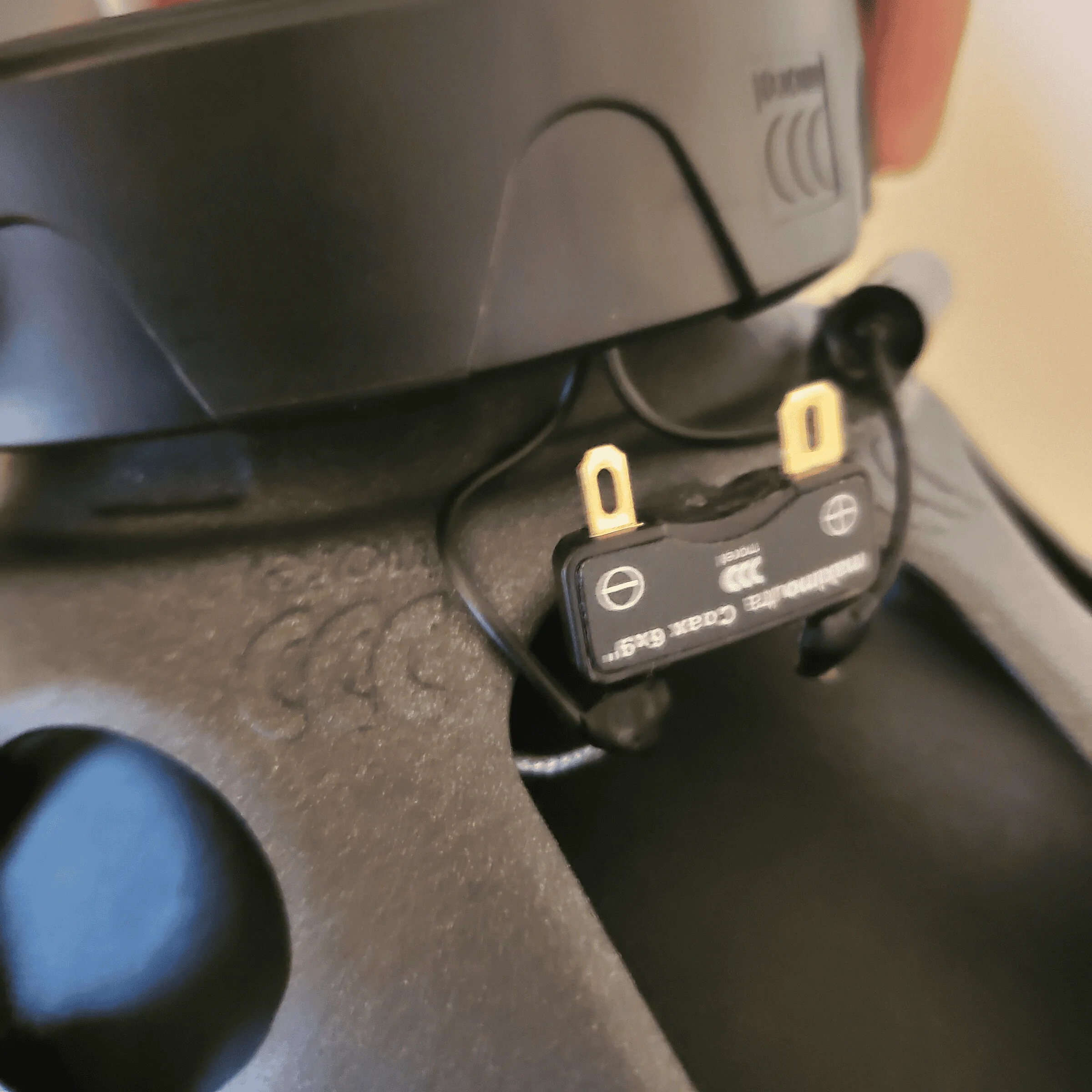

I used the pigtails that come with the MB kit and connected them to the 4" woofer connector in the soundbar, not the smaller tweeter connector. The tweeter connector I just taped up so it wouldn't rattle around.

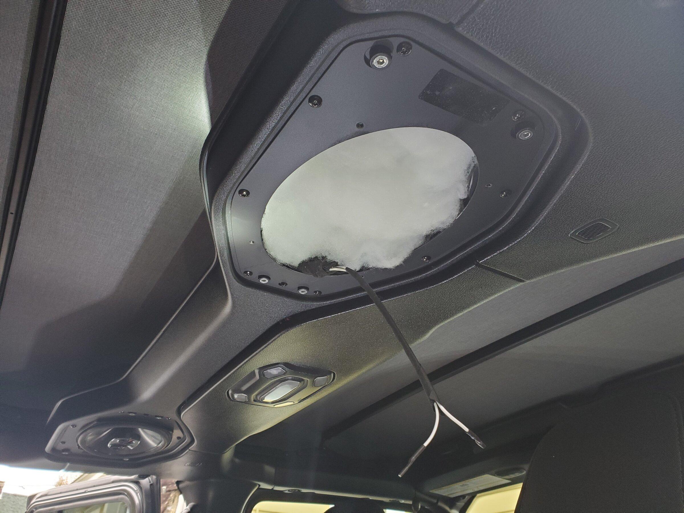

I did stuff the bar with poly fill and used dynamat as well.
I would leave the filter in as you should be getting the full range input and you would damage the tweeter without the high pass filter.
I did everything with the sound bar in the truck, but from what I have seen it would probably be easier to remove the bar and do it on a bench.
Hope this helps. I don't know if there is any wiring differences between the alpine and non alpine systems. I know the speakers are the same, the alpine just gets a sub I think.
