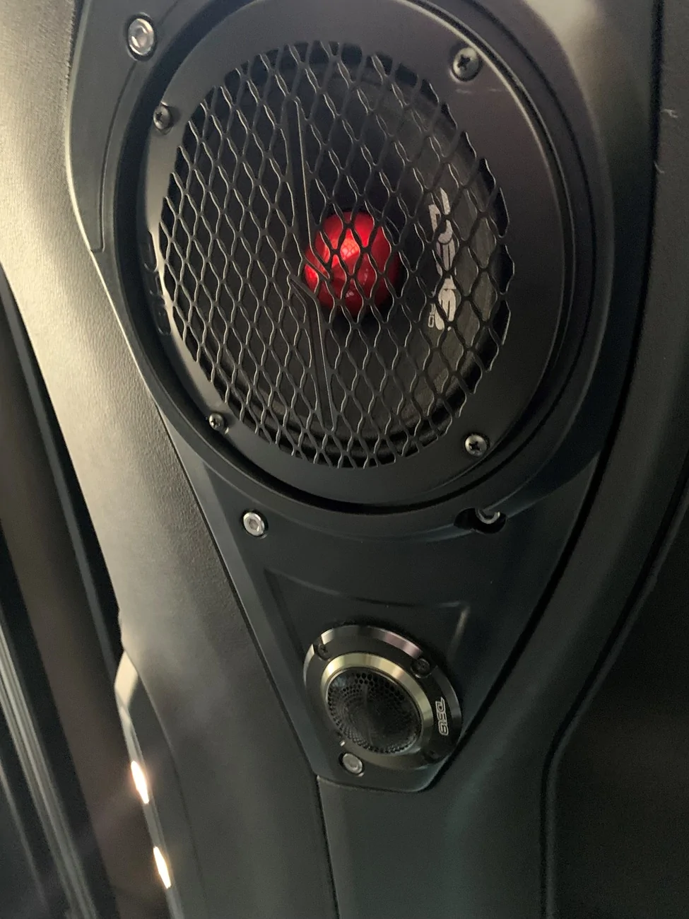

I did the MB Quart 6X9 kit in my 25 Rubi and the radio can drive those, but the speakers are terrible. Had to add tweeters to get decent sound (drilled out the light holes by the speakers) Since I traded to the Joose, I went with the 6.5 upgrade with DS18 pros...... Night and day difference from the MB Quarts. I also added DS18 tweeters to the fold as well. The Alpine can push em, but dont look for ground shaking results.

I had my 6X9s (and currently the 6.5s) wired to the 4" speaker harness... I also added tweeters
wired to the 3.5" speaker harness. Adding the tweeters made a big difference in sound quality. The MB Quart 6X9s that come with the kit are mid level at best. I think if you were to swap a quality pair of 6X9s on to the adapters, it would probably enhance your listening experience.
