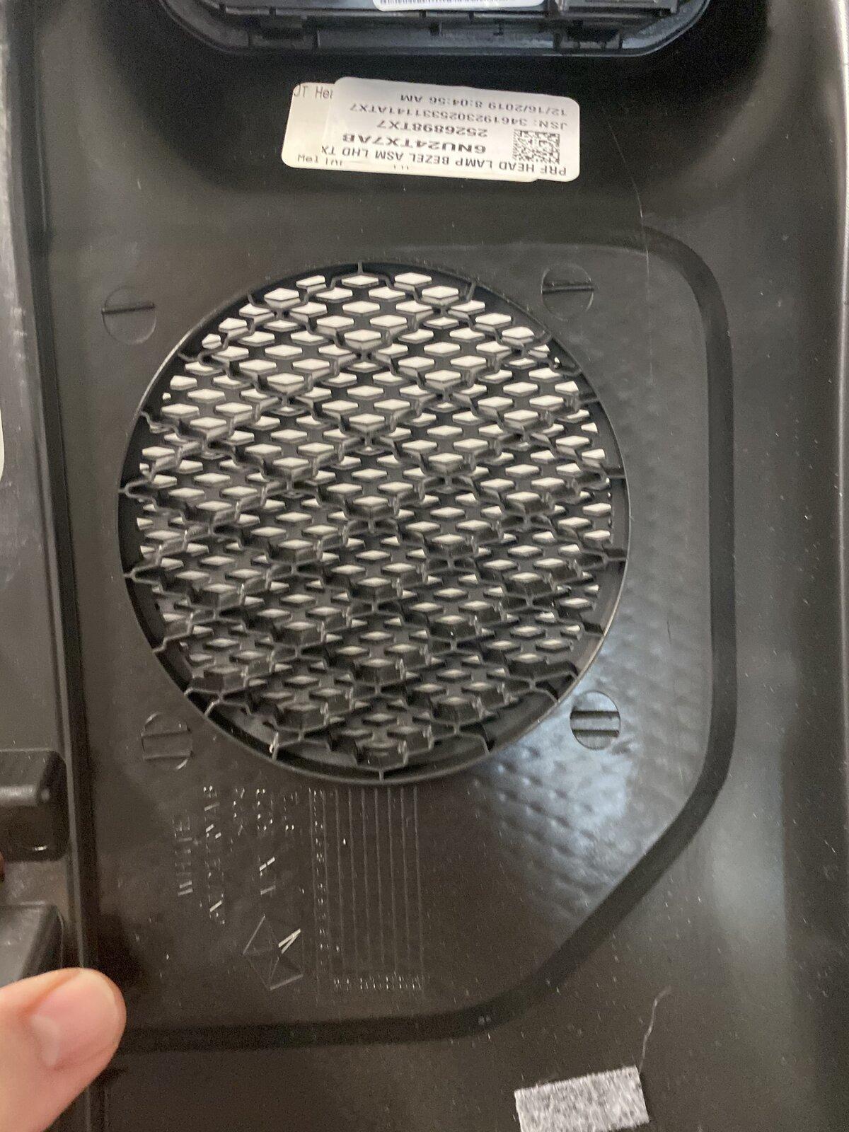

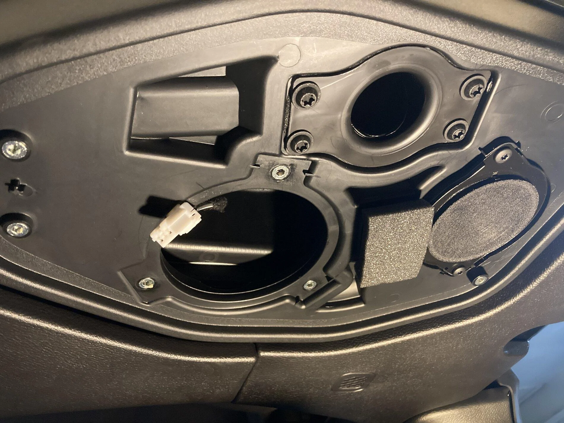

So you guys who upgraded your kick panels to 6 inch with the metra pods. What did you do with the oem trim panel? The perforated area is only as big as the stock speaker. I would think the panel would block sound. I am in the middle of this project now and just realized the perforated area is only 4 inches wide

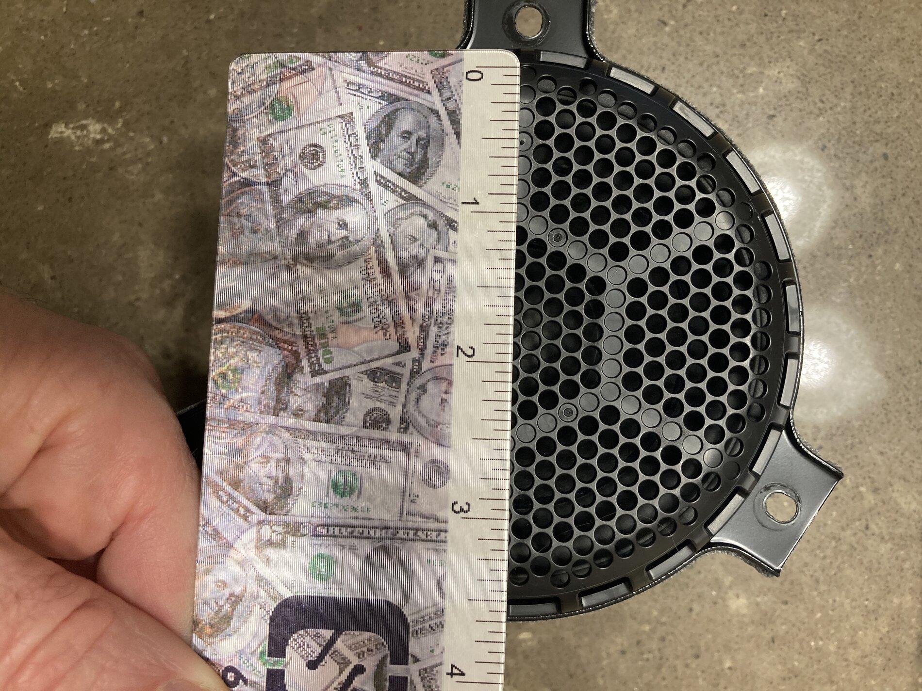

FYI- Looks like my base radio has smaller than the 6.5ā€ speakers listed above, therefore no Mopar kicker replacement speakers for me
