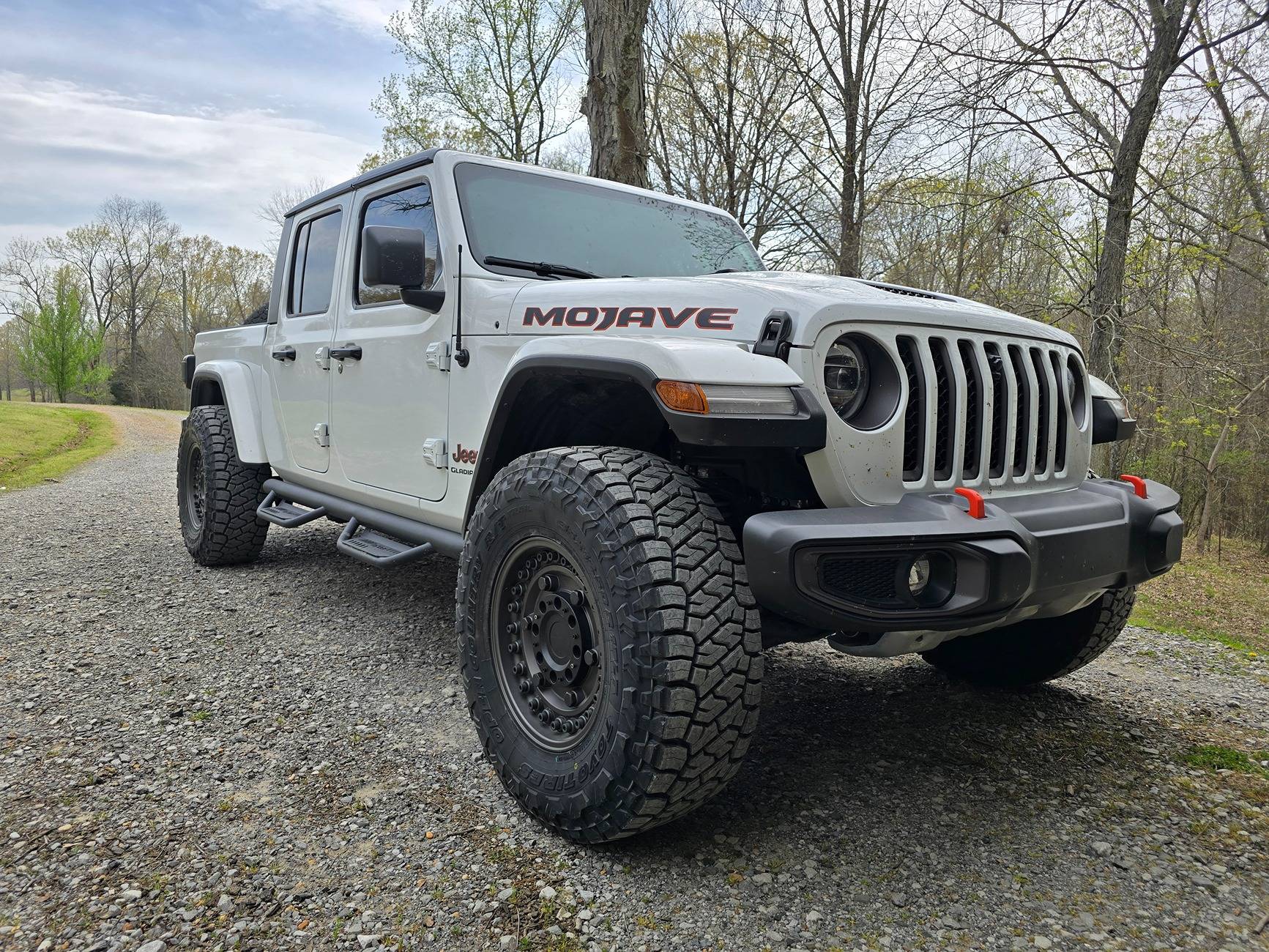

Got some new chicken diggers installed today. I had a bit of fun having to call the dealer for my born on date, 6/2/21 btw, in order to get the correct tpms sensors. The change happens after 6/7/21 in case anyone didn't already know that
Also, pro tip, buy the extension cable when you go with the JScan mobile app rout to adjust tire size/speedo. You don't want to have to go in there and unplug that harness over once lol, ask me how I know. It worked great btw. Highly recommend it with the bypass pigtail and Bluetooth OBD reader.
