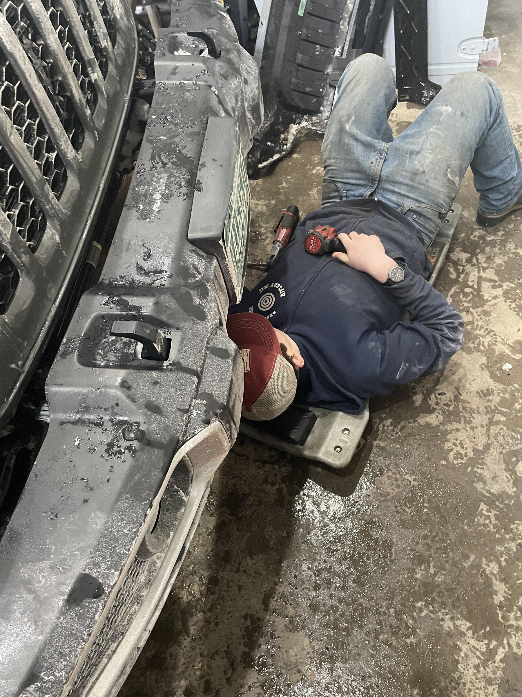

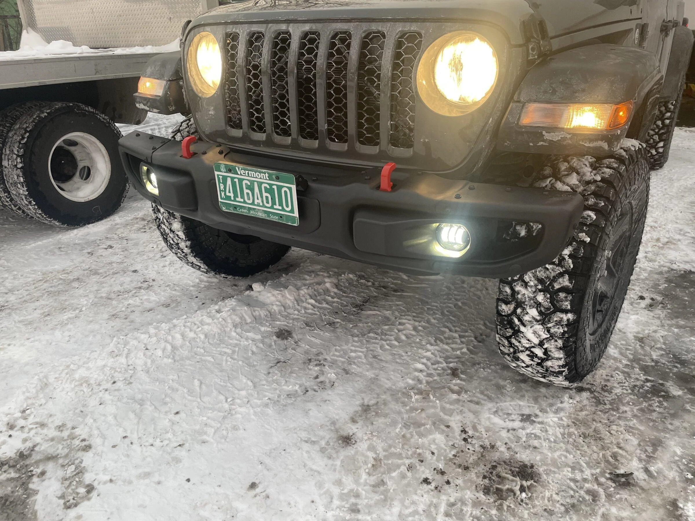

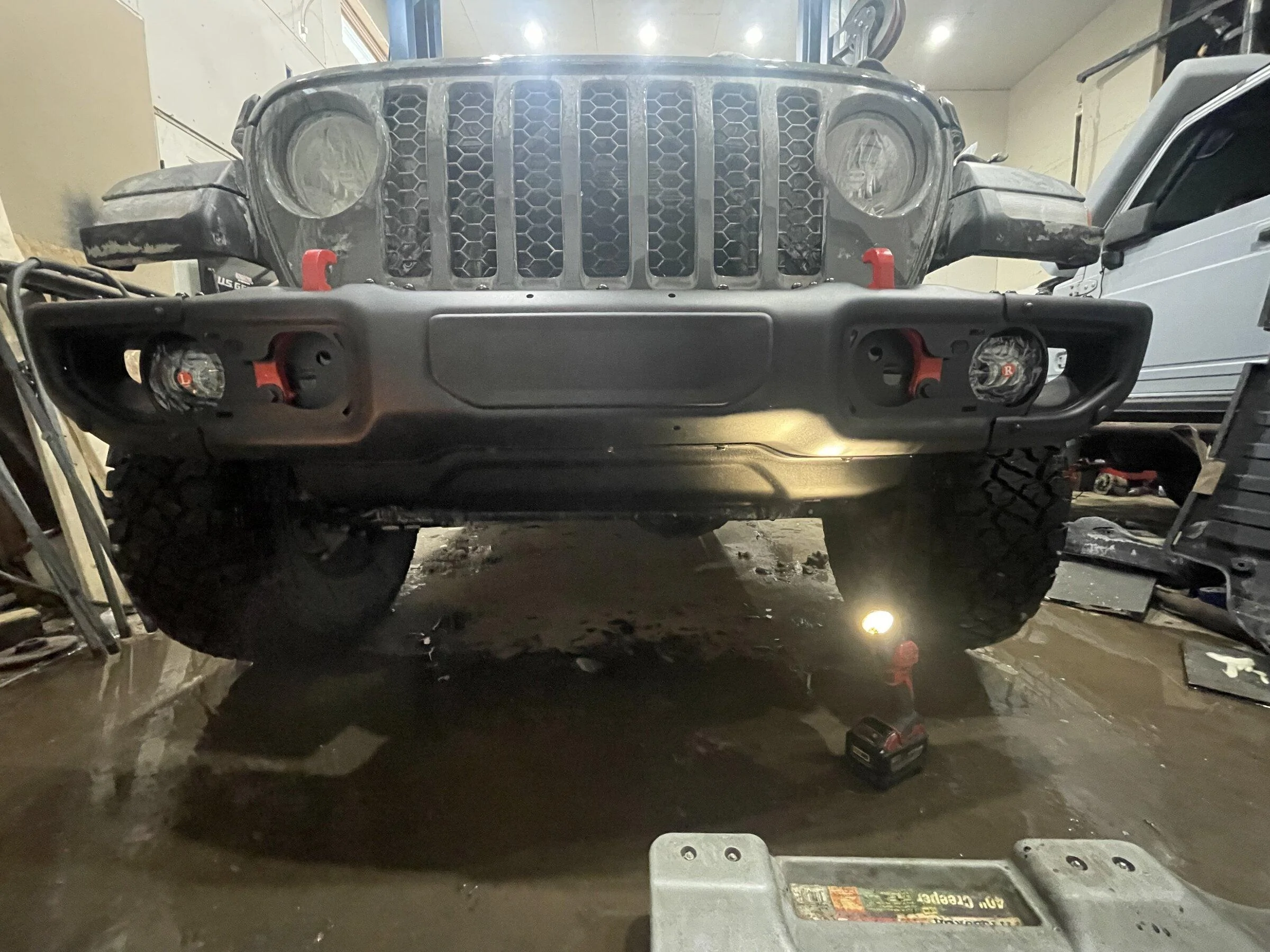

Got my bumper and skidplate on without too much trouble today.
First issue was the aftermarket led fog light connector to the factory harness. The pins didnt line up exactly so i had to straighten the pins a little and finally got it.
The factory fog light harness I got didnt really line up with many of the holes to put the clips in. Maybe i messed it up (i have no idea how it is actually supposed to routed) but i think the harness for the steel bumper must be different. I could get a couple to work in the holes under the bumper mount bolts close to the fogs. But functionally it was fine and the leds that came with the bumper are bright.
Skid plate was a non issue. I had the rivnuts in the kit they were easy to install. Only thing I didnt have were nuts for the bolts to hold the skid to the bumper. I went and bought a few 8mm flange nuts.
The amazon bumper had no instructions and a ton of extra stuff and bags of bolts. I didn’t use the winch plate or the grill guard. It also had fog light rings for usibg stock lights i think. I was surprised it had a flip up plate mount as well. Using that for now.
But all and all pretty easy to install. I bought new bumper cover things so I didnt have the pdc holes. I got an original mopar and a crown i think. The crown was much built than the stock one.

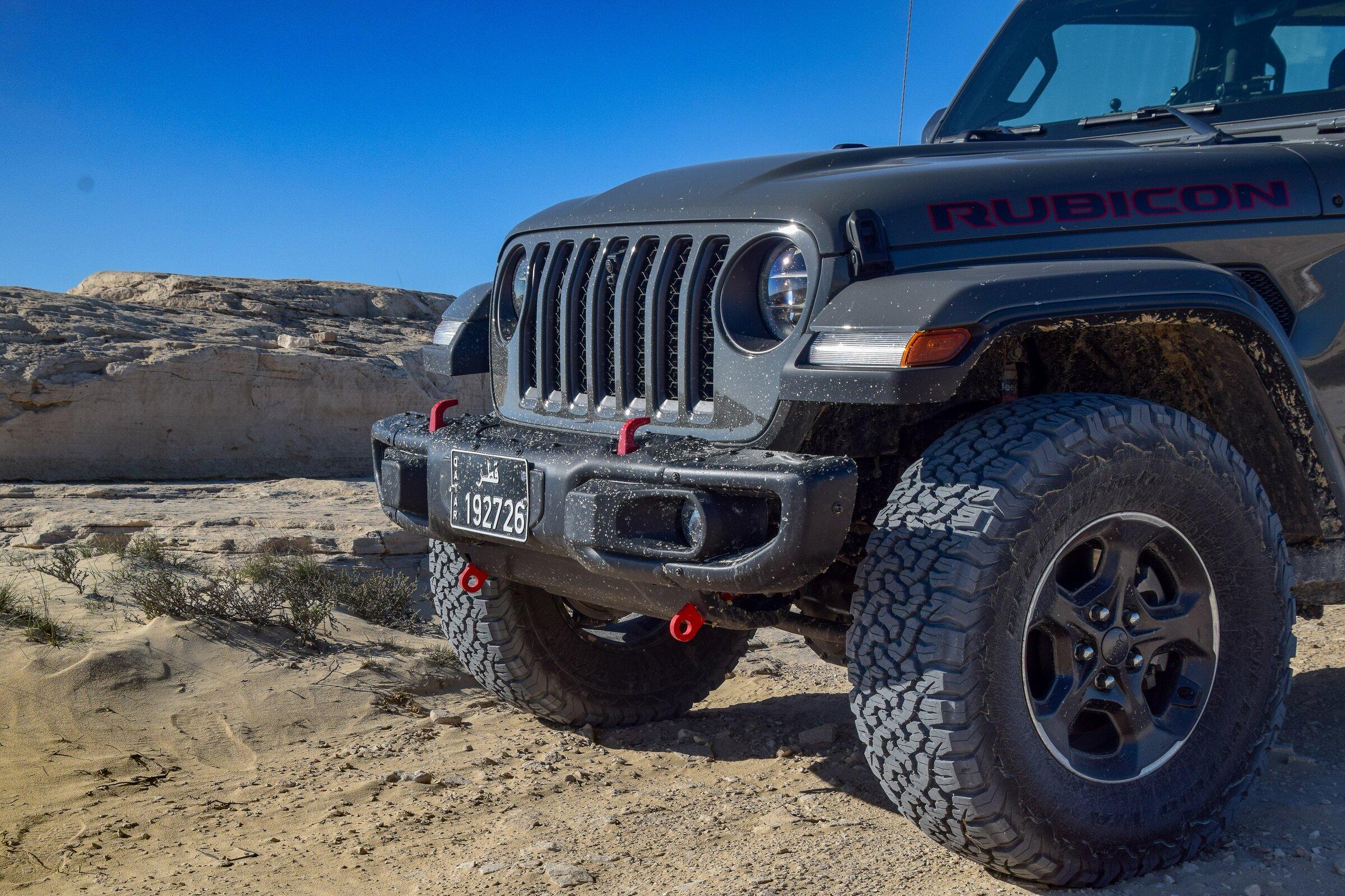

I have one of the knock offs. Where the removable end cap is secured has started to corrode along the seam. no biggy, some rust treatment will fix. other than that holding up ok.
