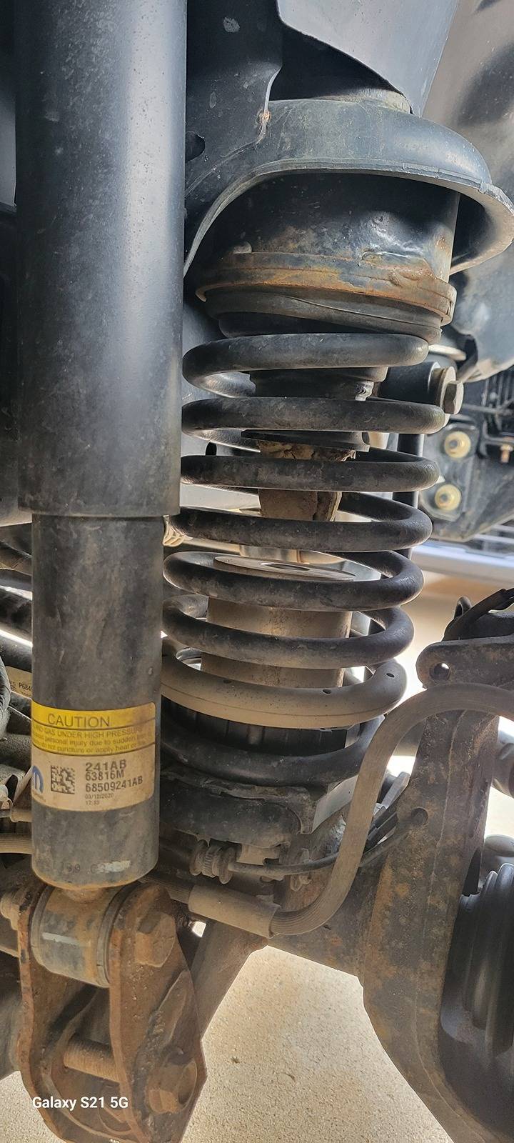

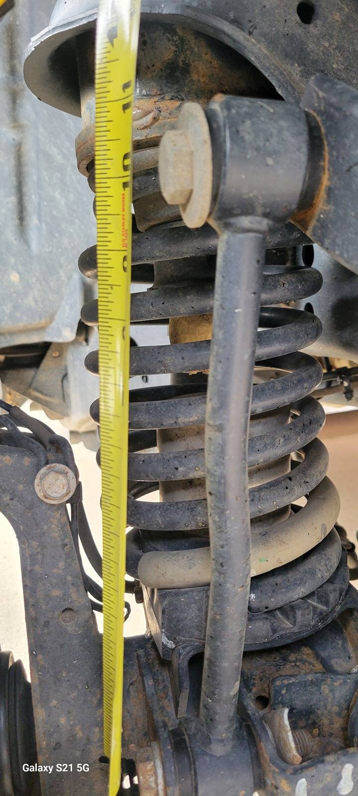

Haha I won't be havin no shop reseat nothing haha, I have plenty of tools. If I have a proper isolator positioning the coil better there will be a big difference in height and distance between the bumpstop and spacer you mean? @Freems
The coil is positioned all the way to the correct position in the stock isolator. Spring looks to be seated correctly in the lower "insulator" anyway but from what I've read there is some from Rock Krawler brand parts or somthing that fix that issue. Although can't seem to find them anywhere locally (I'm in Canada). That seems to be the least of my issues at the moment though. The spring bow is known and noticed when I took a look at things recently but not a big issue compared to the rest. That bump stop looks awfully close to the spacer. I also need a drag link (thinking ill go with Apex) but that's not the question at hand.
Being I have a 2.5" coil spacer on top and 2.5" bump stop (from my best guess when using my Stanley fatmax tape measure), bought it the way it is I'm thinking there should be a hell of a lot more space than what I have. @ShadowsPapa pic shows a massive difference than what I have. So figured he might have a thought on the situation from his experience after reading this thread. BUT, I am open to any and all's thoughts...

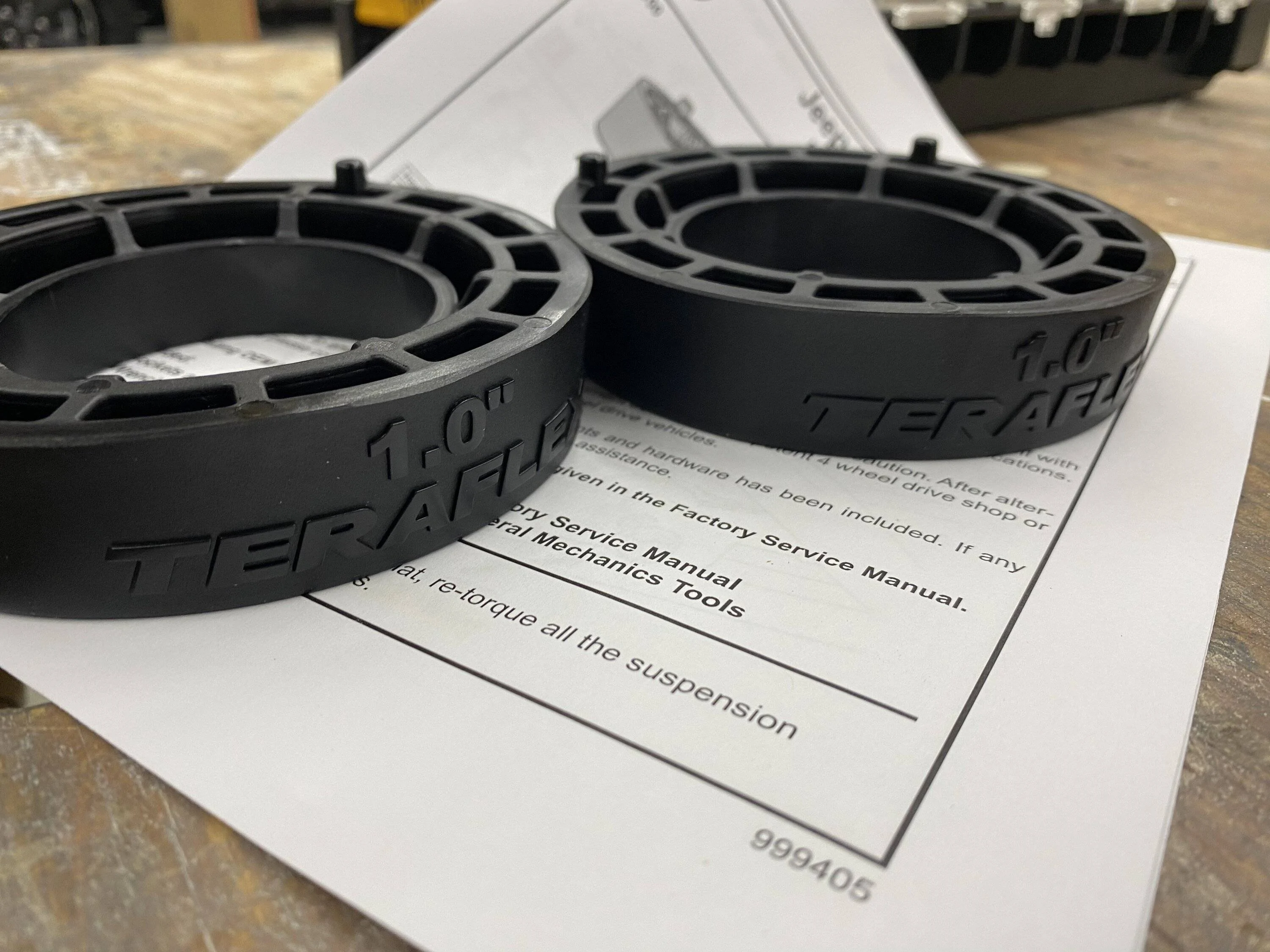

Just curious, does the truck with the new springs still just float through that intersection with your plow on now? You tow a Javelin if I’m remembering correctly with that Overland, how did that change towing with the new coils on and no plow on? I tow with my sport and used the Teraflex 1 1/2” spacers up front (added a 70lbs metal bumper and a 60lbs winch). I went with the spacers because I wanted the rake for towing.
Wow, you don’t have hardly any space left for travel, someone put way too many stops in there…PapaShadow is the man, he’ll get you straight.

Yup, that's what I was sayin. There's only 1 stop spacer. Like I said in the posts above, a 2.5" coil spacer and a 2.5" bump stop spacer. At least that's what the tape measure says. Hoping for some insight and yeah since I joined and been reading on the forum so fsr Shadowpapa might be the guy ti help clarify my situation for sure

i did 3/4 spacer from daystar all the way around and ran two 5 gal NATO jerry cans in the bed. Got me to stock ride height and rake. I did lighten my winch up tho. I went to a ZXR12 aluminum body vs my old steel winch.

Easiest way to think about this...if you lost height due to adding weight, how did you lose it? That's right, the spring compressed. Adding a spacer won't give you that travel you just lost back. It'll give you the height back, but the spring will stay just as compressed as it was before the spacer.
Now, 1" is not a huge deal and most people will be happy with the spacer, but if you're looking for the "best" way, it's with a new spring.
Your bump stops and shocks will still be limiting the travel not the spring? Even with a 2" spacer you won't get into coil bind at full bump. Your spacer didn't change the amount of travel. Technically it would increase potential downtravel before you had a coil drop out but you'd have to be running a very long shock for that to be a concern. The spacer will in fact gain back the usable uptravel from ride height to bump stop if that's what you were referring to.
