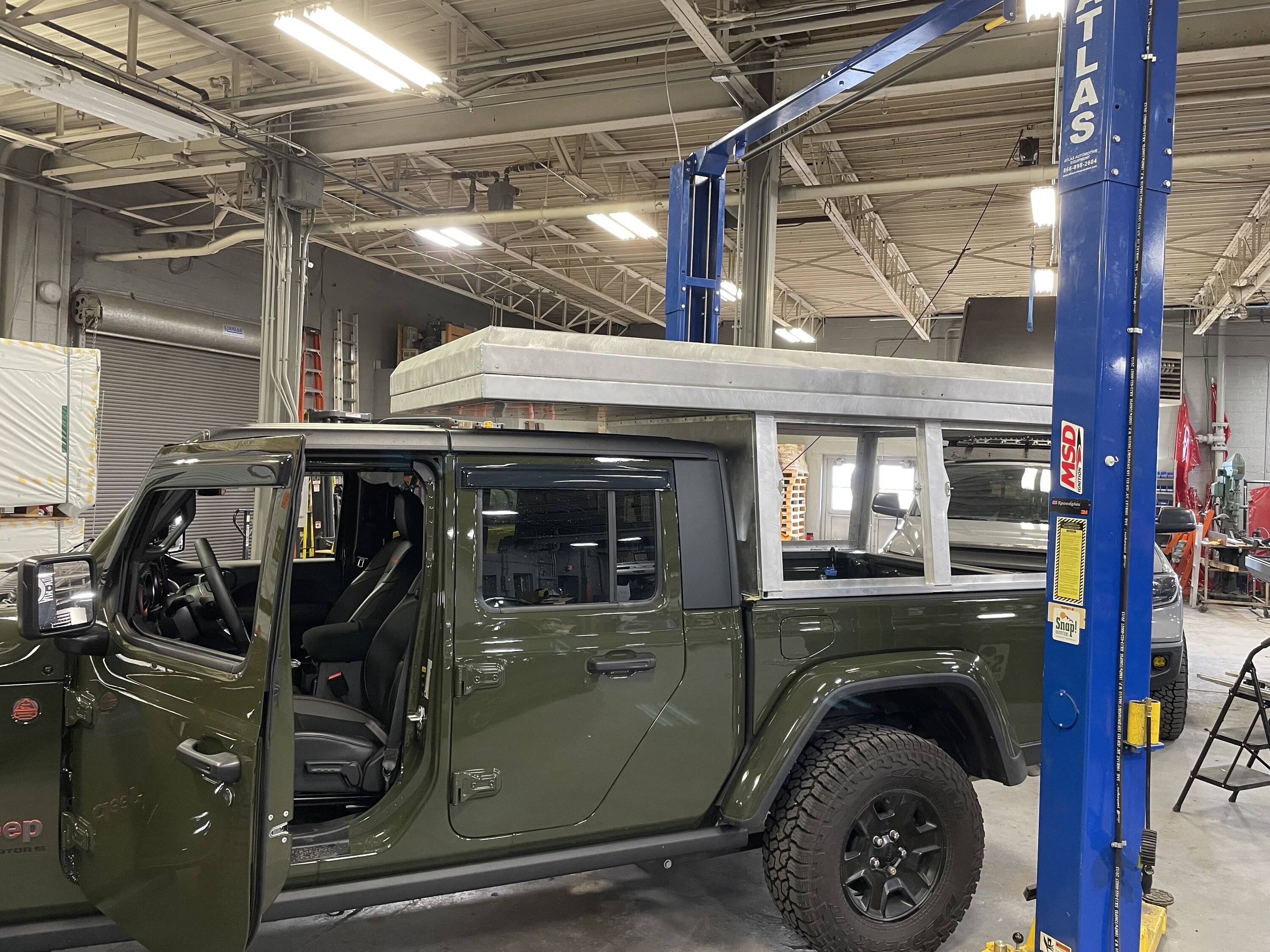

Anyway, I digress... I'll be curious to see what "adjustments" I have to do to our stock Mojave when our Snap Treehouse is ready. This is a pic of the test fit last week before heading off to powder coat. Should have it in a few more weeks!
Jeep Gladiator New Gladiator overlander (to be) IMG_0942
