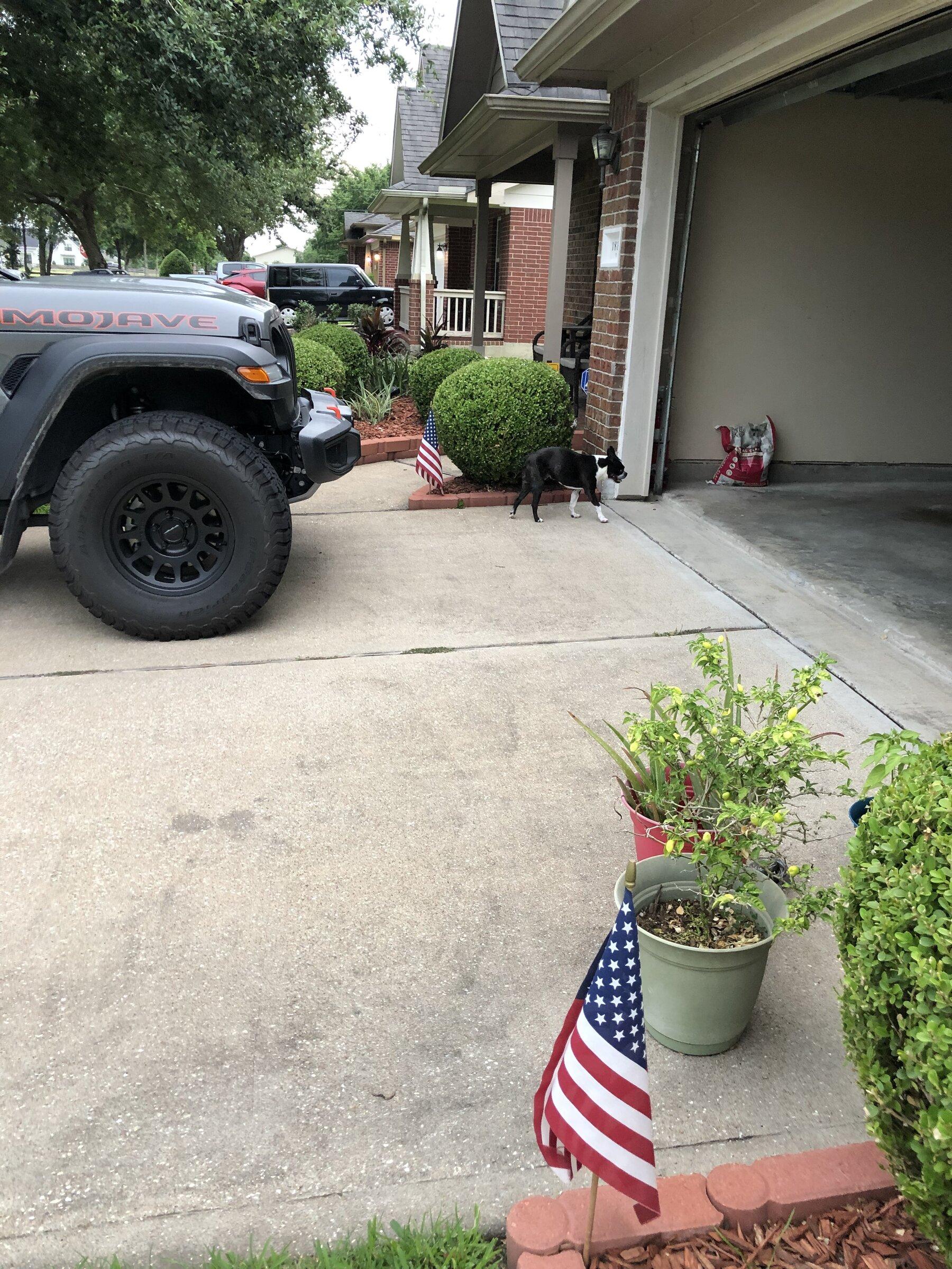

Got the 703’s
Jeep Gladiator New Method 705 Bead Grip Wheels 0AFA0125-ED9B-408B-AE37-ED2B7927823B
what offset did you get, I see they list 3 for this wheel. I have a Mojave as well and am in the market. I do want them to stick out a bit, but not too much.

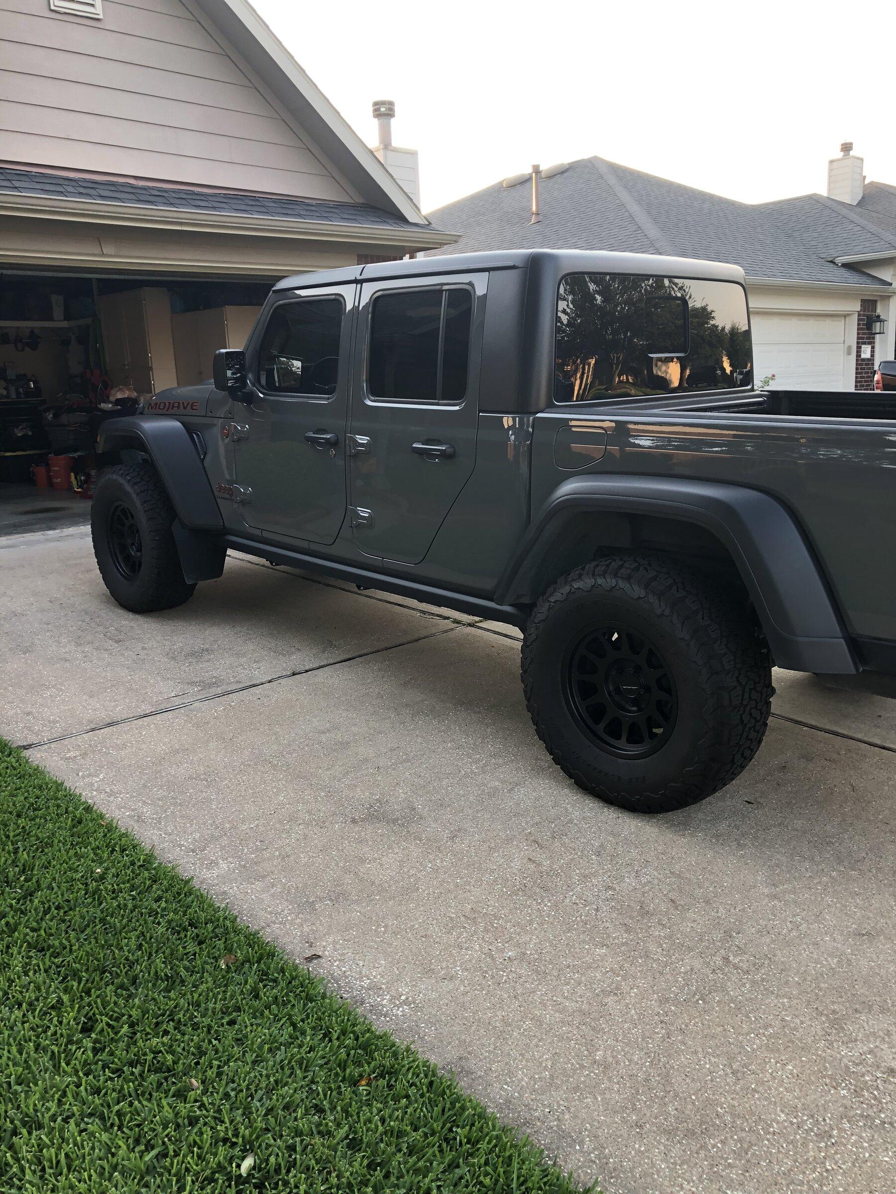

I also have the 703s. I would recommend black because if you 4wheel, you will scratch them up on rocks and boulders and the aluminum underneath is bright silver. The flat black (Satin) is easy to match and I have touched up the paint on all 4 of mine many times. In this pic, this 703 has been touched up with black at least half a dozen to a dozen times. I guess you could match the paint color with other colors, but, black is easy. Same thing with those RSE steps, I have touched them up with black paint many times...

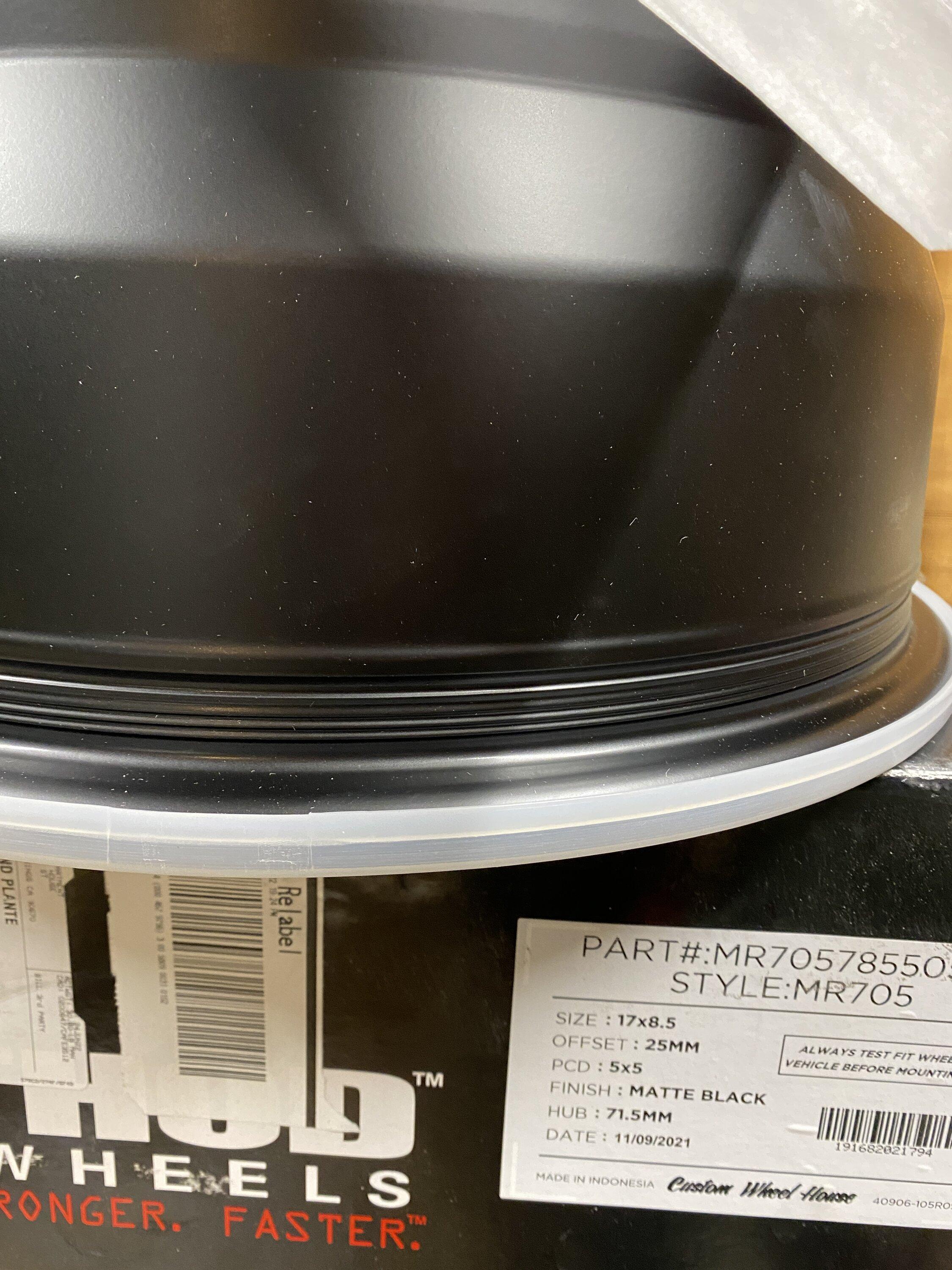

If you are looking for 17's the Method MR705 comes in 17x8.5 +0 or 17x8.5 +25 in 5-127 bolt pattern.

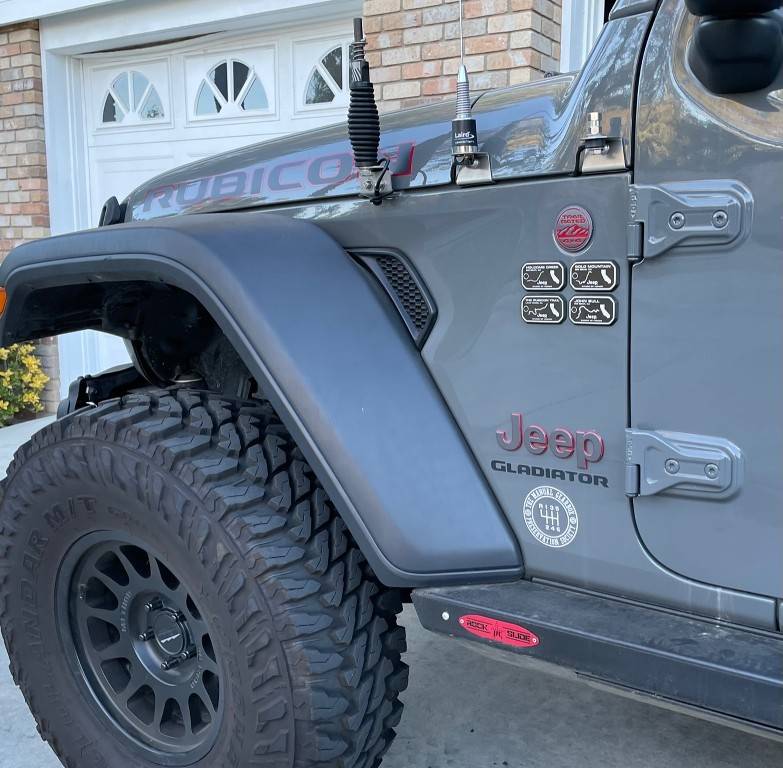

Question for you (or anyone reading this) - when you had your Yok's mounted to these wheels, did they give your shop fits? I have the 37" Yoks and MR705s, so a similar setup, unfortunately not mounted yet. I took mine out to get mounted/balanced and the shop ended up calling me to come get my stuff; they couldn't get the tires to seat on the bead. The shop did call Method and any advice Method had to offer (flipping the tire, lubing the snot out of it, warming up the tire, overpressure [70psi on a D-load 37], etc.), they had already tried. Eventually, the shop got tired of wasting time on them since it was tying up their machine/slowing their roll. Thx much.

Thank you, wondering if the E rating of your 35s vs D on the 37 in. MTs that I have are the difference. They put 70 psi of air in and didn't want to go higher. I know you can go higher PSI on the E-rated tires to seat the bead not that you should have to do that.

It may not make sense, but I am going to try a heavy truck garage to see if they have better luck to get the bead to seat. If that doesnt work, I have a set of AEV beadlocks that I put up for sale, I may just use them and get a different set of tires (AT) with less rigid beads for these wheels.

I have had two sets of 37s mounted on my 703s. Goodyear Kevlar MTRs, and the Yokohamas. They do first lock on to the bead lock, then, after more PSI pop into the channel where the bead grip is. America's tire has had no problem mounting both sets of tires. I live in SoCal, and the weather is mild here all the time. I see you are in cold country. Maybe "cold rubber" has something to do with it. Before you try it again, I would try to warm up the tires in the sun, or maybe inside your house where it is warm.

Hey, thanks for hitting me back. Took one wheel and one tire to the HD truck shop this AM to see if they have better luck and they JUST called and got it mounted. He said it was definitely about the getting the tires warmed up enough. This was an expensive lesson learned; that sucks the most since I had to pay the shop that couldn't mount them for their time.
