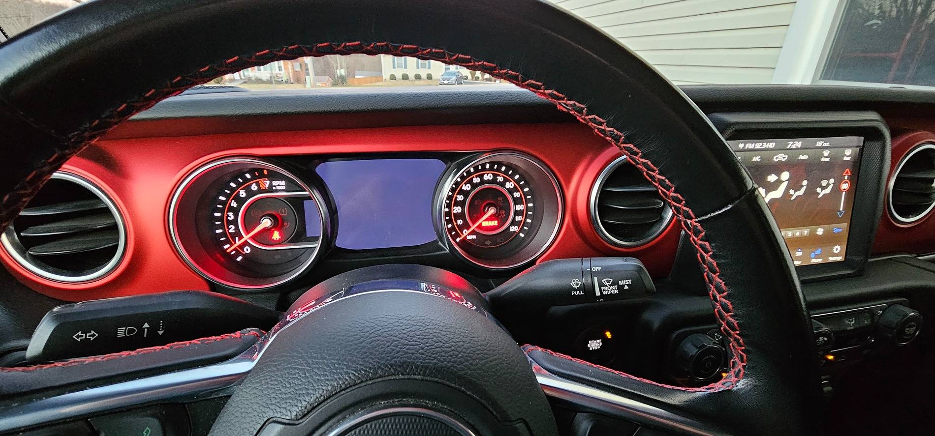

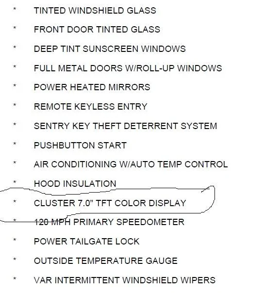

Not talking about the infotainment screen. The cluster is different depending on the trim package. My Rubicon has a 7" cluster.
My 7" screen went out Saturday Dec 21. 5 years old and only 20.5k miles. Now I have no fuel level, miles (of any kind), tire pressure, temperature, etc. You know the deal. Can't get it in to the dealer until January 9.
