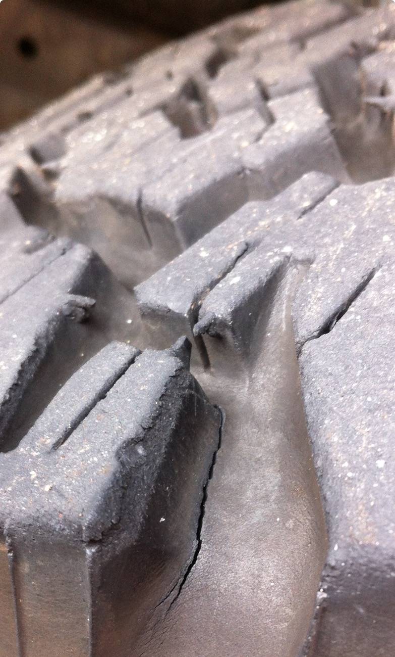

Yeah, tires like to be exercised. Bought a new F250 that I barely put 3K miles on and sat many months at a time, by the 2nd Summer, the tires were cracking extensively
This exact thing happened to me on my Cummins (older date code I found out later). Probably 10,000 miles, cracking. I was pissed. Lucky my buddy ran the tire shop so he prorated me a new set for almost nothing. Here’s an old pic I found of them.
It seems like cracking is kind of common with BFGs. If that’s true, another reason to not want some that have sat around.
