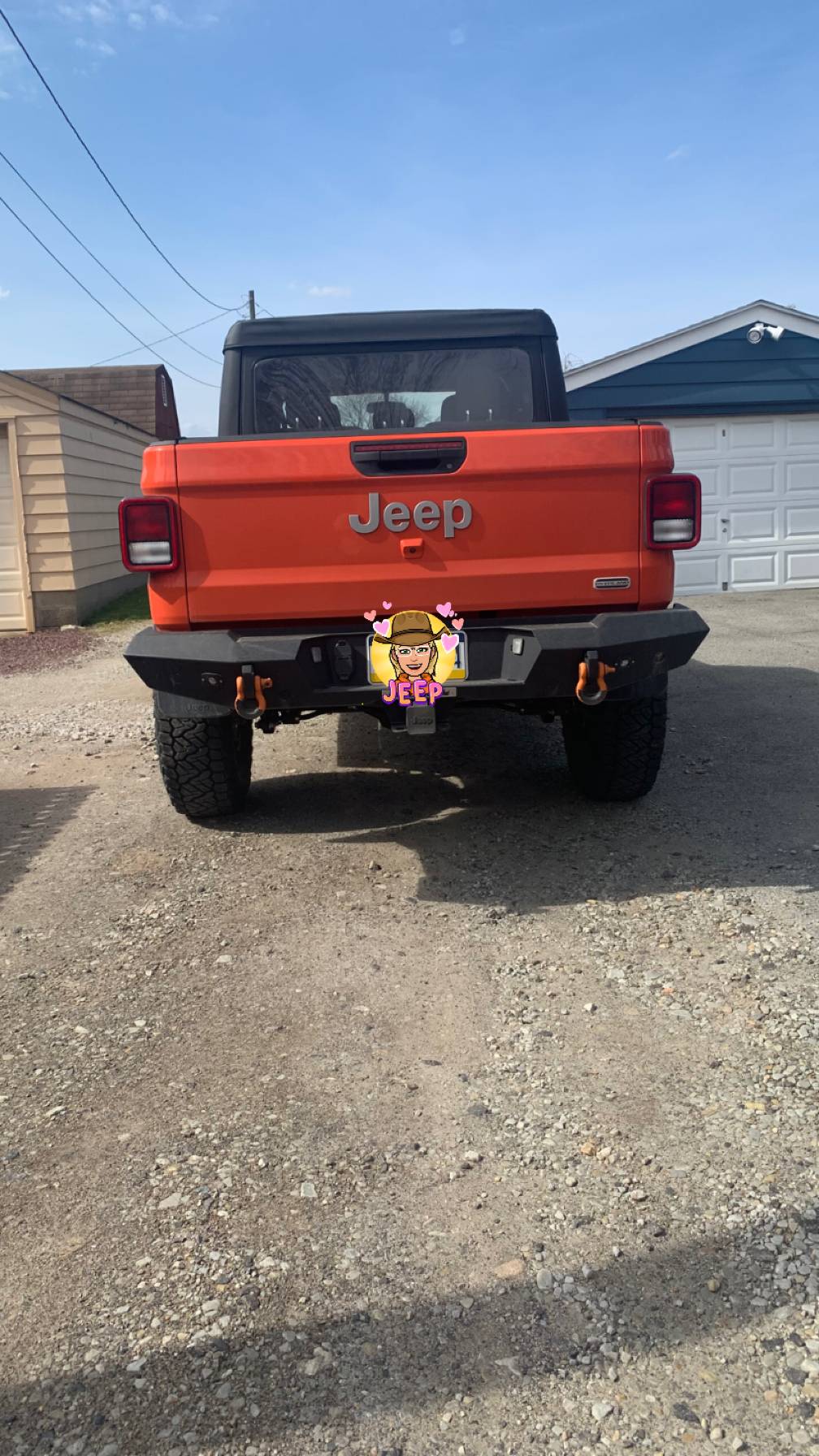

I just got the 4 inch ready lift with 37x 11.50 17 nitto recon grappler
Thanks for sharing the pic! Very capable looking rig!
