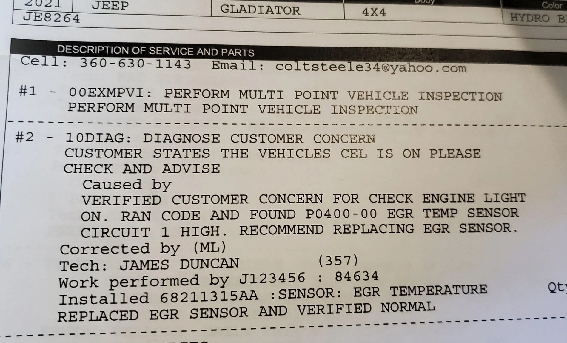

Went by the dealership today. Code was for EGR circuit high. I think it was p0406, they didn't give me any paperwork. They reset it and told me to come back if it comes back on. 2 hours later, engine light back on

Got the truck back. They replaced an EGR sensor. Hopefully that is all and no more issues.
