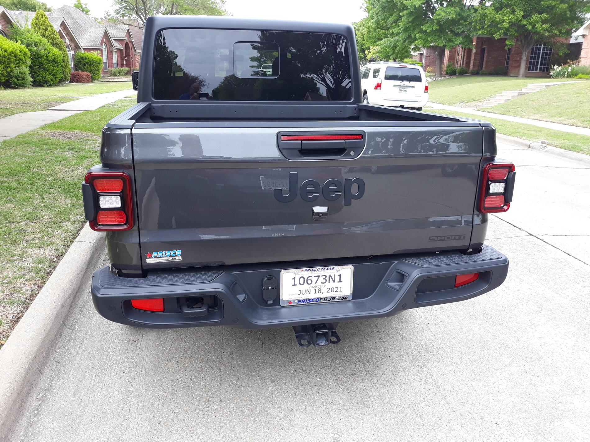

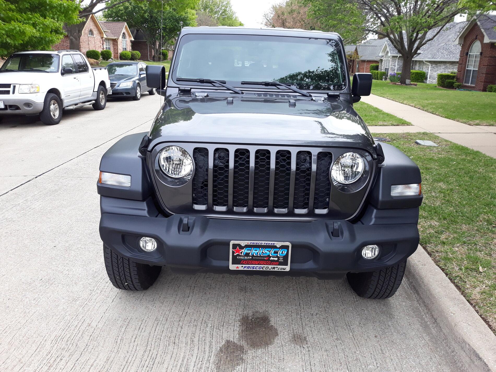

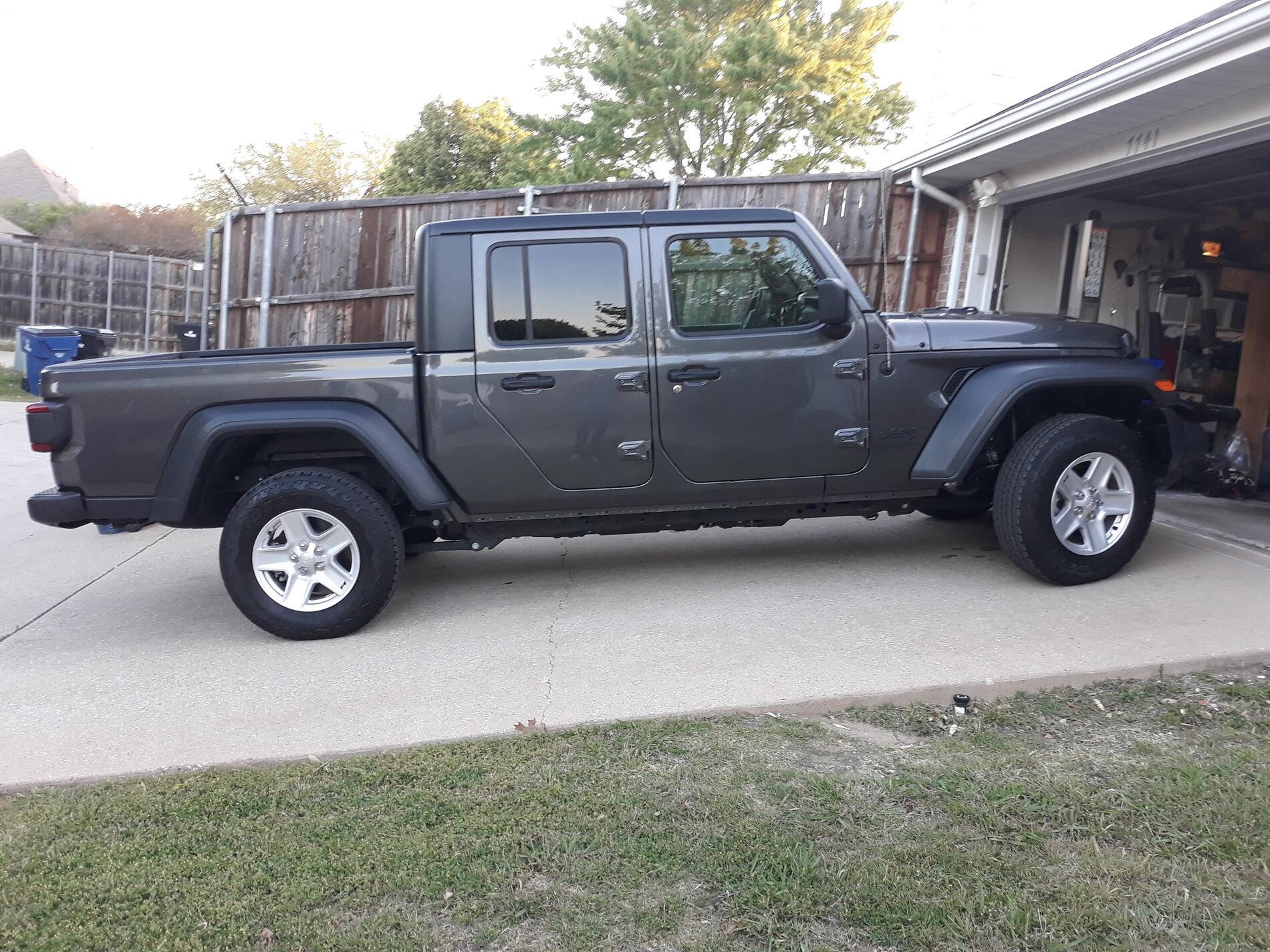

Howdy y'all ! I owned a Renegade for 3 years before finally getting a real Jeep :D I bought a Gladiator Sport, not sure if it's 'S' or just Sport, it has a package that adds a lot of nice touches so either way I'm pretty happy. Talk about a ride upgrade.....anyway, I'm already looking forward to when I replace my tires later on. With just the standard Sport, no lift kit as far as I know, what is the tallest tire I can put on my stock wheels? And, do I have to do anything else if I do that, for speedometer adjustment or anything like that? I'm pretty new at this, so any help would be appreciated.

It’s a Sport S. You can tell by the silver wheels. If it were just a Sport, you wouldn’t even have power locks and windows.

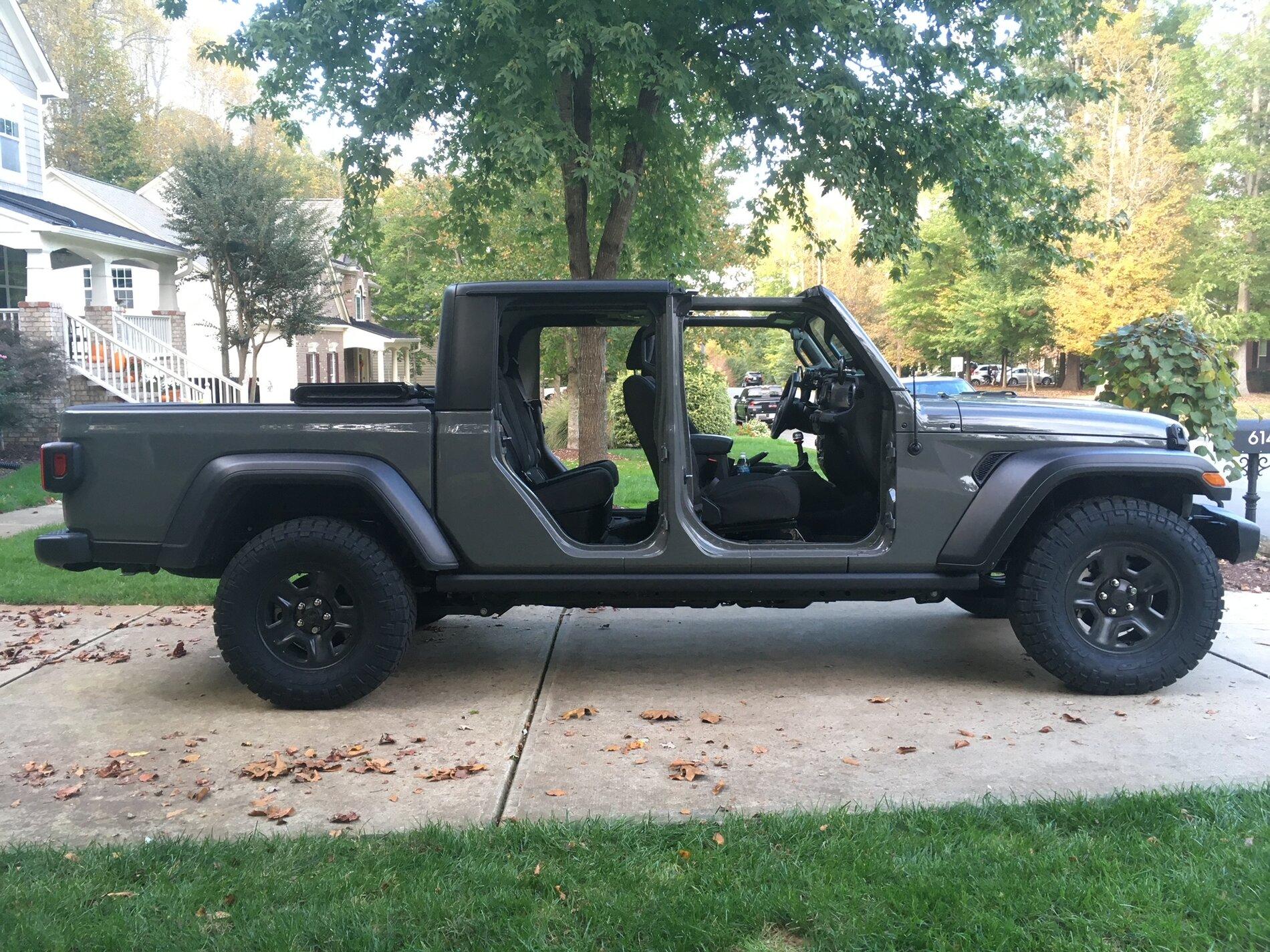

Would 35S rub if I did no other work to the Gladiator? What size is on them right now, if you can tell from looking?
As mentioned, if you do a little cutting of the airdam on the front fender you can easily go up to a 34" tire without any suspension modifications. Here's a shot of 285/75/17s tires that work out to roughly 34". These hit the bump stops before any rubbing.

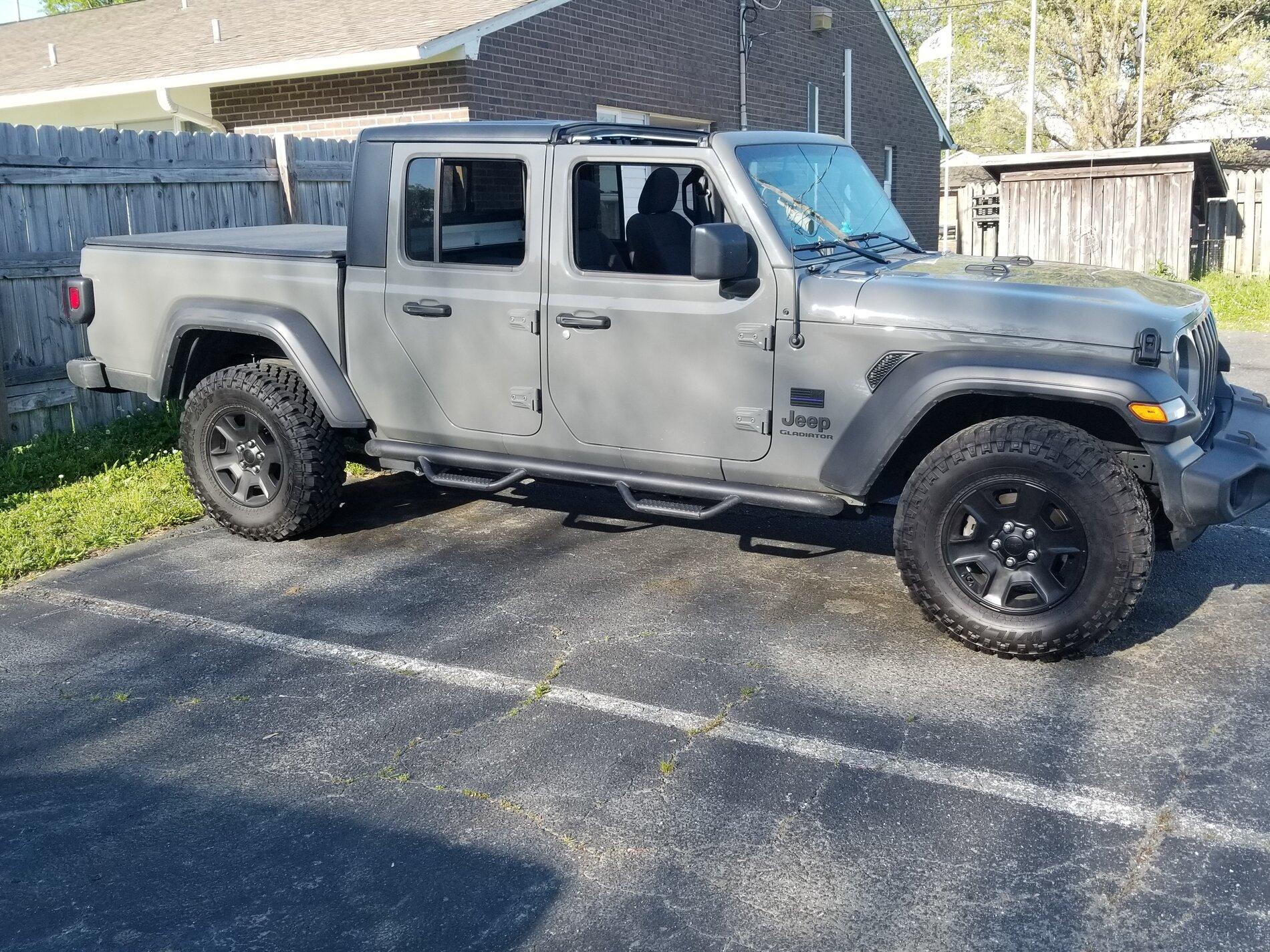

I swapped out stock Sport S tires and wheels for Mohave take off MT 33s. No lift or leveling kit (yet). No problems so far.
