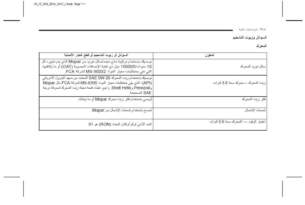

They use 0W-20 globally with no other call out.
Attached is the Middle East OM. In both the English portion and Arabic (PDF pg 559), Only 0W-20 is listed, nothing else.
if you have source data thay says otherwise, I am open to see it.

^^^ I’ll take your word for it but I remember reading that 5w-30 was the oil for the Middle East. I’m on vacation with my family so I’m not going to spend the time trying to find it..
