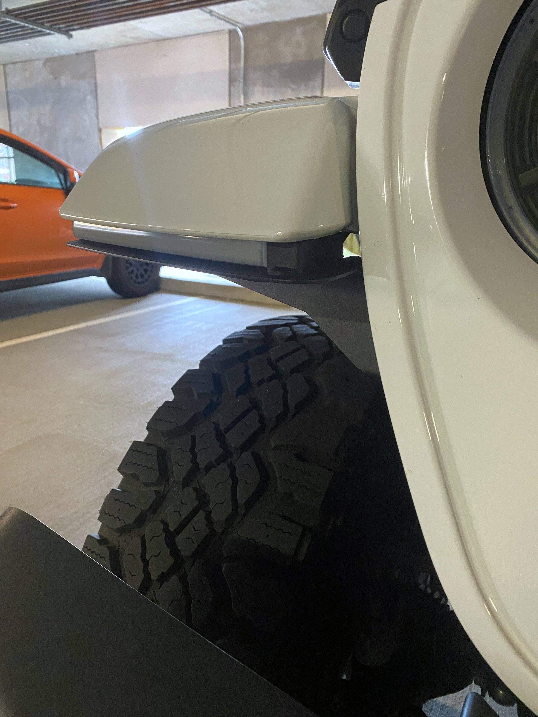

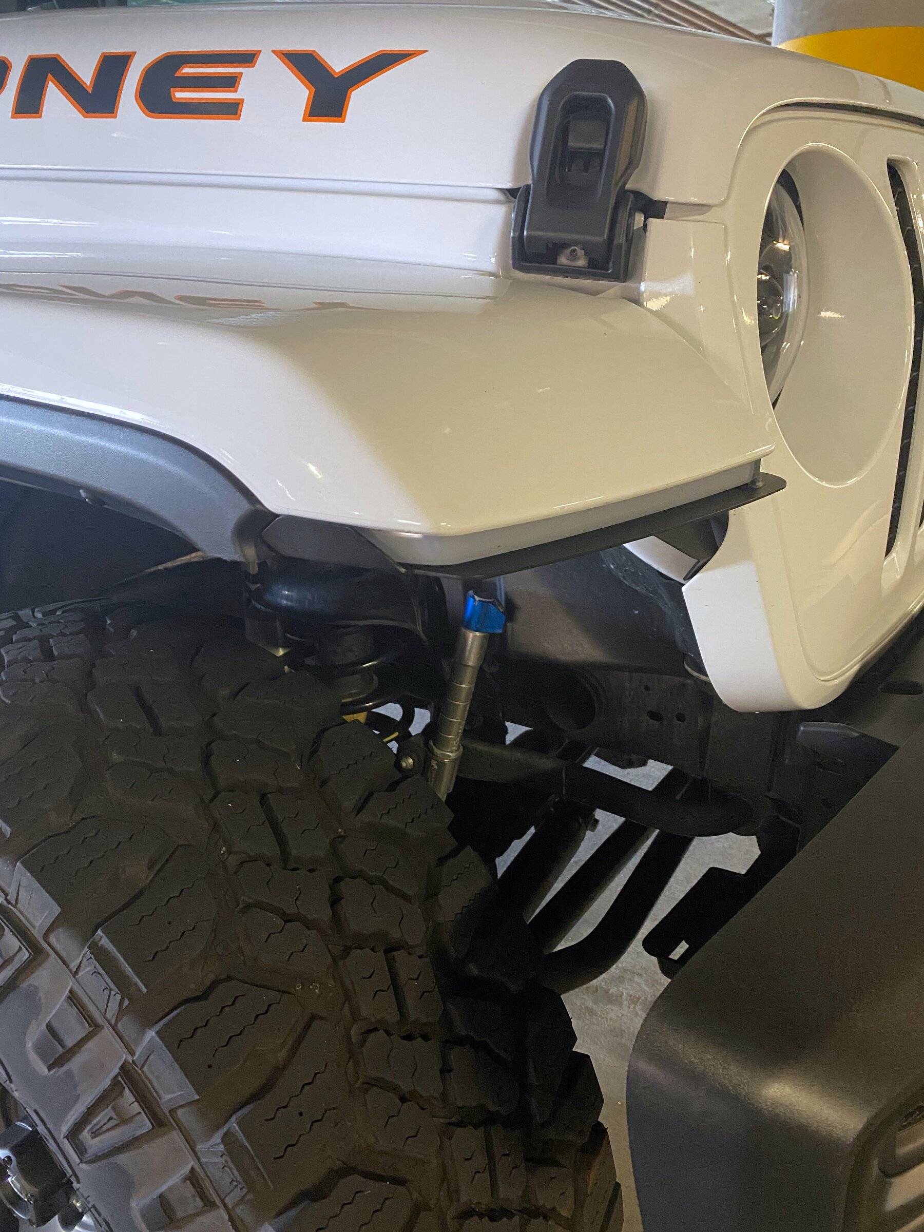

Those aren’t bad. Do you have any clearance issues when you stuff the tire into the fender?
Also, prior to installing the metal liners, I did a fender "Trim" with a set of Rugged Ridge turns. I left the majority of the black trim to keep it looking "Stock-ish".

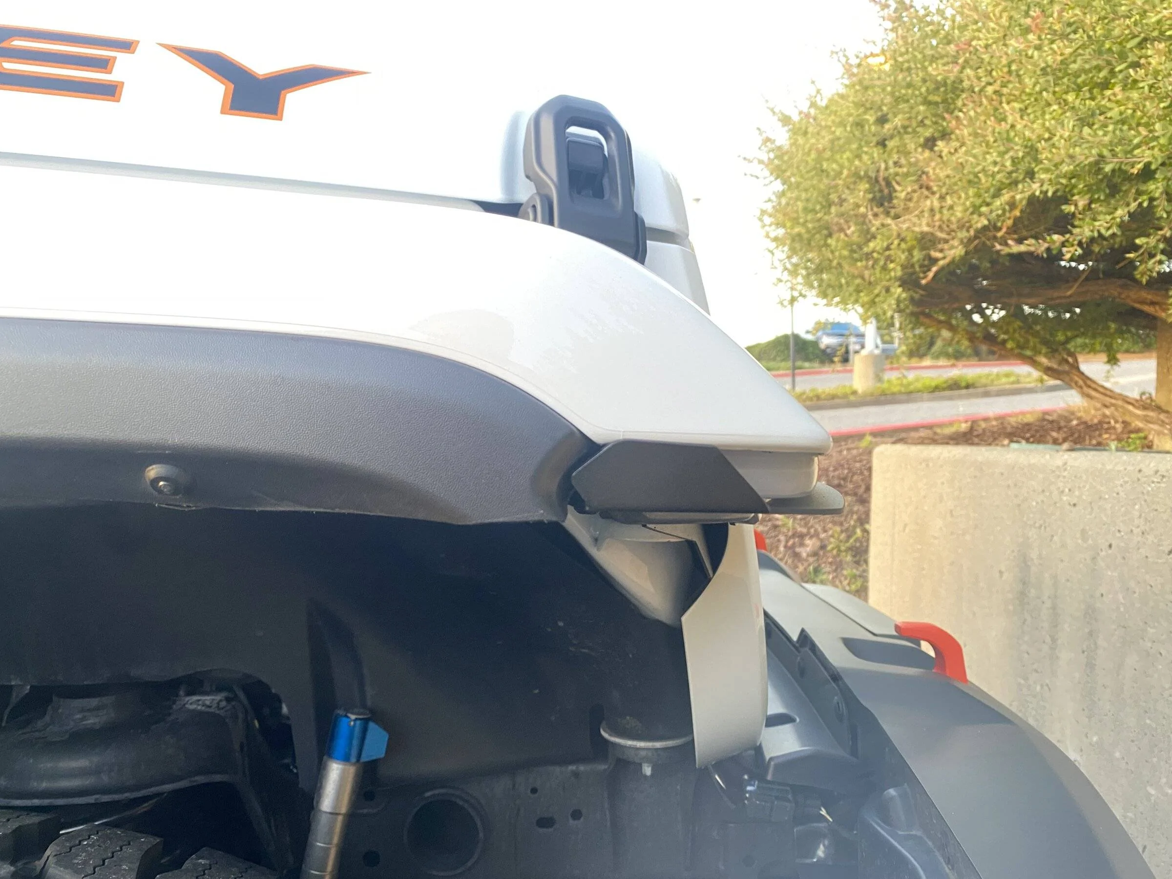

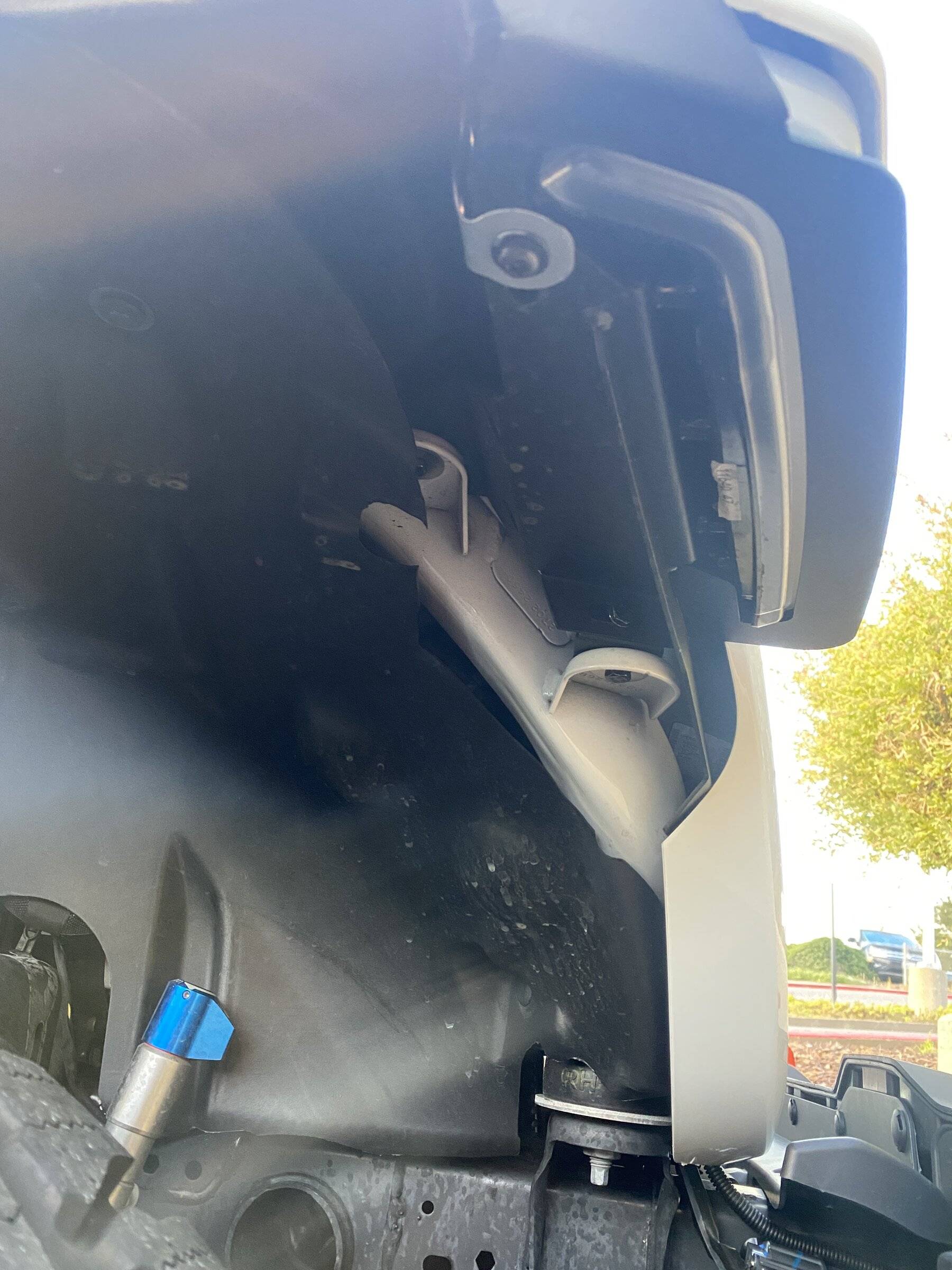

Also had to ditch the APEX autoLYNX swaybar disconnects. I would have to trim a hole in my metal liners for the top of the disconnects to clear.
Jeep Gladiator No-Chop Inner Fenders F3E84D95-A11A-4567-B794-59F08CF5B40D
Jeep Gladiator No-Chop Inner Fenders 1D54F3A6-AC57-459D-BD56-5742CE6142E3
Something like this...

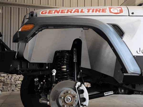

Dan - almost any inner fender can be done with varying degrees of chop ... in order of decreasing degree of chop (most to least)
1) follow manufacturer chop directions (the fender flares are 3 layers ... this removes 2 layers)
2) only remove one layer and front light ... this retains the outer edge similar to @XraytecH above and mine ... i did this so that my front mud flaps weren't blowing in the breeze (i.e. there is a gap between the flare and the mudflap otherwise) and it gains a little clearance but not as much as #1
3) same as 2 but leave the light similar to @CookieSoup
4) Trim the portion of the stock inner fender that is duplicated by the new metal liner and leave a couple of tags on the plastic as you trim to tuck behind the metal ... can't remember the post but it was on this forum prior to March 2021 when I was looking into this
A side note for methods 2 and 3 ... there are some holes that are left that you can see in @CookieSoup 's post that can be filled with plastic rivets that look very very similar to stock ... you will need a washer on the back side of the hole because the stock plastic is too thin otherwise
Rexka 50pcs Fender Flare Bumper Door Trim Plastic Rivet Retainer 1/4 Hole Compatible with Chrysler 6506007AA 07-20 Jeep Wrangler, Wrangler Unlimited JK & 02-12 Liberty KJ GM 10184895 Ford N803862-S https://a.co/d/9BxIUXJ
And this tool
Tool Aid S&G 19400 Rivet Tool for... https://www.amazon.com/dp/B007QV2E50?ref=ppx_pop_mob_ap_share
