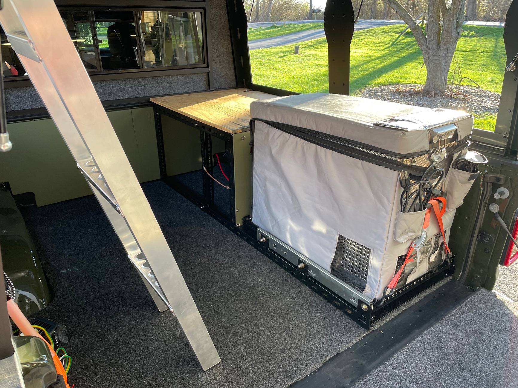

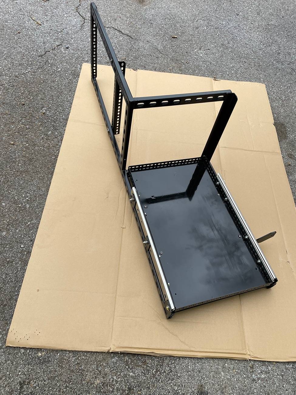

Probably not the solution you're looking for, but I made mine using uni-strut (from the electrical dept at Lowes/ Home Depot) and some pre-drilled angle. It's secured in the truck at the front to a piece of plywood bolted to the front bulkhead using the existing threaded holes. The tab hanging off the side in the rear bolts to the cargo loop by the tailgate. The slides themselves are repurposed from somewhere, probably an old toolbox. I don't remember where I got them. The fridge platform was made with more angle and some aluminum honeycomb panel I had, but thin plywood would have worked, too.
This works for me because I have a topper camper and everything is enclosed.

OP, this is the way.
The other downside of the rebel mount is that the way its molle panel is angled positions the slide plate about 6-8 inches away from the side of the bed, which eats up usable bed space.
a solution like this with two perpendicular points of attachment keeps it tucked right next to the side wall of the bed. I bet this also allows for much less unwanted movement of the entire system

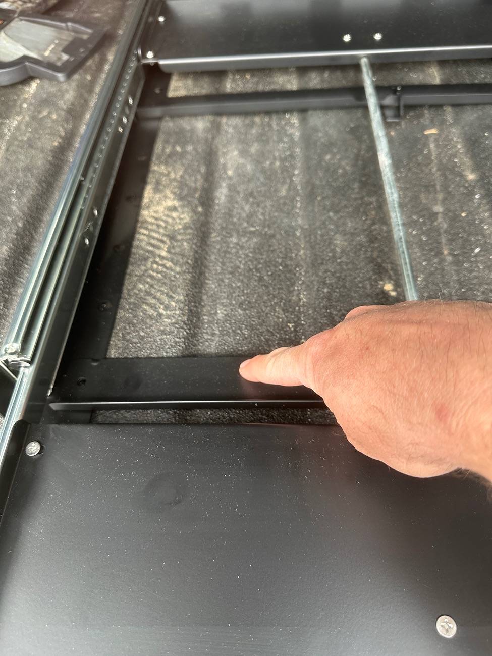

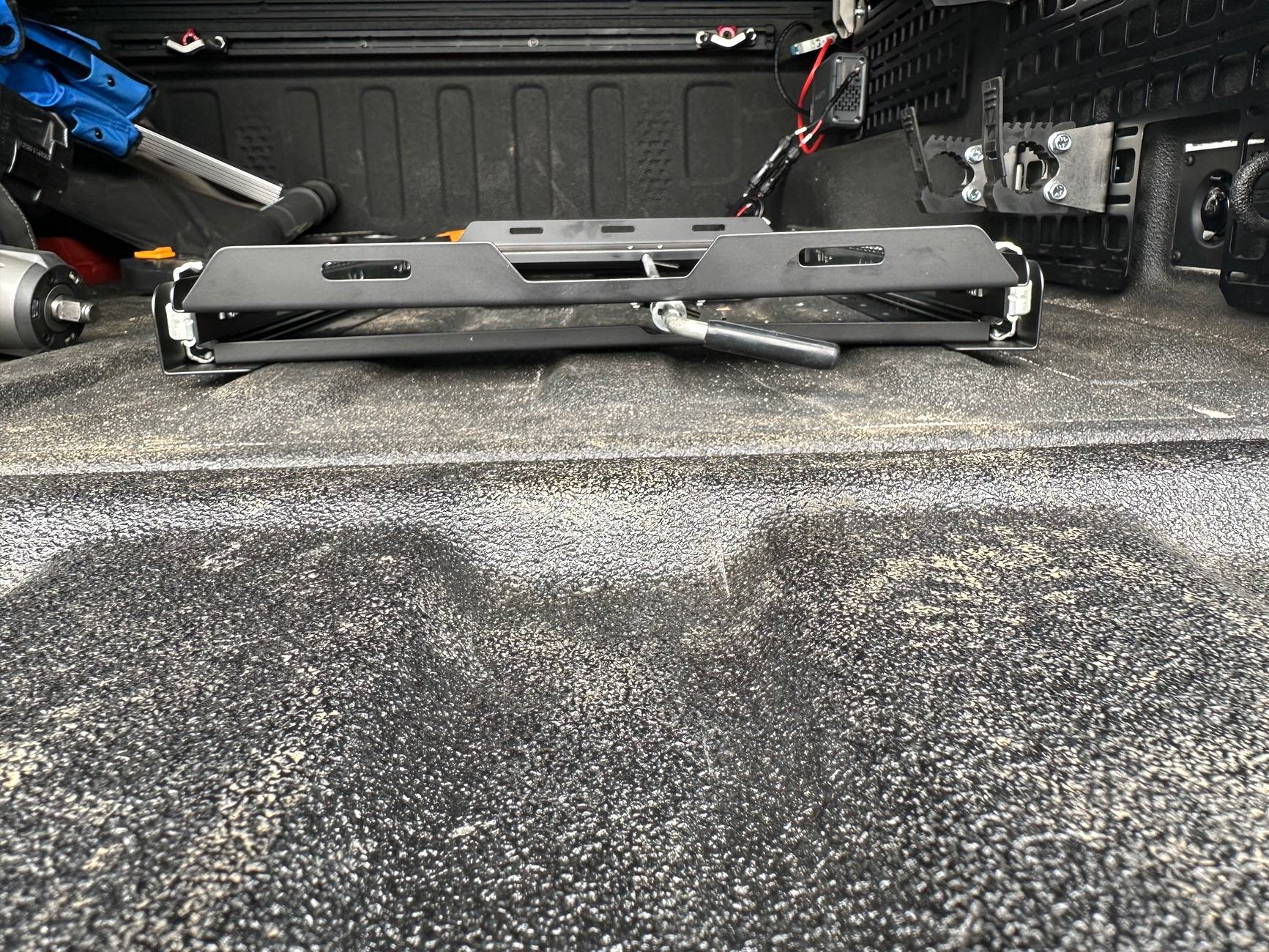

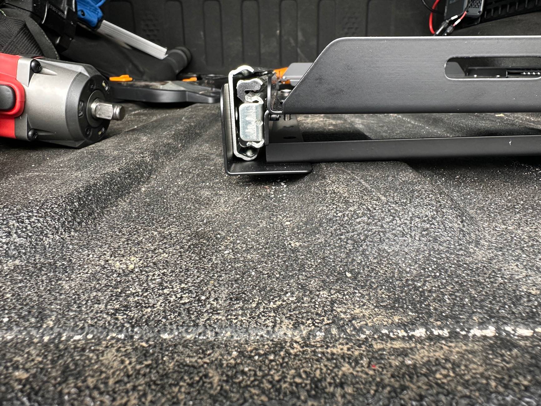

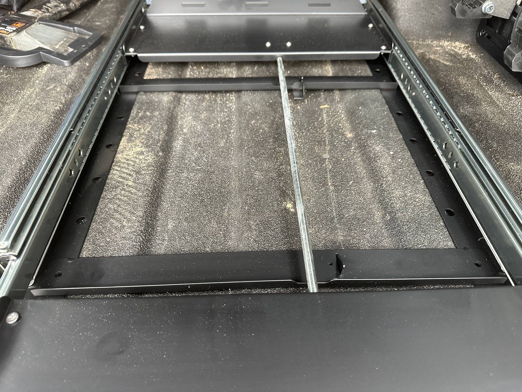

First, sorry it has taken me so long to reply. Been very busy lately with work, the kids, sports and such. I finally started catching up on some jeep projects. I appreciate all your guys replies. I was going to finally try to mount the slide today. I did decide I’m just going to drill in the bed and use riv nuts. However, my slide is a little smaller then where the raised ridges are in the bed based on where the predrilled holes are from iceco. I want to drill into the raised ridges vs the lower points. So my question is would you guys just drill new holes in the cross bar on the frame of the slide where I am pointing? And with the little bit of overhang from the edge of the slide, would you guys think the slide would be fine where I want to mount it. I only want to have to do this once and not have holes through out my bed haha. I appreciate the input.
