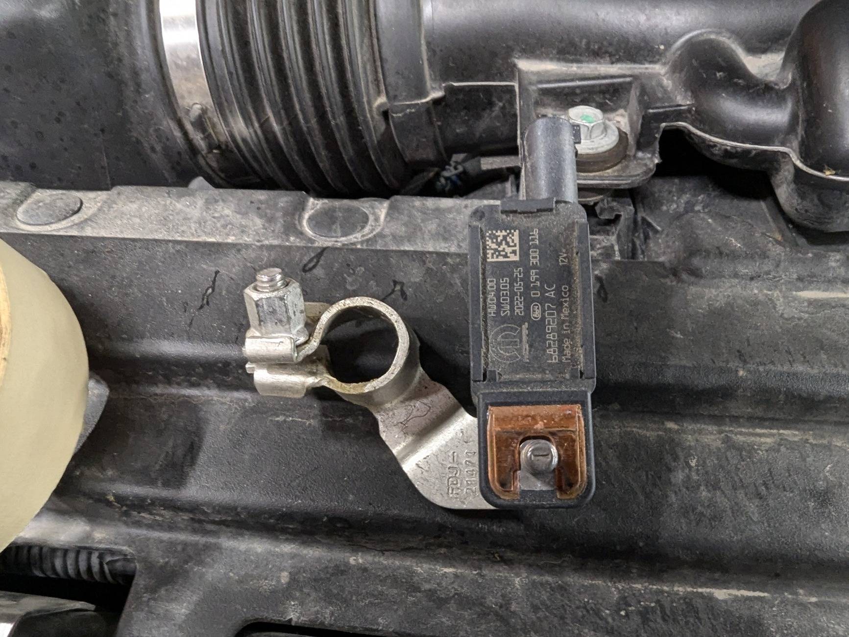

What he said - and charge both batteries fully before installing them, leaving the IBS disconnected while you do so. That will reset it, it will re-learn and things will be fine at least in the battery area.
(this is the IBS - intelligent battery sensor - in case there was a question)
Jeep Gladiator Non-AGM Battery - 2020 Gladiator PXL_20241107_182133606
From FCA (Jeep) -
Battery Exchange
IBS DOES NOT NEED TO BE REPLACED WITH NEW OR RECHARGED BATTERIES. However, it
might require SOC adaptation.
IBS SOC Adaptation (Learning)
Learning needs 1 crank and 2-4 hours of quiescent/sleep time.
Quiescent/Sleep time is defined as Quiescent phase: [-500mA, 50mA] battery current

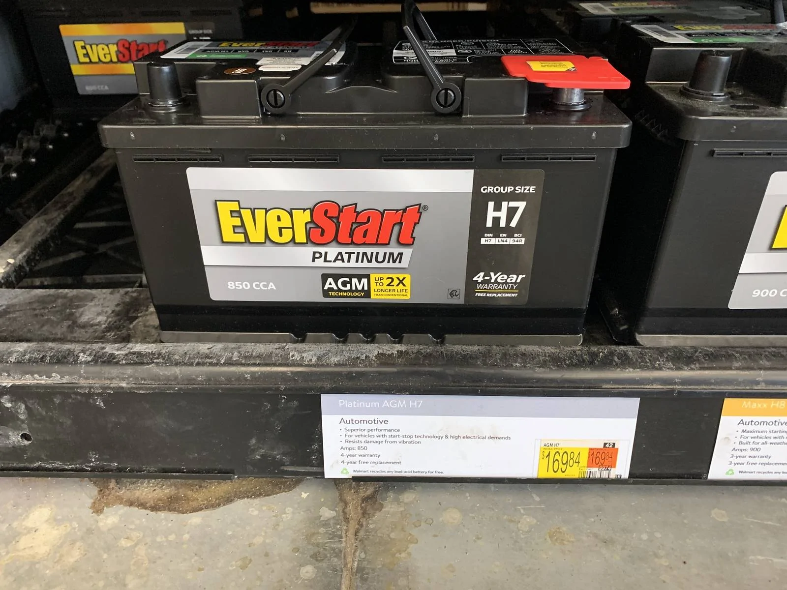

I am a proponent of switching to one battery. The quote above covers some of the logic involved in the switch. A Walmart Everstart Premium AGM group 94 battery will have as much cold cranking amps (CCA) as both Mopar batteries combined. It also comes with a 4-year warranty and the warranty can be exercised at any Walmart.
This photo is a couple of years old so the price might be different:
Jeep Gladiator Non-AGM Battery - 2020 Gladiator i-4rrpkhs-X3

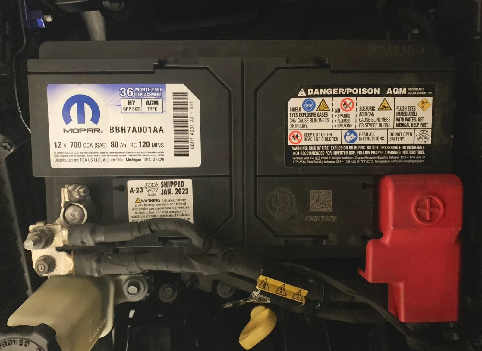

This is the factory group 94 battery. You get this bigger battery if you have an option package that includes auxiliary switches.
Jeep Gladiator Non-AGM Battery - 2020 Gladiator i-H58dQk7-X3

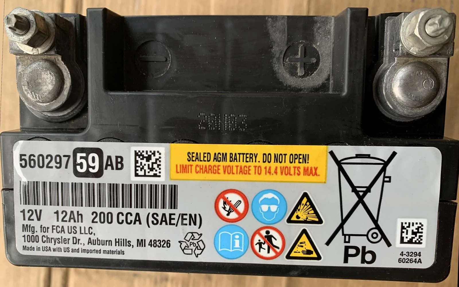

This is the factory auxiliary battery.
