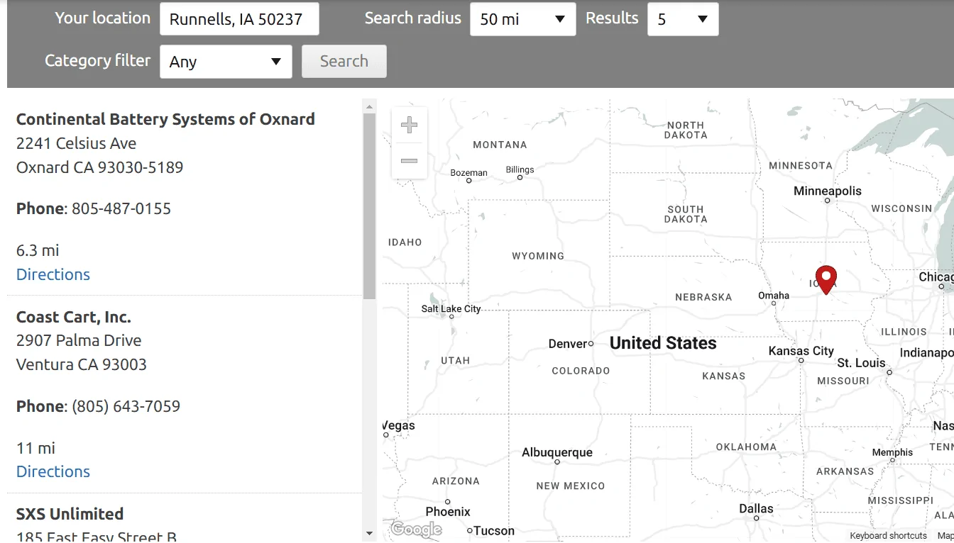

This made me laugh - put in search criteria for a dealer, 50 mile radius. Came up with 5 matches, all in California and look at the distance they are listing - 6.3 miles, 11 miles, that's funny. that's more like tanks of gas to get there, not miles.
I think their web designer needs to re-think his math.
lol That's pretty funny. My local doctors number was listed wrong and somehow it called the parents of an old coworker I know who just recently moved back to Mt with his wife - what a crazy small world! I have chatted with their electrical engineers a couple times and they have been pretty nice - I also like that you can order some of their batteries via Amazon and have it sent directly to you which is important for me being so remote. But cost is still the issue. The 115ah deep cycle battery I got was something like $350 on Amazon. That would work for you - but only for 24 hours.
