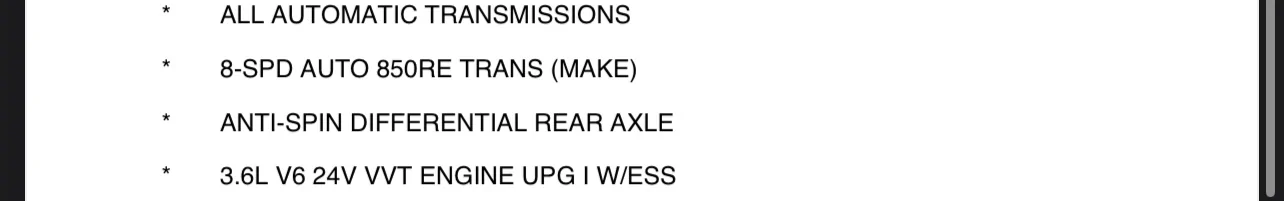

Not sure if I missed it but do the Overlands come with the limited slip in the rear?
I have it on my 22 and had it on my 20.
It was an option for the 20 - might have been for the 22 as well, can't recall
EDIT -
Checked the build sheet for my 2022 - it is under options
Jeep Gladiator Not impressed with Gladiator performance in snow 1700705934689
So yes, it was an option for 20, 21 and 22 model years.
I can't speak to 23 or 24 model years.
