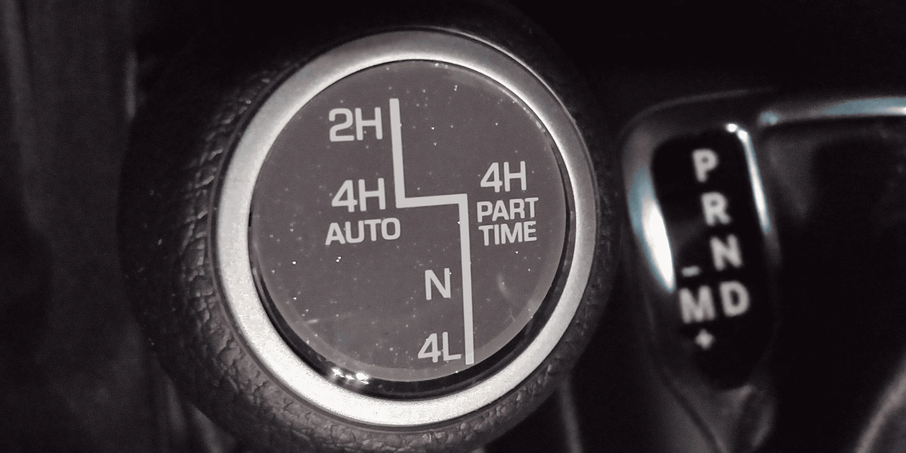

That was a big problem searching for a purple Wrangler for my wife - SelecTrac was an absolute necessity. It needs to be put in 4H auto and left there from first snow until it's all over, or for that matter, left there so it would be more like the Grand Cherokees she was so used to. No way she could fuss with shifting in and out of 4H with the standard transfer case.
What I found was that almost no Wranglers had SelecTrac - the few that did were lacking so many other things we wanted.
But the 4xe comes standard with it.
4H Auto was one of the mandatory factory features when buying my JTR as well. We have it in my wife’s JLUR 4XE and after having a JLUR without it before, the difference was night and day on snowy roads.

Interesting responses. I'm very familiar with the 4x4 system in the Jeep, the Rover, and many other rigs out there (I said I was an experienced off-road enthusiast). The road was snow-covered with probably 3-4 inches of snow with maybe one set of tire tracks. No, I was not in 4-low. I can't think of any reason to use gear reduction on-road. As for people commenting about Select-Trac or whatever Jeep calls their automated 4x4 system vs the basic part-time system I have, its nonsense that Select-Trac would outperform Command-Trac on snow covered roads. After all, consider what the automatic system does...it supplies power to the front axle automatically when slip occurs using a clutch and sensors, up to 50-50 split front to rear. The Command-Trac part-time supplies 50-50 front to rear any time 4H or 4L is selected. The beauty of the Select-Trac is that it can be used seamlessly in changing conditions, and be left engaged on dry roads. Obviously Command-Trac is part time and needs to be disengaged on dry road. The old Range Rover has true permanent 4x4, using a geared center differential to send power to the front and rear 50-50 at all times; however that center diff is open and relies on a viscous coupling to control front-to-rear slip. It can apportion up to a 50-50 split as well, and it does so mechanically without the use of clutches or sensors. The thing is, I was on snow covered roads. I don't believe for a second "Select-Trac" would have performed any better, and frankly in these conditions I would have manually selected 4H "locked" anyway.
As for weight distribution, I did think the Gladiator probably had fairly good ratios. I've had (and still have) a heavy-duty pickup and in 2WD even with studded snows they are helpless. 4x4 is needed in snow basically all the time. But your typical half-ton crew cab short bed has pretty good weight distribution as well and they go much better in 2WD than the HD's.
I'm thinking its either my 10-ply Wildpeaks, possibly in combination with the wide footprint which might make the Jeep float on top of the snow vs dig into it.
I 100% agree. It makes absolutely no sense why auto 4H would do any better than locked 4H in snow. It’s anything but that!

Surprised this thread has this many replies honestly. this has nothing to do with 4HI Auto or not nothing. This is an example of someone who's comparing the rear wheel weight of an SUV to that of a Truck and is confused how its lighter. If your in areas where you get this much snow, you should have learned long before you bought a truck, to get traction in a pickup, you need weight in the bed. sand bags, anything. Auto engaging the front axle on command would have no improvement here (4HI Auto), the OP's issues were directly related to thinking a pickup would handle/drive like an SUV in the snow, nothing more, nothing less. Good thing he changed the tires at least otherwise this would have been a much more angry rant (those stock sport/overland tires SUCKED for me in the snow/ice 2 years ago)

It's not on the build and price for 2023 (2024 B&P not on the website yet). If I were in the market again for a JT, this would be a concern as I live in snowy Wisconsin.
I just put it in 4H Auto and left it there all winter. Killer in the snow.
Going up a snowy hill in 4H part time = the exact same thing as going up a snowy hill in 4H auto. So explain to me why having an auto function as a part of your manual transfer case was a must for snow?? I could be missing something here?

...Auto engaging the front axle on command would have no improvement here (4HI Auto), the OP's issues were directly related to thinking a pickup would handle/drive like an SUV in the snow, nothing more, nothing less. Good thing he changed the tires at least otherwise this would have been a much more angry rant (those stock sport/overland tires SUCKED for me in the snow/ice 2 years ago)
Wow, thank you for clearing up my "confusion." Your condescending know-it-all tone is really great! I think if you read my posts fully, you'd understand I know plenty about driving in snow, driving different types of vehicles, driving with different types of tires, and driving off-road. The whole point of my post was that compared to other vehicles, I expected the Gladiator to go better than it did - in my experience anyway - and wanted others to give their opinion as to why. I wanted to hear others' experience with their JTs in snow. And as a result, from what I've read, it corroborates my original thought that the tires I ran this summer are likely not ideal because of their width and possibly added stiffness. That's it.
Actually, its not exactly the same thing. The Auto 4H mode is mostly reactive to slip. The transfer case may apply more power to the front axle proactively based upon your accelerator input and steering angle being fairly straight, but mostly power is ramped up to the front axle based upon slippage detected through speed differences of the ABS wheel sensors. Its really no different than full-size half tons with "4A" mode which do the same. My point is that if you are already locked into 4H going up a snowy hill, you will never lose momentum because the auto 4x4 system has to detect slippage and transfer power, no matter how quickly it can do it.
