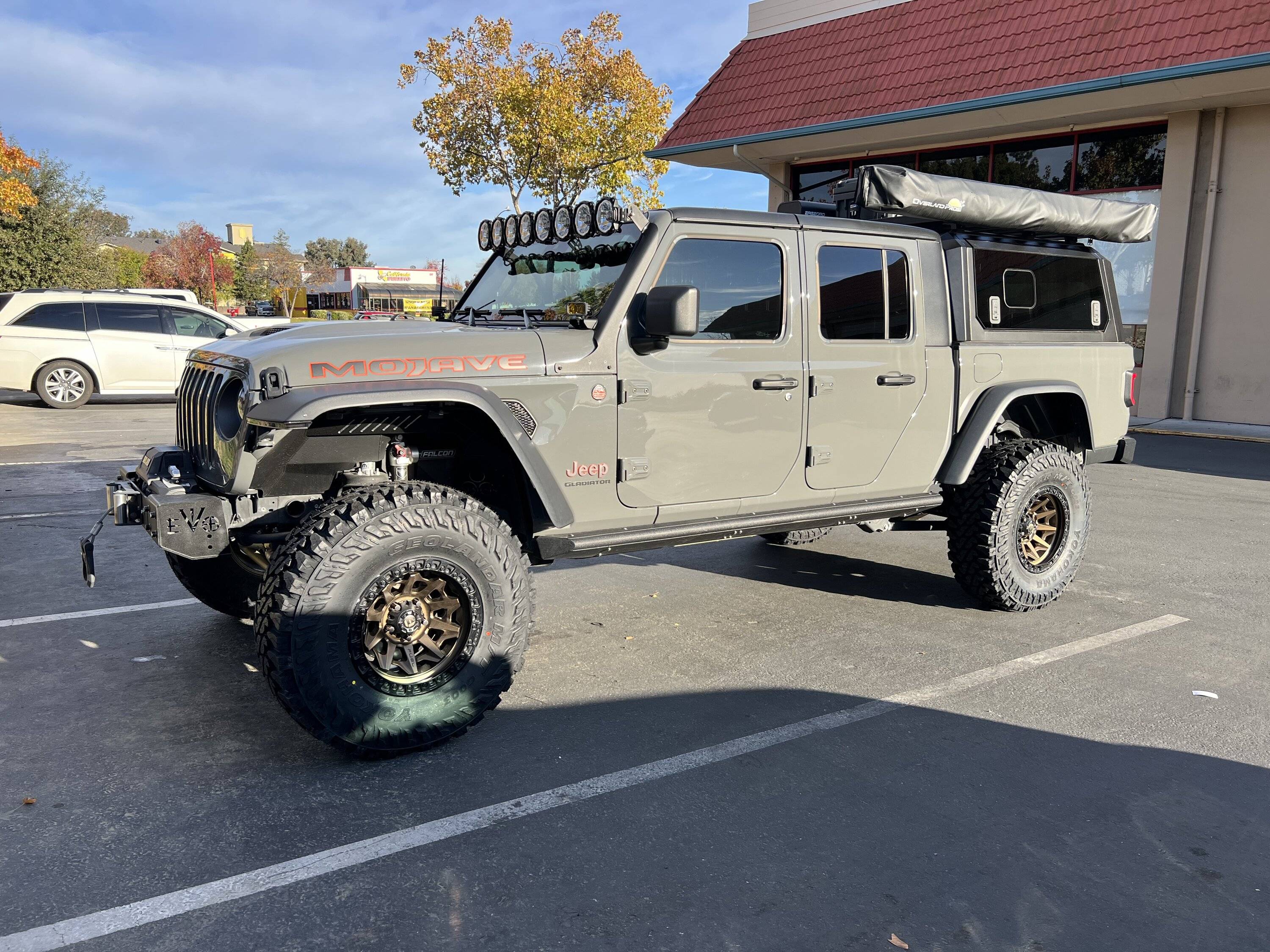

Sounds like an extreme highway slope. Can you get 37's under that RR?

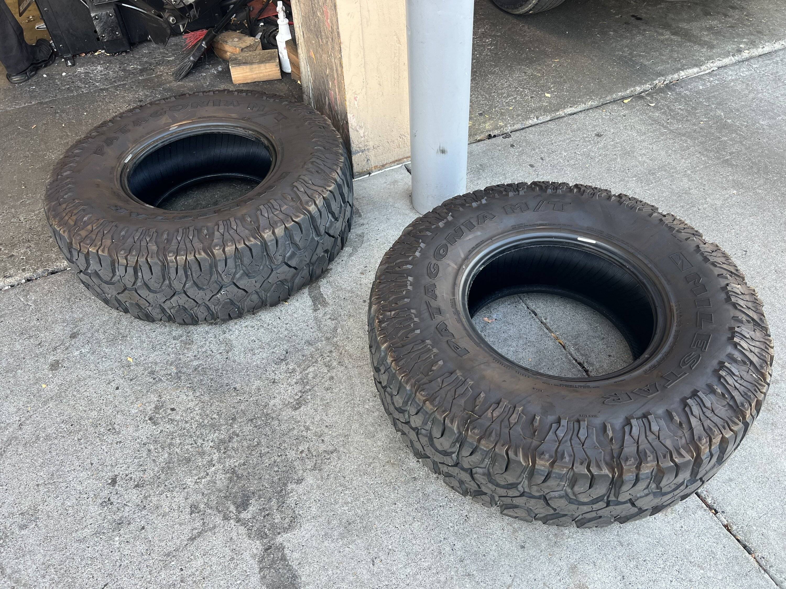

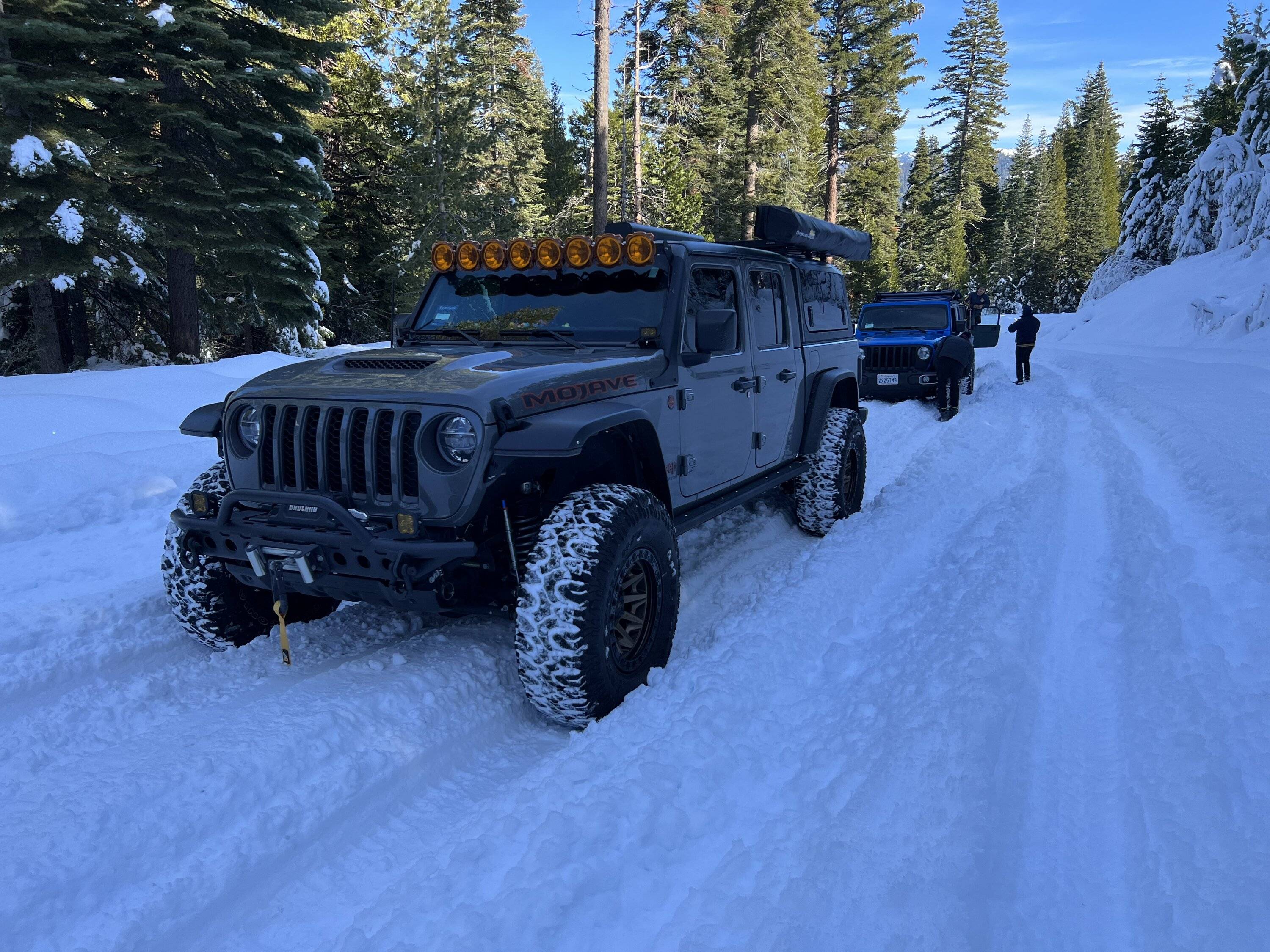

Zero complaints in snow. I just had the Patagonias removed. Personally those tires don’t like ice but deep snow was not an issue. I’m going to try out the Yoko MT 003 this year.
That's a nice looking rig.

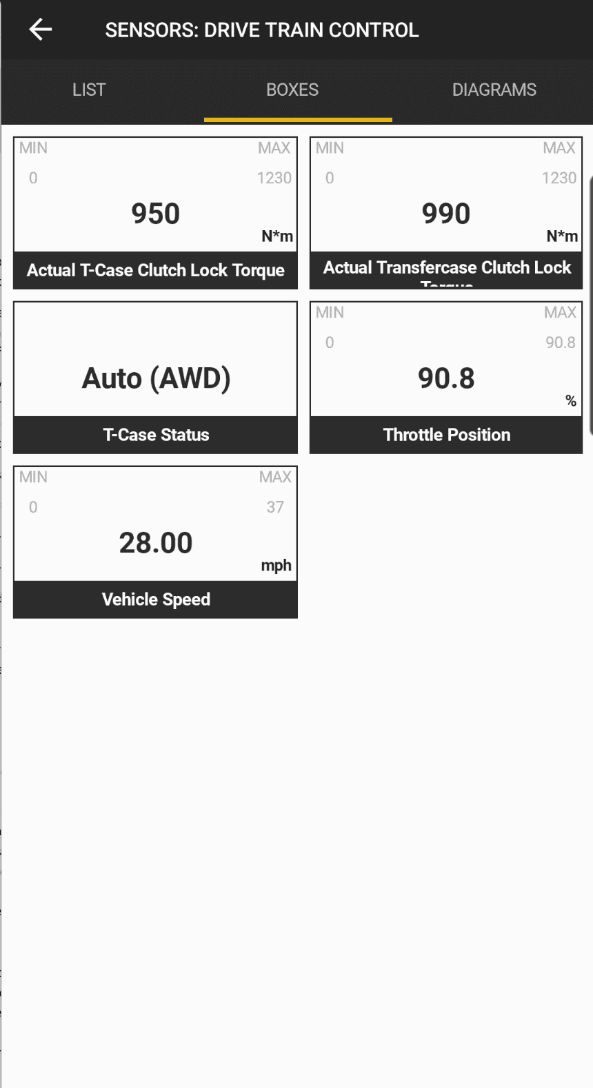

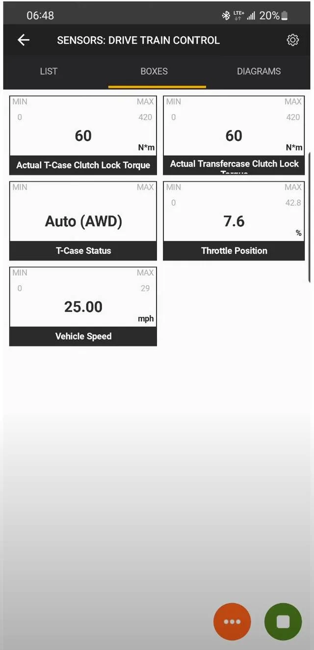

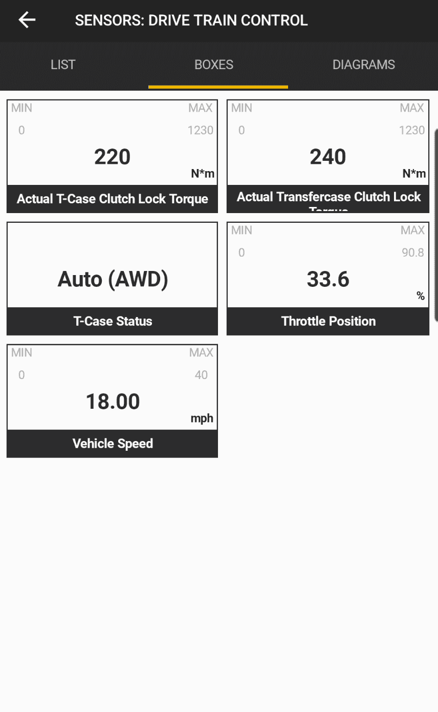

We all realize that the difference between 4HI and 4HI Auto is that the T-Case has a motor to disengage and engage the front driveshaft upon detected slip in Auto compared to always supplying torque to the front driveshaft, right? That's the 1 and only difference. It's still a basic T-Case and always is 50/50 (all 4 wheel drive settings, besides 4HI Auto when computer commanded to engage front driveshaft) or 0/100 (2H power distribution, or 4HI Auto when not computer commanded to engage front driveshaft)
Uh, Jeep expert - no, that's not the case and we don't all know that because it's wrong.
I've got JSCAN captures to prove it's a clutch system that operates with various degrees of application meaning it can be from slight power to the front all the way to fully engaged giving it a split of torque.
In fact, it's applied when you sit at a stop light, then releases as you gain road speed. And it's also applied based on throttle application. It's absolutely not a motor and it's not in or out.
It's in 4H mode when you don't even realize it.
Jeep Gladiator Not impressed with Gladiator performance in snow transfer-case_dtcm-4h-auto
Jeep Gladiator Not impressed with Gladiator performance in snow DTCM-4-high-Auto-30-throttle
Nail it and it applies more pressure to the clutch pack -
Jeep Gladiator Not impressed with Gladiator performance in snow DTCM-4-high-Auto-WOT-throttle
