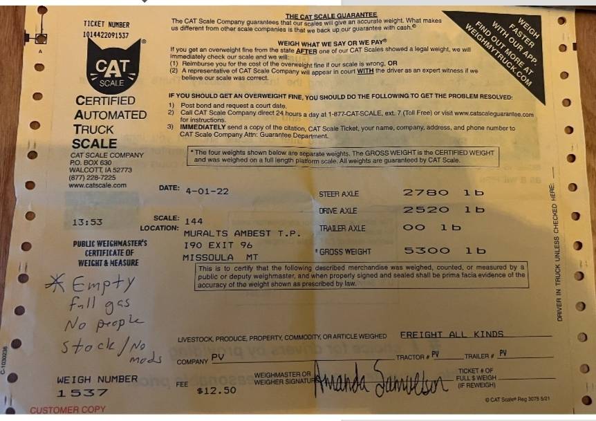

I’m referencing axle weight. Any way you put it it’s not light in the rear.
https://www.jeepgladiatorforum.com/forum/threads/diesel-lift-options-axle-weights.36045/
I hear you....
There has been a lot of debate about this. So its nice to see facts. I just got this from another member:
Jeep Gladiator Not impressed with Gladiator performance in snow Screenshot_20231124_124809_Chrome
I have a diesel, so it will obviously be a little different, I have mine setup to get weighed at my local CAT Scale at the beginning of December....
Now , I need to figure out the best place to center it over the scale. Seems best to seperate the jeep evenly... maybe measure bumper to bumper and divide in half or axle to axle and divide in half... ? Tring to find facts over opinions so I get it right.
Seems this is a case of appearances can be deceiving.
