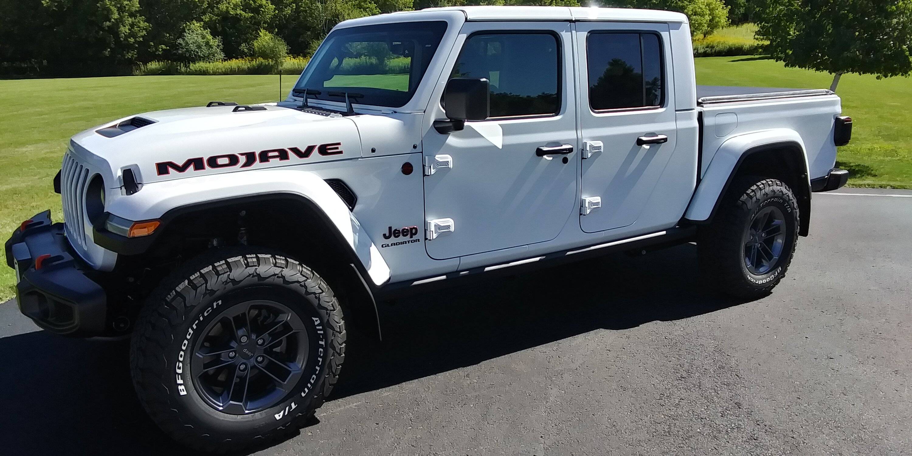

This was my personal Wheel/Tires set up. Again, like a sure-footed mule in the snow.
