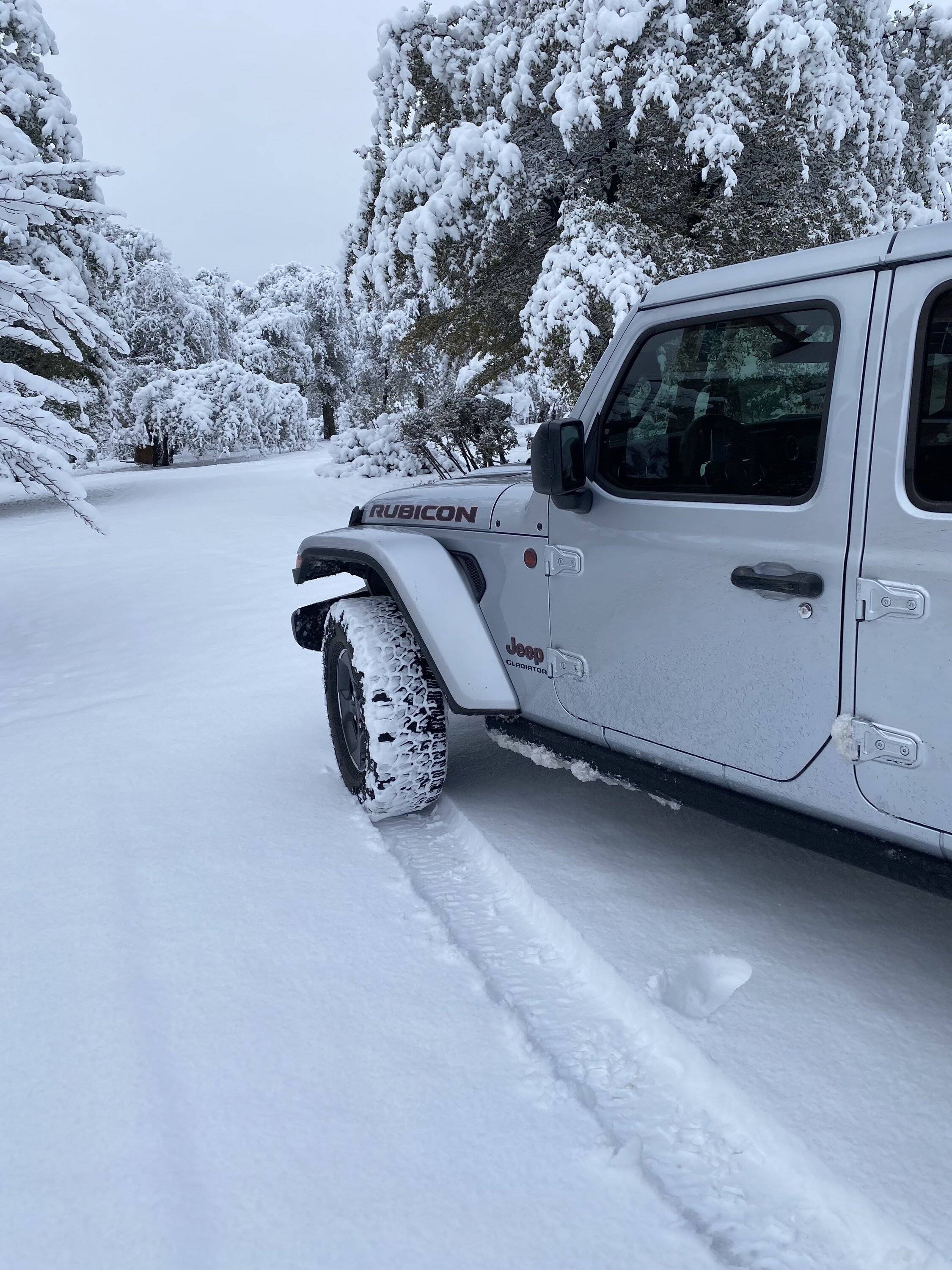

Bottom line is that you don't have Selec-Trac. If you did, I suspect you would be here telling us how your JT is a beast in the snow (I know this because I ordered my JTM with Selec-Trac and AT3Ws).
Ditto. My Rubicon w/ Selec-Trac is awesome in the snow. Love it!! Can't wait for the snow this year!!!!!

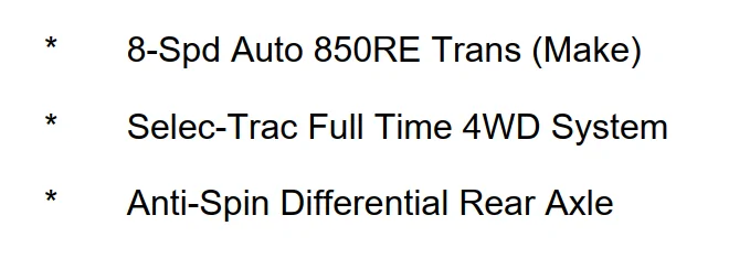

I have it on my 22 and had it on my 20.
It was an option for the 20 - might have been for the 22 as well, can't recall
EDIT -
Checked the build sheet for my 2022 - it is under options
So yes, it was an option for 20, 21 and 22 model years.
I can't speak to 23 or 24 model years.
There is no problem with it that I'm aware of. It's standard in the 4xe Wrangler.
Look around the forums - so far no one I've seen has said "my SelecTrac failed" as far as Jeep. There's no talk of transfer cases on the 4xe forums and I've not seen it in the Wrangler forums but then I tend to not be there much - totally different crowd.
Likely it's a supplier issue - they can't buy them?
Seems to me there's a lot of stuff missing on the Jeep com build and price site. Slim pickens.
I just went back again to see if maybe I was missing something, nope. Under multiple build options and models for gladiator and wrangler, no selection-trac option available. Interesting...

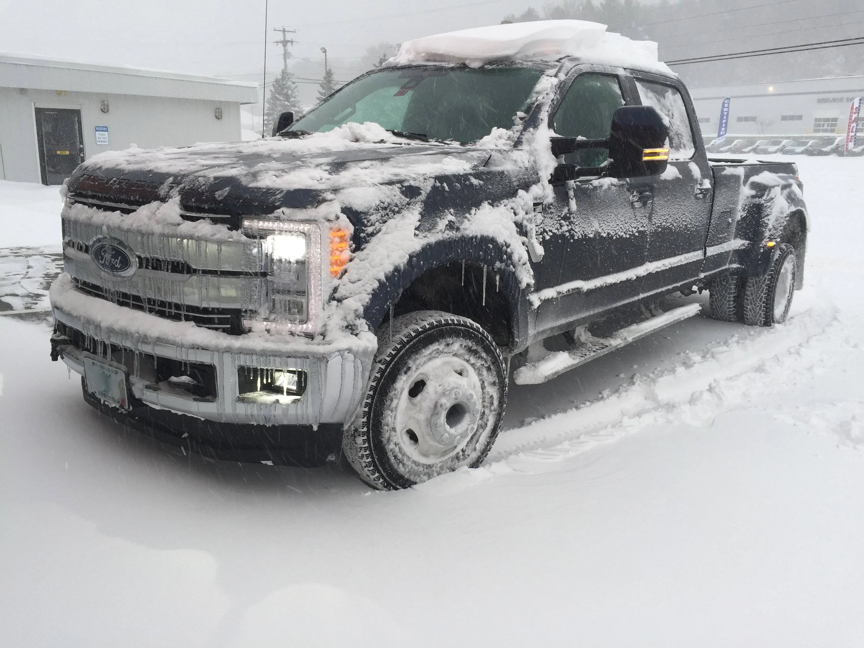

All things being equal a pickup will not perform as well in snow as an suv/wrangler because of the light bed. I’ve been up in the mountains and the hunters with the dog boxes always have an easier time. With some overlanding stuff, camper shell, etc., the Gladiator does a lot better.

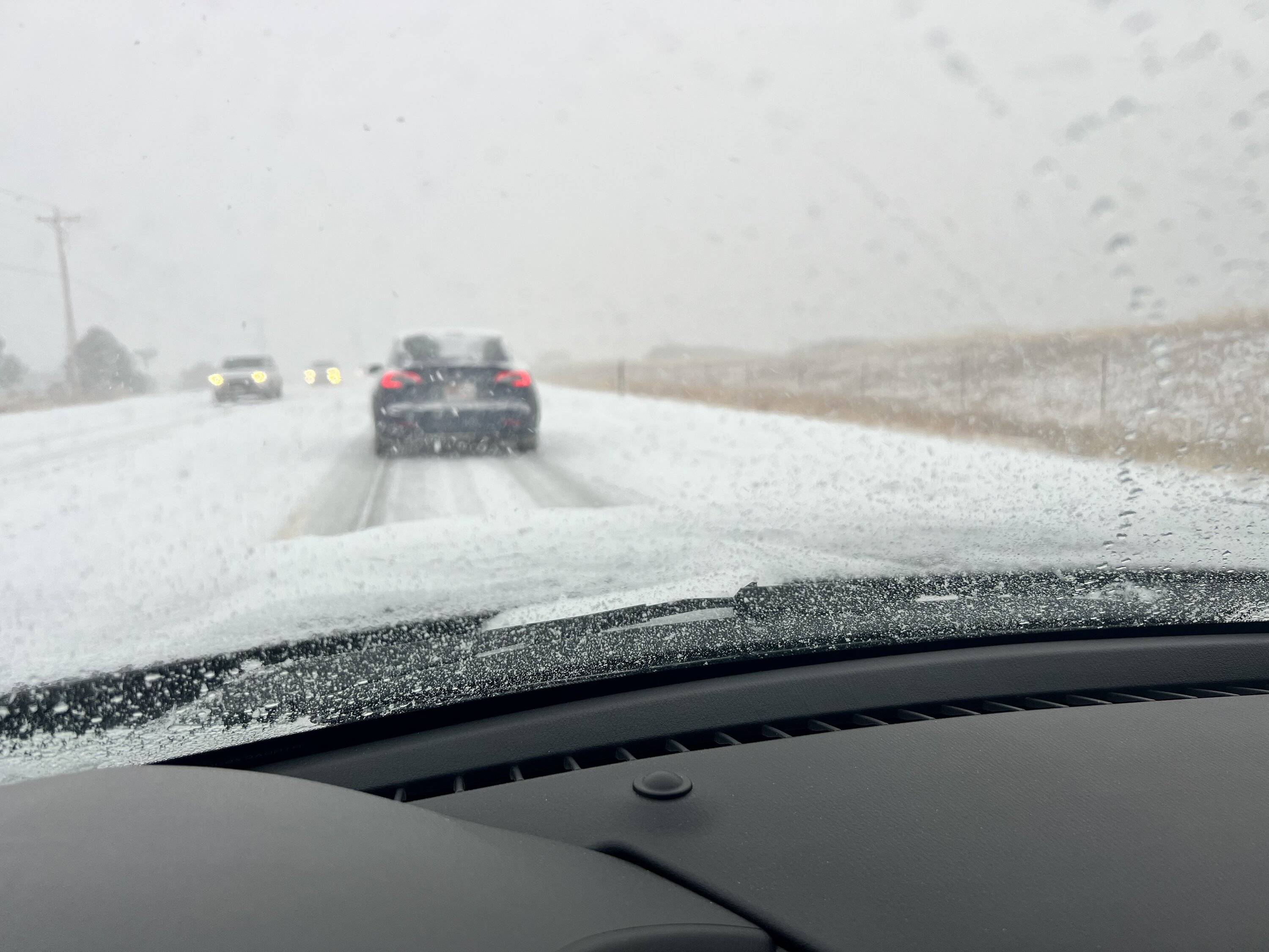

lol…
On that drive I passed 2 ditched 4 runners, one ditched JL and a ditched f350.

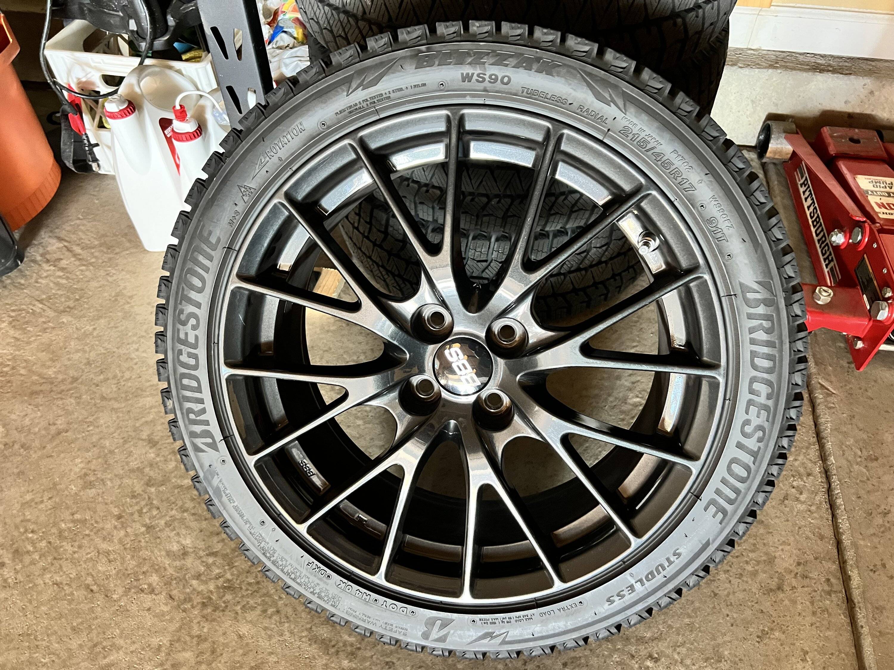

Snow tires always take the win in snow…
Also lol with less weight you will stop faster.
If it was deep obviously I’d want my jeep, but on snowy roads vehicles with actual snow tires win. Always.
