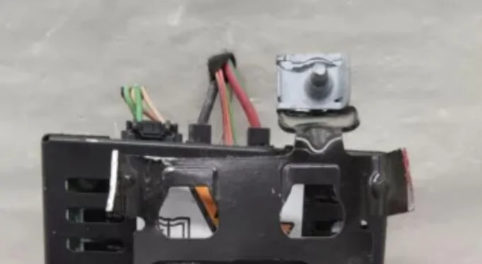

1. Open the panel below the steering column. I found a wire bundle taped to the side near the transmission tunnel with the two following connectors. I matched these against an inverter (68302053AE) pull from a gladiator on eBay.

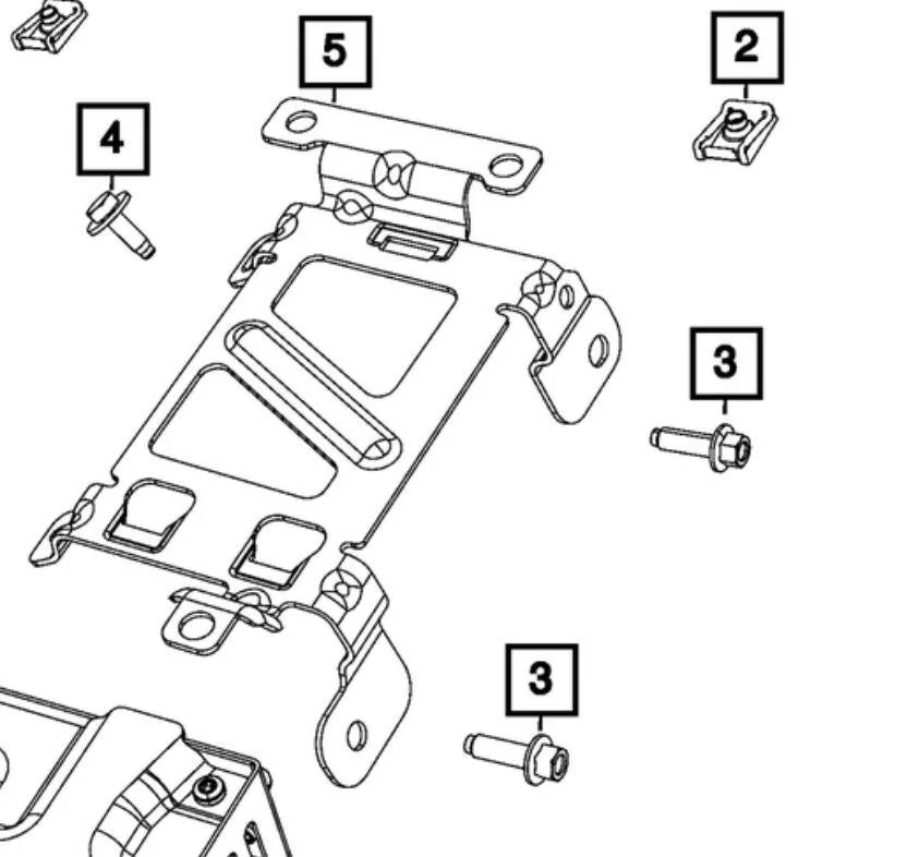

3. After confirming the wiring was available I ordered both parts, my bracket was cut (as seen in the image) but most of 68294415AA was present, at least enough for me to mount it with existing hardware I had that were 6mm bolts I ran a tap for in the lower part of the mounting bracket.

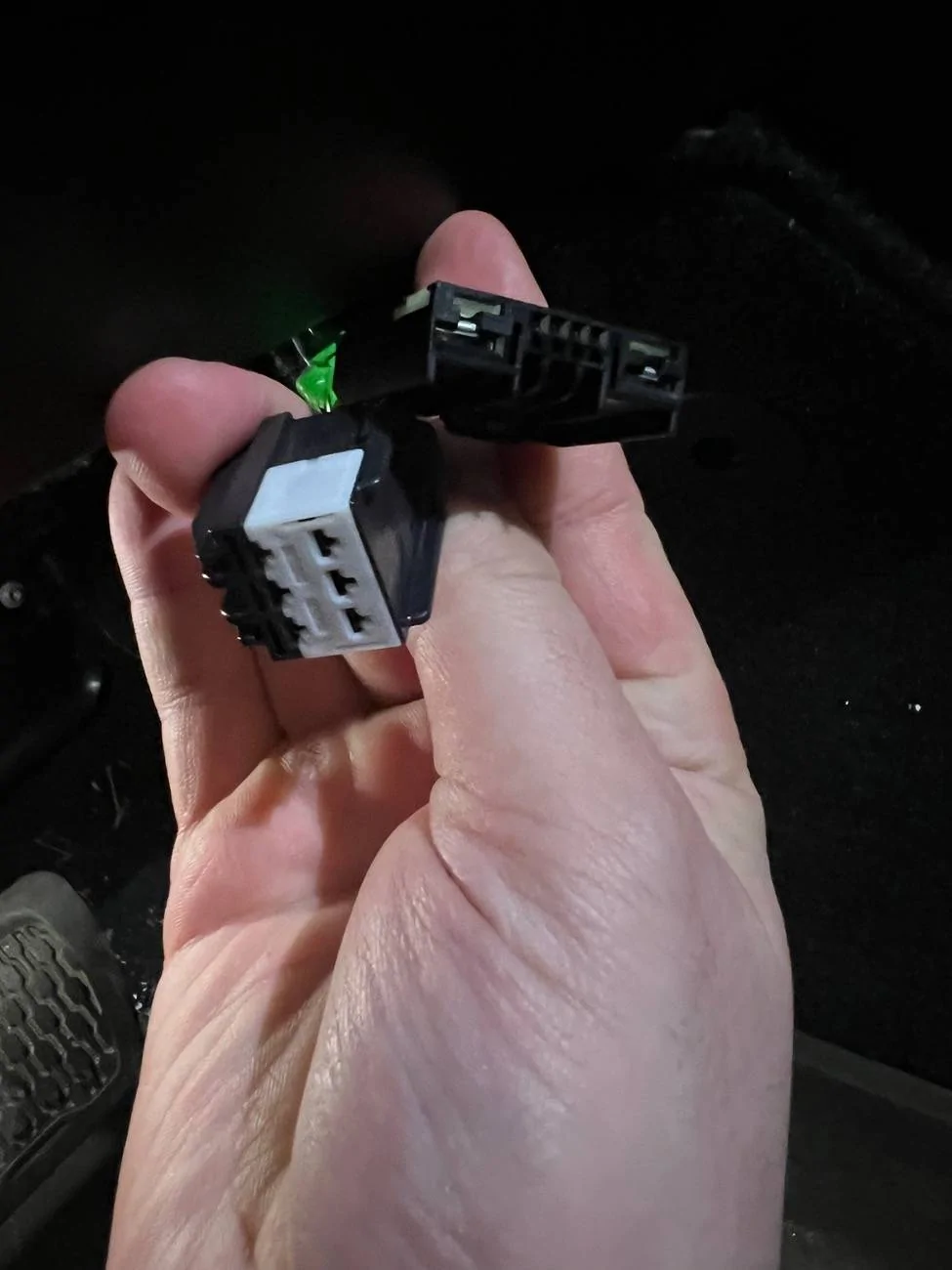

Thanks for the info everyone. I took a look today and I found this zip tied up near the lower part of the panel near the transmission tunnel. I believe there are the correct connectors needed for the inverter. Only issue I did run into is I can’t seem to find the connector that would plug into the outlet behind the center console. Any tips where it may have been tied off? I’m currently trying to look through the hole in the rear having a hard time

It was super hard to find on mine. Was fully taped so looked like a lumpy cable. I was working on another project so had dash parts removed, and it took every angle to find it and un-tape it.
My JTWD was part of the inverter delete covid times, so if yours was the same, I can’t imagine it’s not taped up there somewhere especially since you have the Inverter connections.
