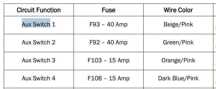

Nice, when using the AUX switch, do you also run the ground to it ?
ALSO
probably in the manual, trying to remember, isn't one of the switches rated a higher amp than the other three ? Is it 1-30amp and 3- 15 amp ?

I ran ground to a frame ground point.
Here are the factory aux switches -
