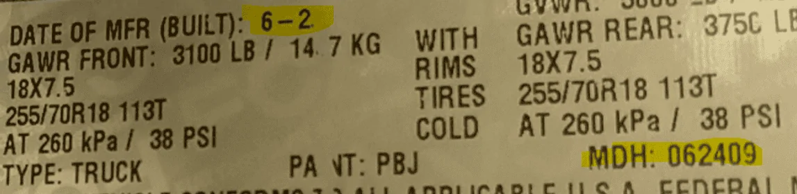

You'll see the year and month as well as the month, day of month and hour of the build (As MDH) on the door sticker.
That's your build date.
It will reflect the date and hour of final assembly.

My build date and hour correspond to F5 (062409 = June 24, 2022 9 am)

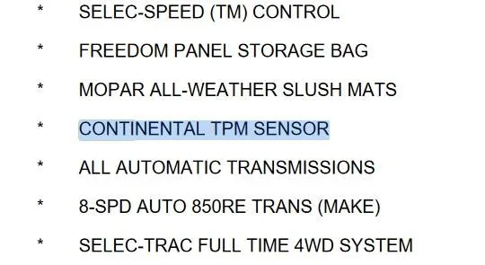

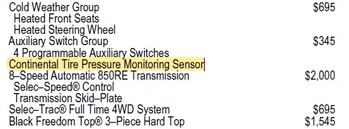

I think you have the old system. Like @ShadowsPapa mentioned, check the MDH on the door label and that will give the exact day of the month and hour built.
Generally around that time frame when they made the switch, they put "Continental Tire Pressure Monitor Sensor" on the window sticker for few months to denote the change,
Also the build sheet should have "CONTINENTAL TPM SENSOR" listed on your build sheet and I do not see that either.
https://www.jeep.com/webselfservice/BuildSheetServlet?vin=1C6JJTAG2ML587148
Below are pictures from the Window Sticker and Build Sheet from my 2021 Willys Gladiator that was a August 2021 build that had the new sensors. By 2022 model year, they would drop both of these indications off the window sticker and build sheets.

Yep, I figured out the date and time real quick just wanted to make sure the door is the one to go by. The bigger question was if June 7th builds were old or newer but based on your sticker info does seem to have the older system. Discount must of made a "mistake" and just happened to grab the older sensors or there is some witchcraft going on. :surprised:

Parts cut-ins are not always clean and sometimes there can be cases on either side of what service data says. Regardless, your build sheet should be gospel to exactly what you have.

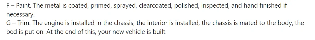

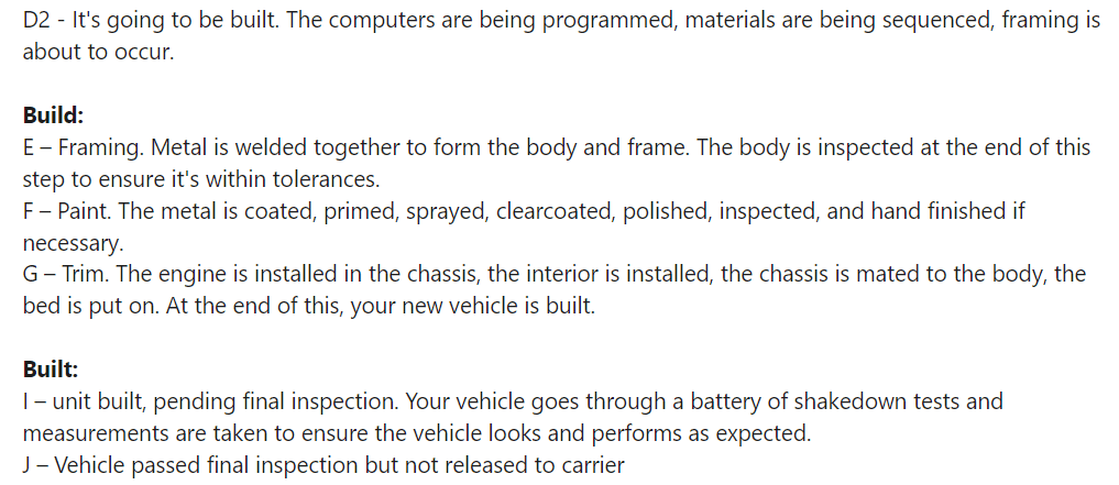

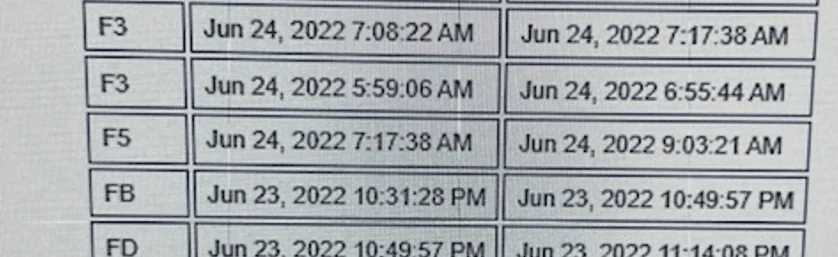

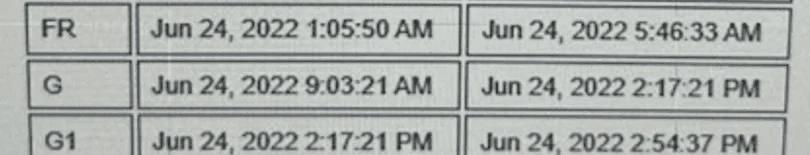

At the end of G, your vehicle is built -
Jeep Gladiator Of TPMS and Build Dates 1702601068731
My MDH is 6/24 9 am -
Jeep Gladiator Of TPMS and Build Dates 1702601141028

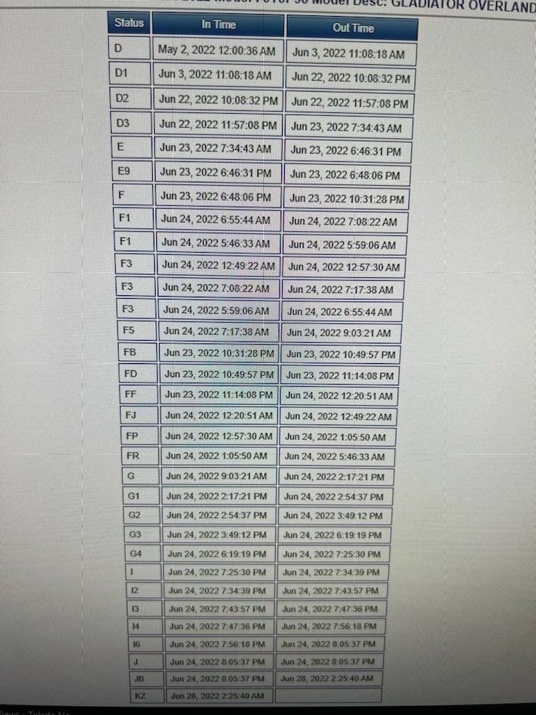

Mine went into G at 9 am on 06/24 - it came out of G at 2:17pm so took about 5 hours.
The below is the build sequence on my own 2022, so I know exactly when it went into each phase, and when it left each phase. Check the times listed below with the MDH on my door sticker above.
Jeep Gladiator Of TPMS and Build Dates 1702601115676
G is five stages, it went in at 9am and came out of G to I (built) at 7:25pm.

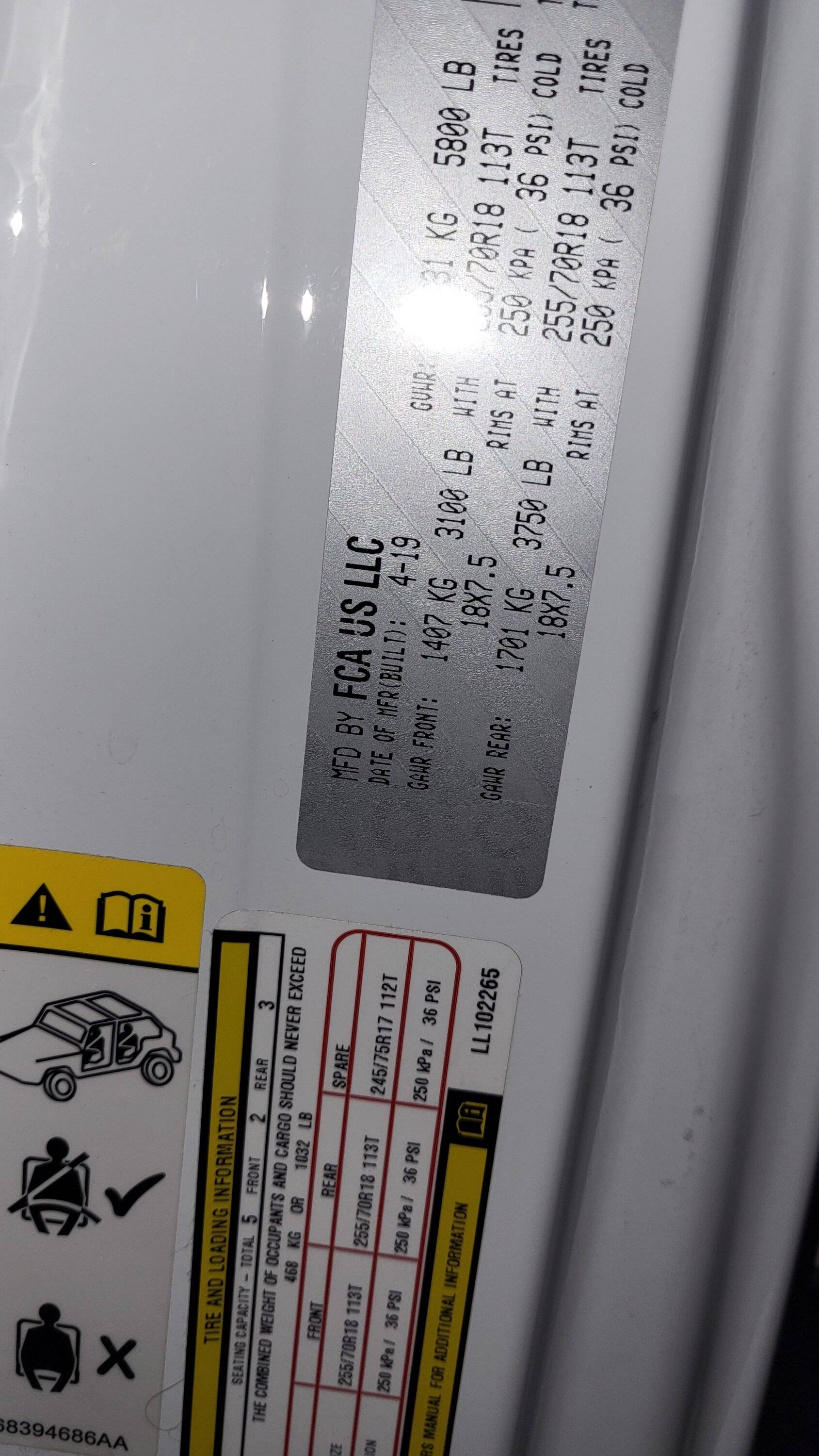

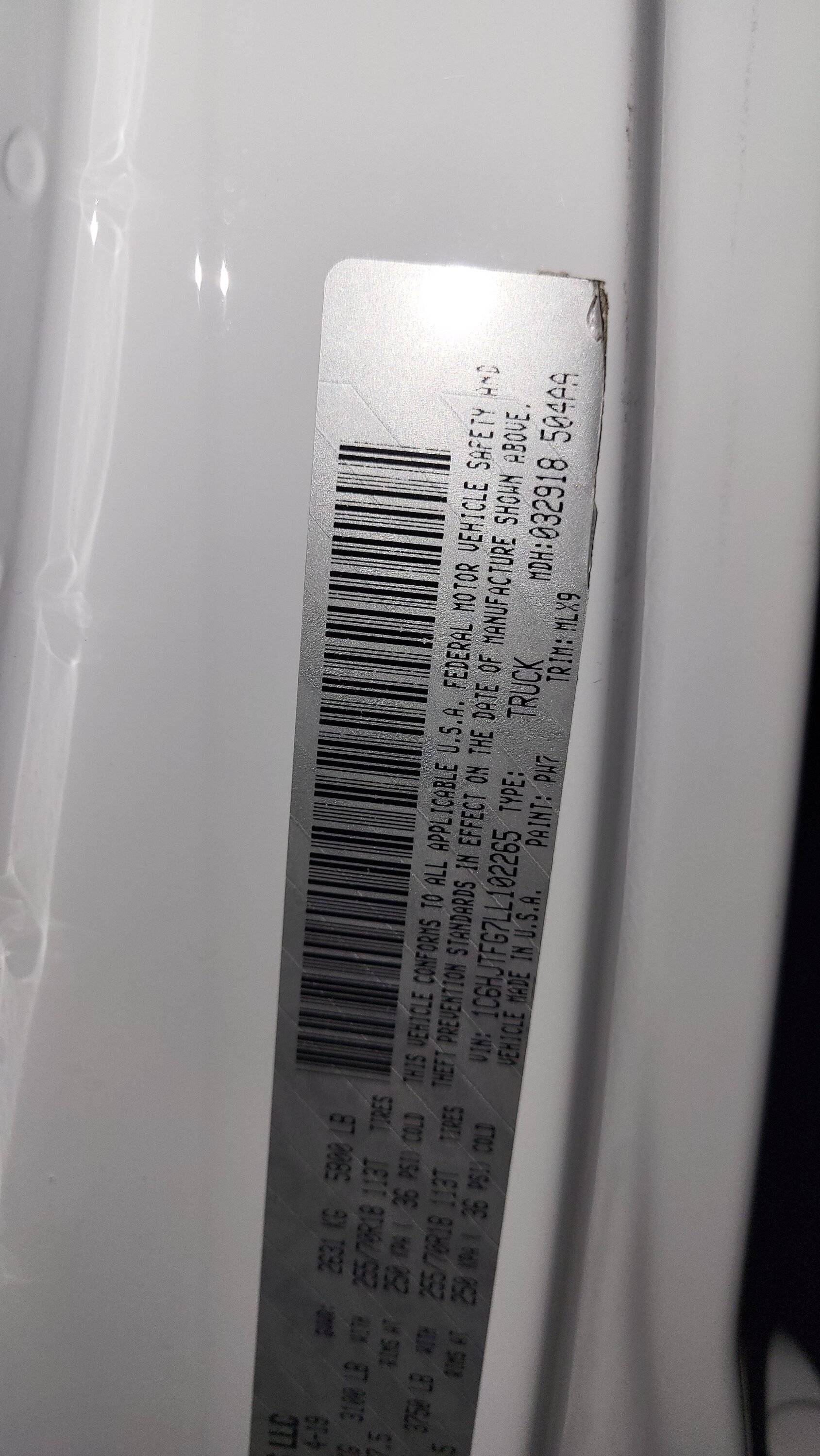

I don't have that list, since I didn't order it, but I do have the door sticker. It shows the build starting at 6pm on 28 March 2019, and a manufacture date of April 2019.
Yeah, missed the G2, G3, etc. that's the stages of drivetrain and other components mated to the frame. So it was a good part of a day. (9a-7p)
The parallel stages are interesting - body at the same time as G stages, then the body comes over to the frame area from the body shop.
It's really tough when they talk of things being before or after a certain date. If your vehicle is built on a date mentioned - there's a whole 24 hour period in there.
Once the modules are in place in the vehicle and the wiring installed, the TPMS sensors in the wheels must match what that body got for RF hub or TPM module.
In this case it says "if it was built BEFORE it got A and if it was built AFTER it got B - if it was built ON, you have to go by the build sheet, one could be early morning finish (say 7am) or 11pm finish time.
During that day it's bound to be a mix.
