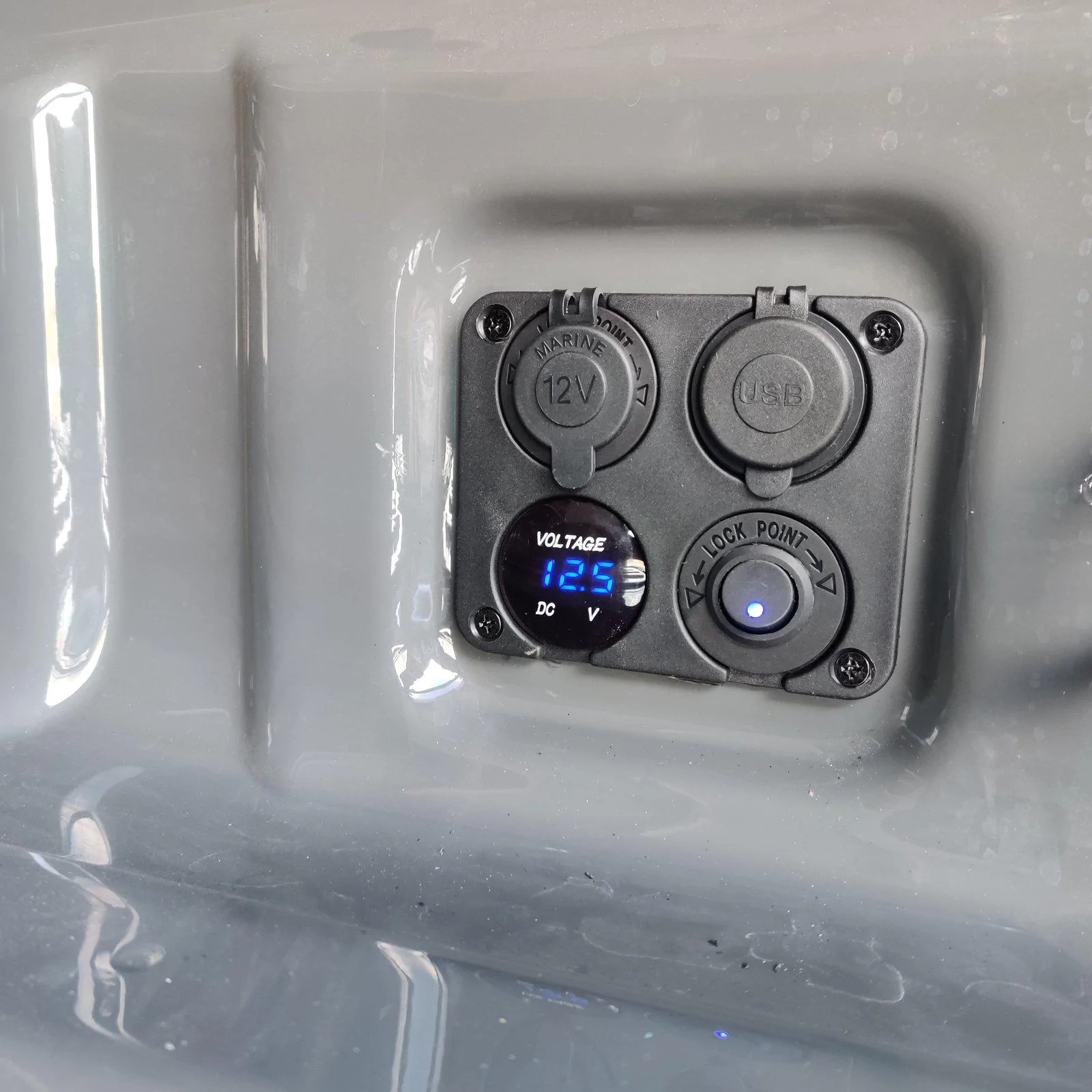

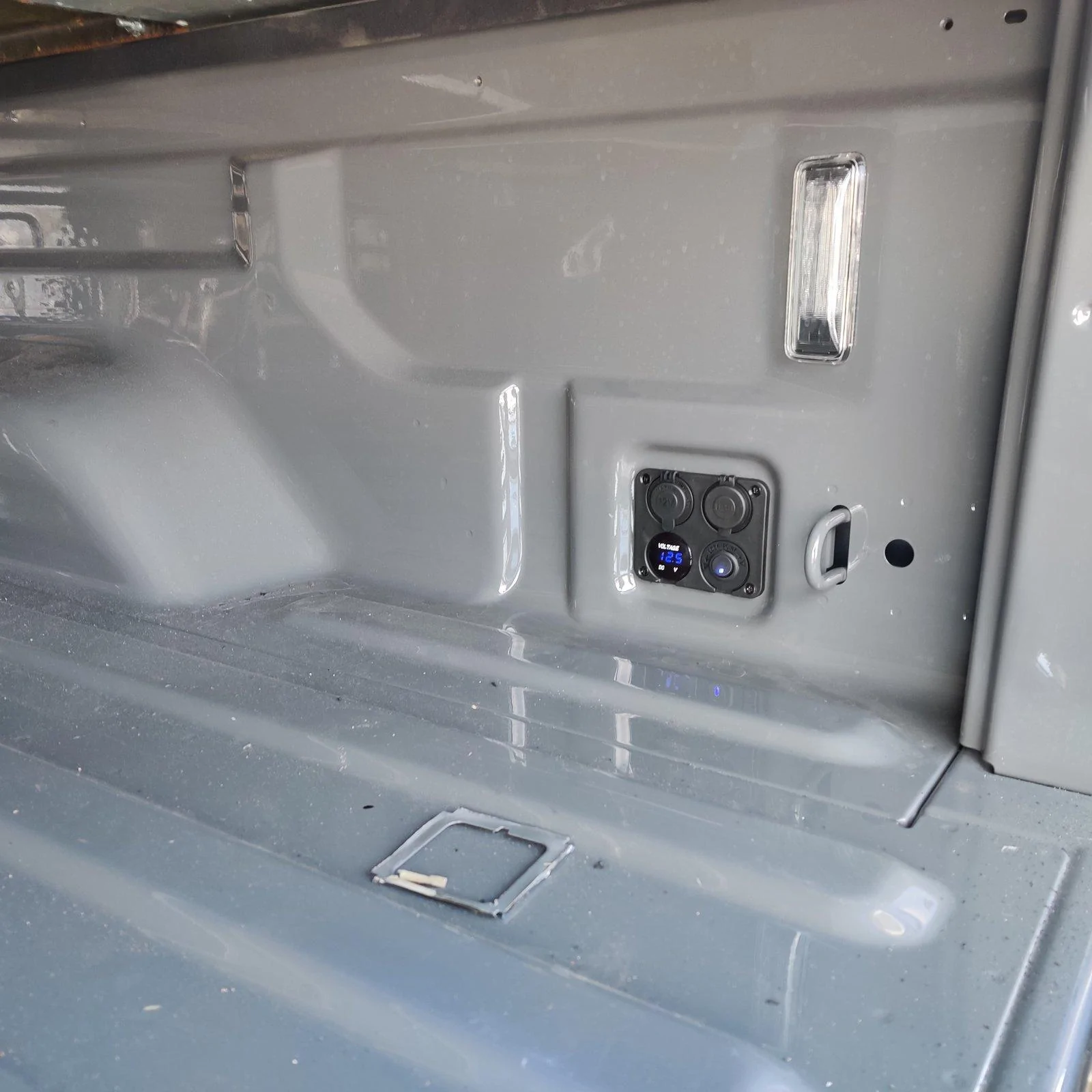

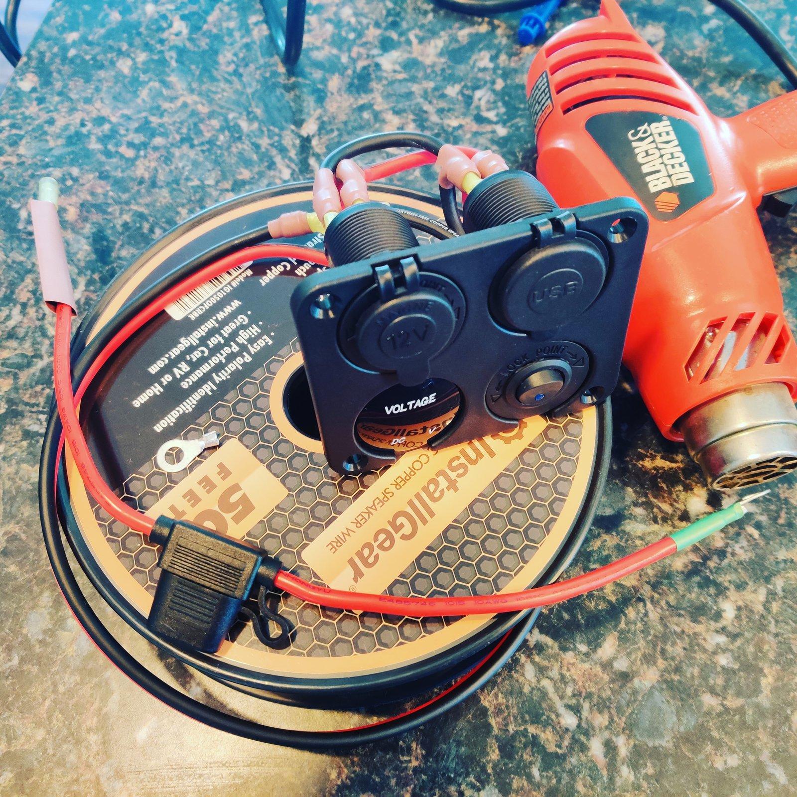

Any chance you could do a write up on how you ran the wires? What gauge etc?
For the distance you want 10ga.
When you pop the cover off there are four square holes that the factory inverter plug screws into. You need to cut out the hole to outside of the holes to fit the plug. Some trimming of the thumb screws that hold the plugs in is required to fit this new enlarged hole. That piece cut out is in the picture above.
After that it's just a matter of ziptying to the factory harness that runs toward the front of the truck and following it to the battery. Here I used ring terminals to hit the main battery and one of the grounding studs near the fender. Used a 40amp fuse near the battery to boot.

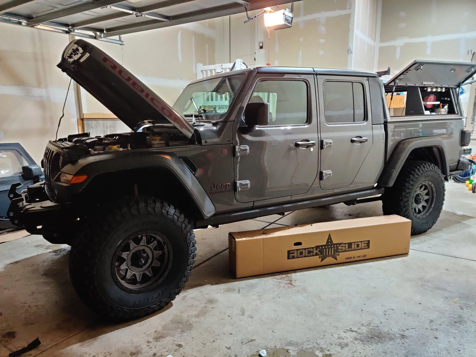

RSE slider steps going on shortly.

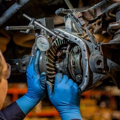

4.88 gears going in at Axis Driveline near Salt Lake. Get her back in the morning.

Well I posted a video about how well it worked to our YouTube channel just a few minutes ago. Added some metal cloak diff covers too. Check it out let me know what ta think about my opinion of the regear.
