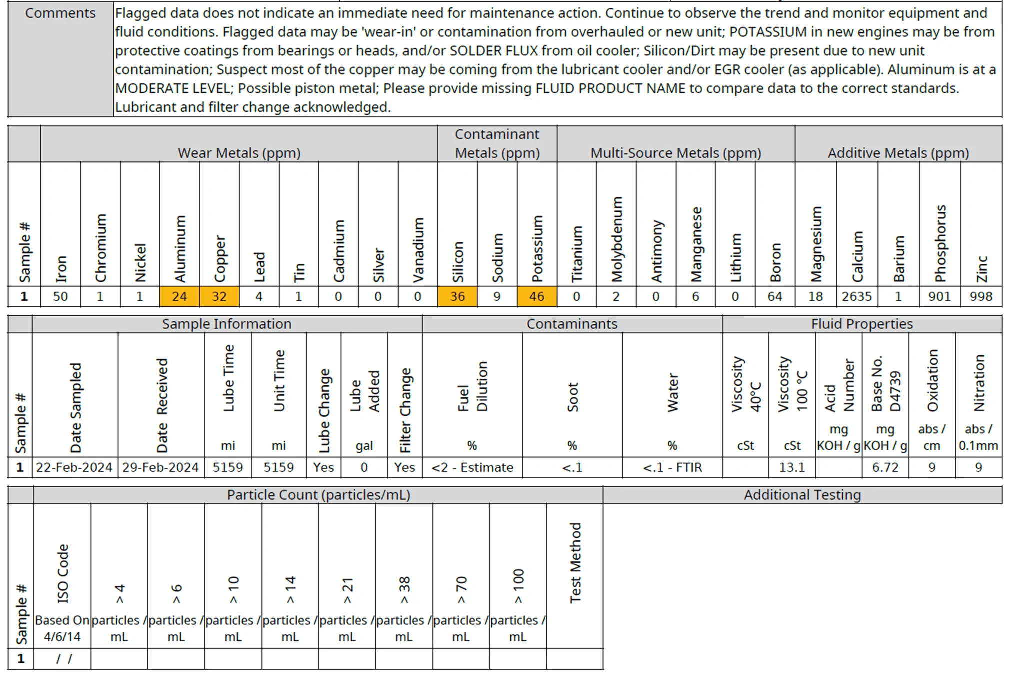

I do plan on taking samples at each change to document the engine and see how long we can get it to go.

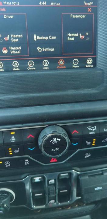

Other projects I worked during Jan and Feb was adding factory heated seats and 7 inch Uconnect to my wife's JLU so she will drive hers instead of mine. 3 weekends and about 7 hours of time to complete... of those hours 2 on dash wiring, 3 on taking seats apart and adding elements and the last 2 were cleaning up all kinds of crap the boys had let slip under the seats(lots of french fries, gum wrappers, candy etc) and then washing the carpets.
BTW Factory seat heater elements under cloth bucket seats heats up so much faster. Usually end up turning down to setting 2 or 1 when using heat for back pain.
Yep , love my heated seats... I've had multiple surgeries... hell I even use it in the summer... lol
I plan on doing an oil analysis as well. I just didn’t see the need for the first or maybe even the second oil change. So I will either do it on the next one, the 2nd around 10k (I'm @ 8K+ now) or wait until the 3rd change, somewhere close to 15k.
I would need the expertise of the forum to decipher the results when I do... lol

If you go with Blackstone. They will tell what is going on and make sense of the numbers for you.
Rus,
Good looking out , thanks.
I did plan on it. They seem to be the most popular on the forum. I have a couple catch bottles from them, so I'm set when I get ready.
