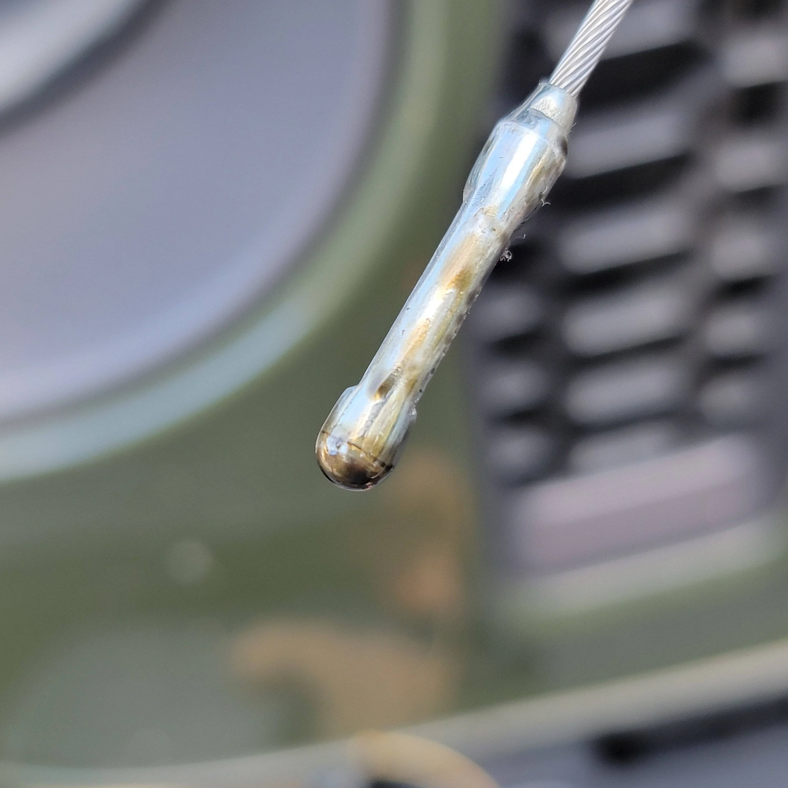

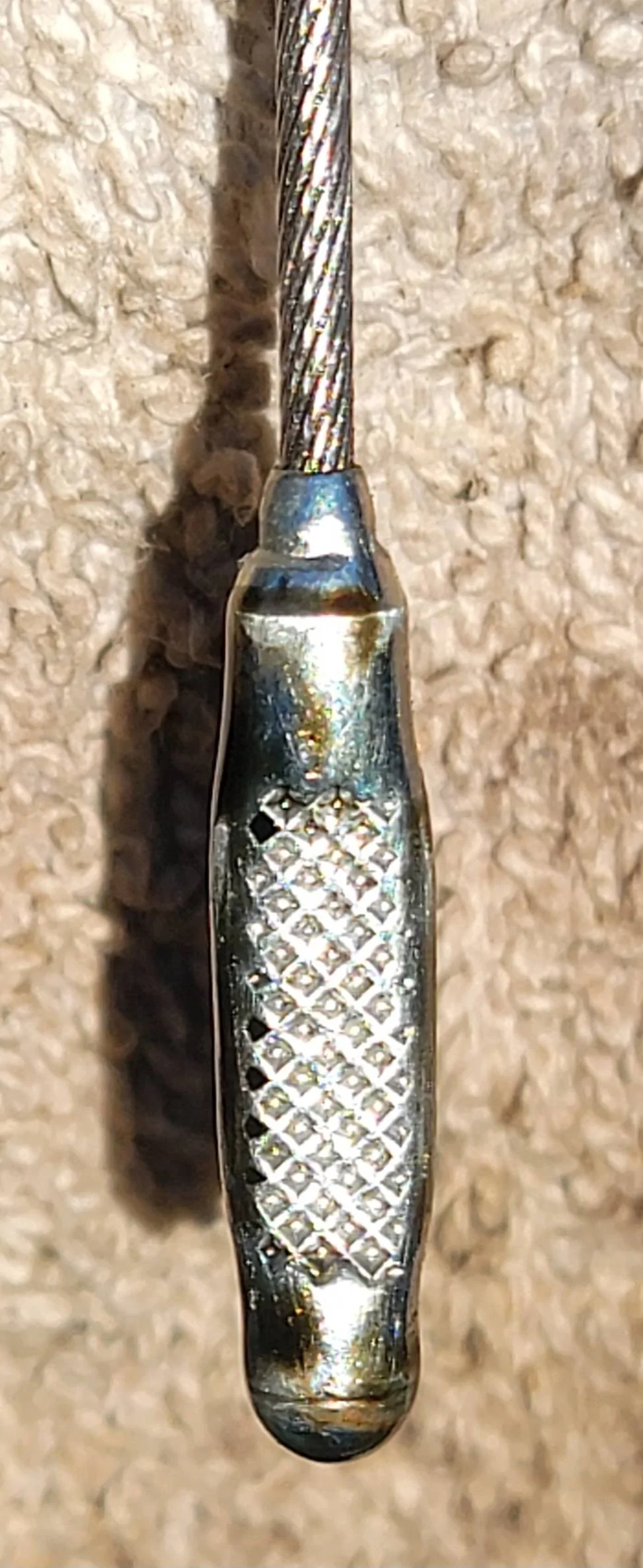

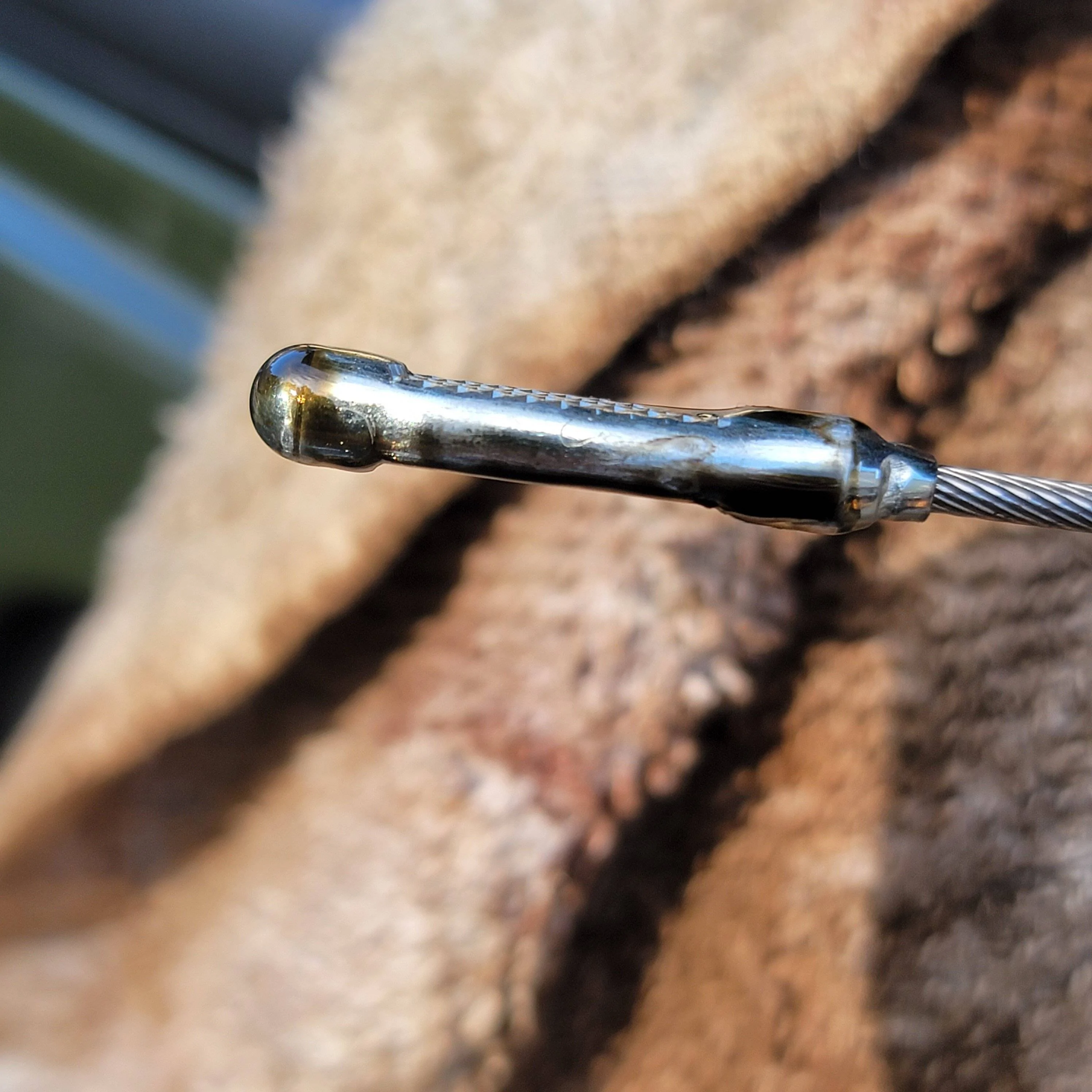

Yes, I know this, I was just trying to take a pic that showed the oil barely touching the bottom of the dipstick. I appreciate your feedback though. Thanks
My point was showing the dipstick from the side doesn't give anybody an accurate picture of the oil level. In your pictures I can see evidence of oil extending most of the way up near to the cable portion of the dipstick, not just barely touching the bottom, but again this can be misleading as oil on the sides of the dipstick tip can be picked up from the inside walls of the tube above the level of the oil in the pan. Showing the flat crosshatched portion would reveal whether there is or is not any oil present within the safe zone.

Fellow JTD owners...
Do remember what your oil level was right before your first oils change ?
I'm at around 6k miles, getting ready to change my oil for the first time. ( still debating doing it myself or taking the Jeep Wave freebie)
I checked my oil and it appears to either be at the dipstick level or it's barely touching the bottom of the dipstick.
I'm not a master mechanic... but from my understanding is a new engine will use oil during the initial break in... first diesel... so I seek advice.
So is this normal, did you guys experience this. I did check for leaks, everything is bone dry. I've never experienced any issues and the vehicle has been driven relatively easily.

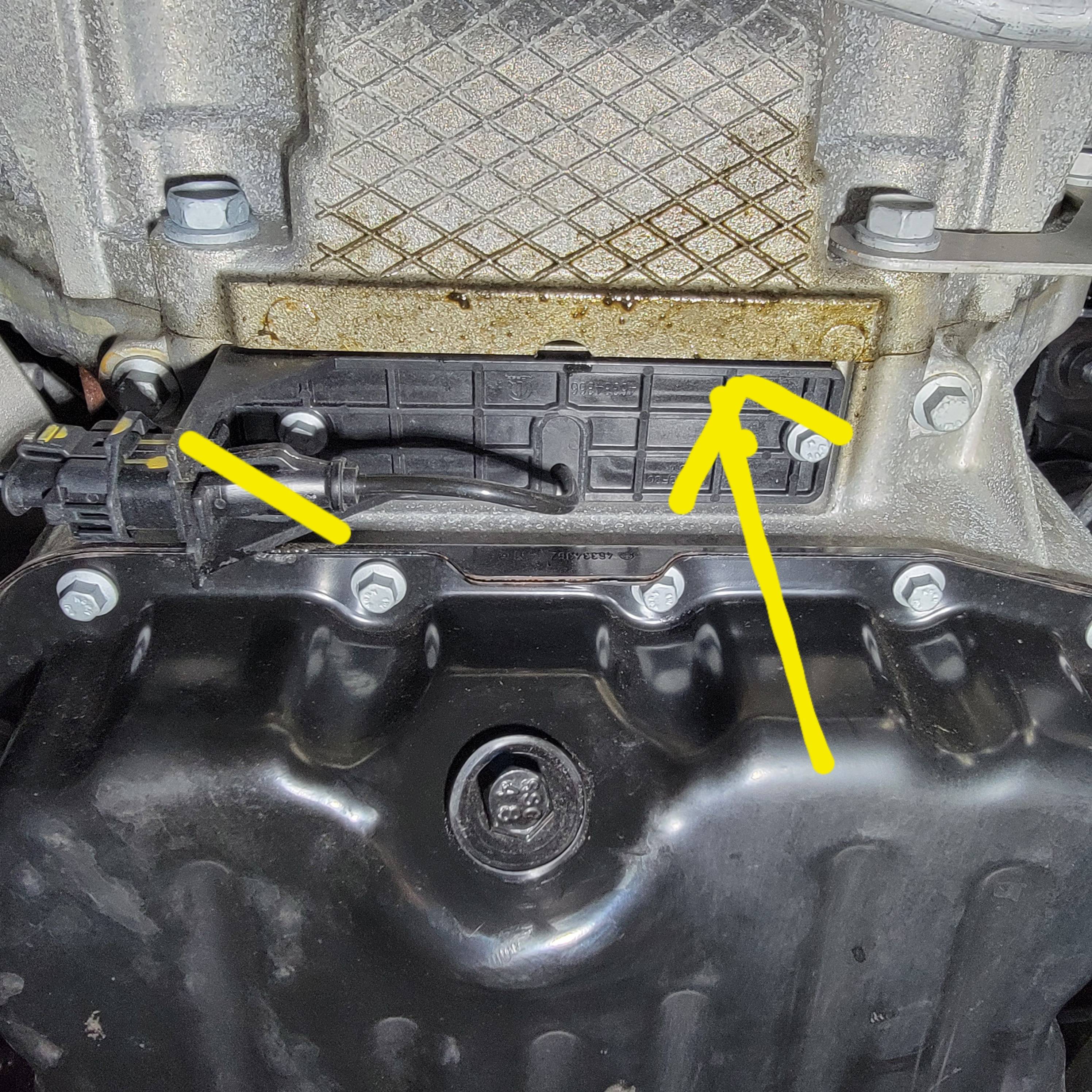

I noticed this leak afterwards, but I don't remember seeing it before. Can someone please tell me what part this is ? Looks like a heat sensor to me....
but
could changing the oil even cause a leak here ?I looked for oil spill from filling and any that might have spilled from removing the oil filter, but I didn't see any and I really dont think it could migrate to this location...
(I plan on cleaning it up tomorrow in the daylight, I will check to see if it comes back.)

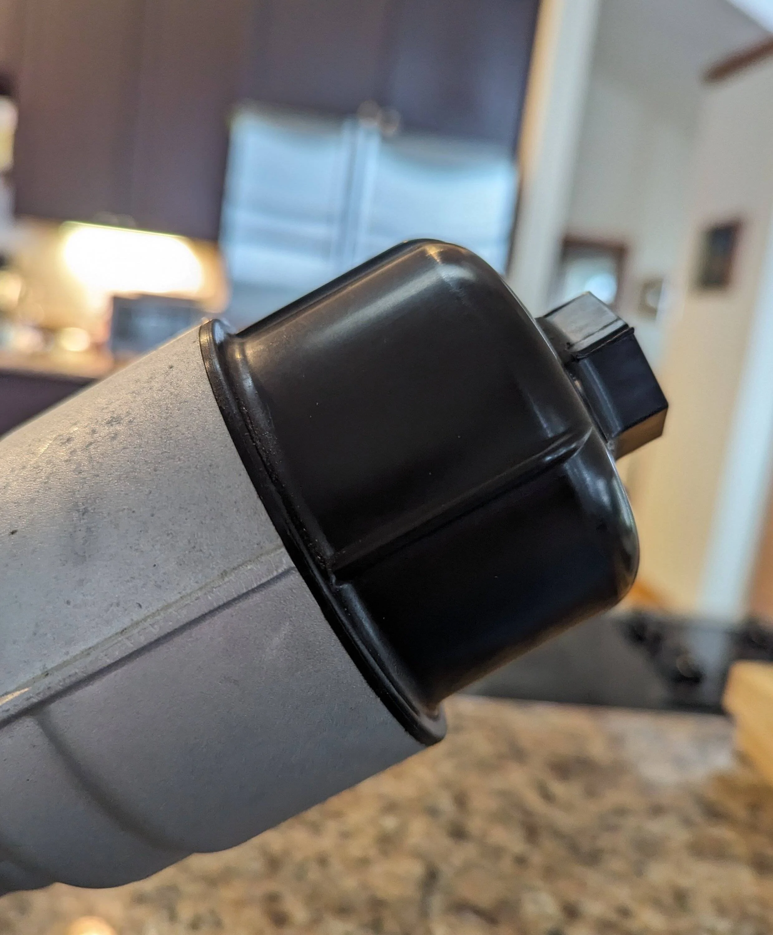

Sarge,
Kinda hard to get a picture with it mounted on the engine but here is a picture of the filter/cooler assy with oil filter torqued on at 25nm that filter lip is now resting on the filter assy. Hope this helps.

Thank you
When I did my first oil change, it was taking way more torque to get the oil filter lip flush with the housing.
The threads on the oil filter are so coarse and sharp. I put a little high-temp grease on the threads and it went on much easier. I used a digital torque meter to tighten it up. I have since purchased a torque socket... I will try it next time. But honestly, once the oil filter is seated, its practically at the proper torque anyway... it doesn't take much to tighten/get it there.
