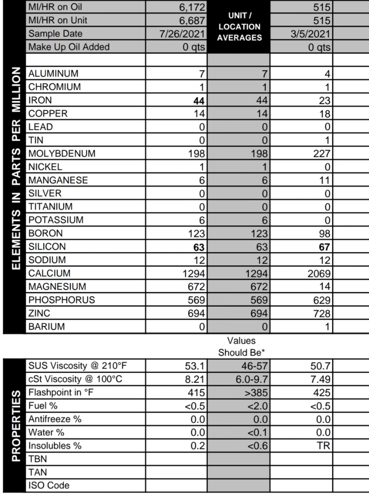

I changed my oil at 500mi and again at 6700mi and had the samples analyzed at blackstone to see how the engine is breaking in.
Jeep Gladiator Question first oil change. Screenshot_20210810-130942
Wear was definitely accelerated in the first 500mi, but the levels aren't alarming in either report. It's worth mentioning that there was no towing in the first 500mi and the truck is pulling something behind it about half the time after that.
I also cut the filters open on both of these oil changes and have found a surprising amount of debris in them both times (first was significantly worse than the second). It mostly consisted of yellow paint particles and small specks of aluminum. If nothing else, I would suggest changing the filter on a brand new motor within the first 500mi since it's such an easy job.

Yes, with the caveats that your filter will last that long and most manufacturers recommend you change your oil every 12mo regardless of mileage
Yup - every year regardless of miles. That's due to the sludges and acids that built up. I have 2 oil pans up on a shelf that have small holes in them - eaten from the inside by the acid in the oil. Obviously the owner of those engines didn't drive them much and changed oil even less.
I don't like the crud sitting in there so it gets changed. If driven right to avoid moisture and acids shouldn't be a problem, but I'd rather change the oil than see etched parts like I've seen over the years.
The yellow likely from inspection marks. I bought a NOS (new old stock) Jeep engine from Edelbrock years ago. They obtained it to use on their dyno as part of a performance manifold project that never saw the light of day. There sat that brand new engine under one of their work benches. An employee friend put it up for sale - highest offer buys is. I didn't have hardly any money but offered 200 bucks. After a week the guy said it was mine. Got it home and took the pan off as I was going to use it in a rare Eagle I had here - and had to swap on the Eagle specific pan and oil pickup screen. The rods were each marked with painted inspection marks. So were some of the other internal parts. I have photos somewhere as I thought - how many people have seen the inside of a never installed in a vehicle engine.
There was also some casting flashing.
Since by the time you tear an engine down few if any inspection marks remain one must figure with the heat, oil, and other conditions in the crank case, those marks make their way into the oil (and filter)
I ended up selling the car and selling the engine to a guy who was restoring a Jeep. He got a brand new complete engine for a grand - the exhaust still had the original shipping tag on it.
