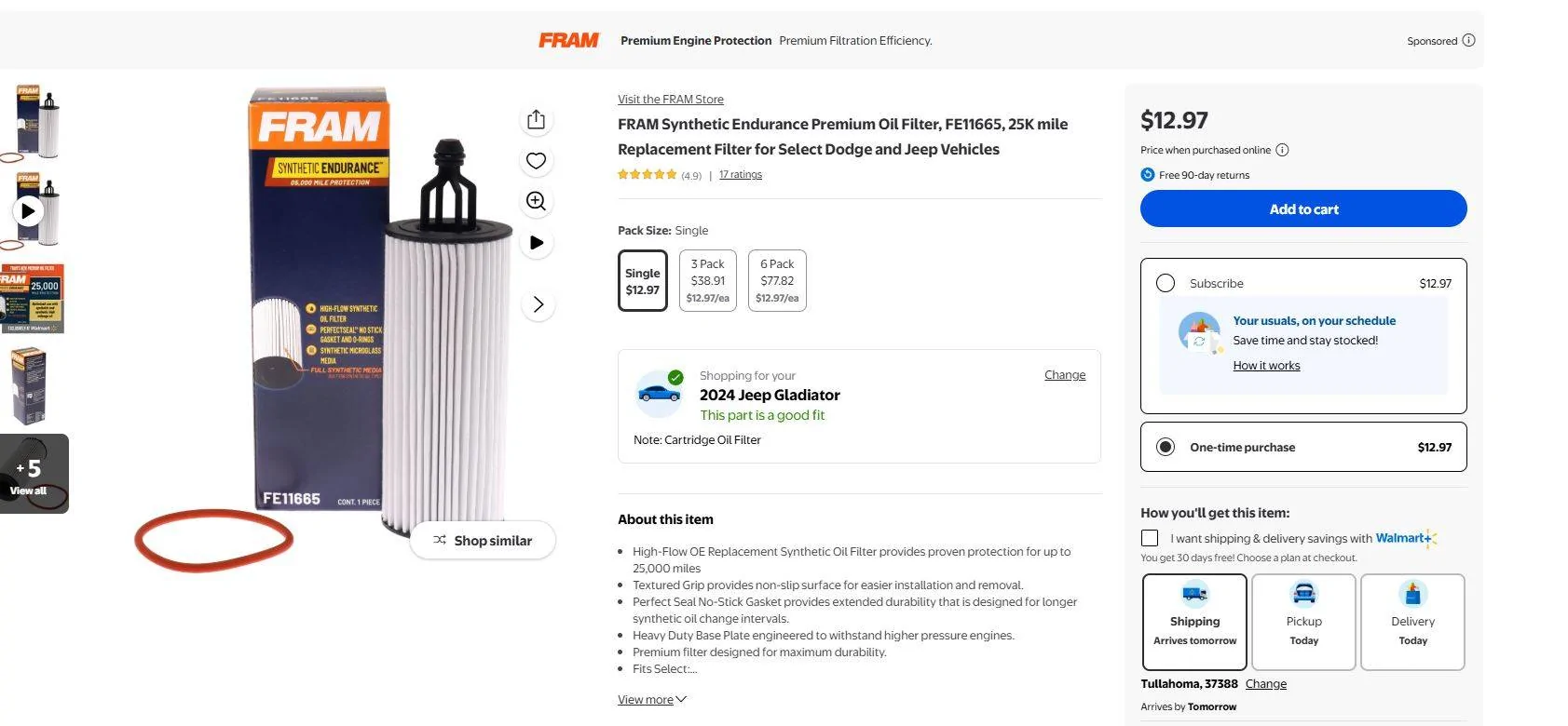

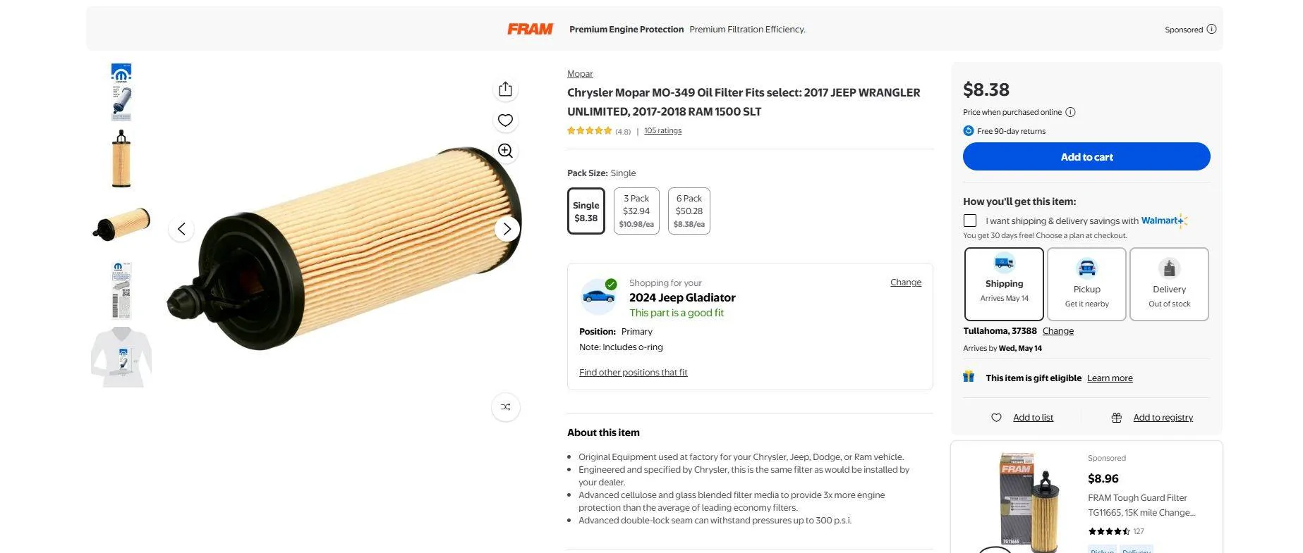

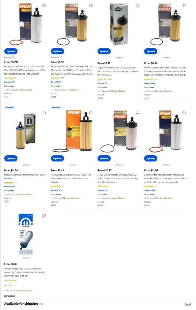

I've actually been using the Fram Synthetic Endurance, which are more $4 more expensive than the Mopar filter at my local Walmart. I compared them, and the filter media seems better on the Fram than the Mopar.
The subject of this thread (and subforum) is the 3.0 ecodiesel... different oil filter entirely.

Please disregard anything I said. Completely irrelevant.
Don't worry about that, I did not notice that was his vehicle either and I appreciated the filter comments made for the 3.6.

No need to jump directly to "ignore everything I said" mode, I just don't want to see some diesel owner get the false hope that there are truly cheap filter options for their 3.0L readily available at their local Wally World due to a misunderstanding.
