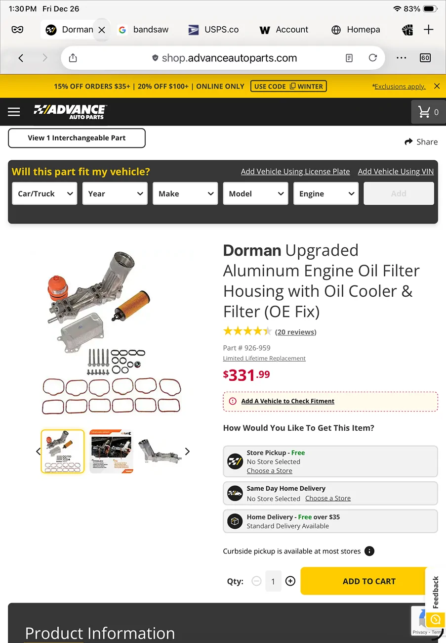

I just had my oil cooler housing on my Ram replaced with an aluminum housing and pressure sensor from Dorman. The part number for the pressure sensor listed on my receipt is 926-188. $57.99 at shop.advanceautoparts.com as of 12/26/2025. I have no history with it yet so can’t speak to quality or longevity, but the mechanic says it’s all they use.

The plastic body of the original oil cooler had warped and was leaking. Dorman makes an all aluminum replacement housing (on my invoice it’s called an engine oil filter adapter part 926-959). It’s on my 2015 Ram Promaster van that apparently shares this part with Jeep. Part of the upgrade included the engine oil pressure sensor (926-188), engine oil coolant temperature sensor (part 926-427) and newer type filter.
https://shop.advanceautoparts.com/p...hQbGXVxRP0VyGaHtlE-UZlt090GYMvERoCsSsQAvD_BwE

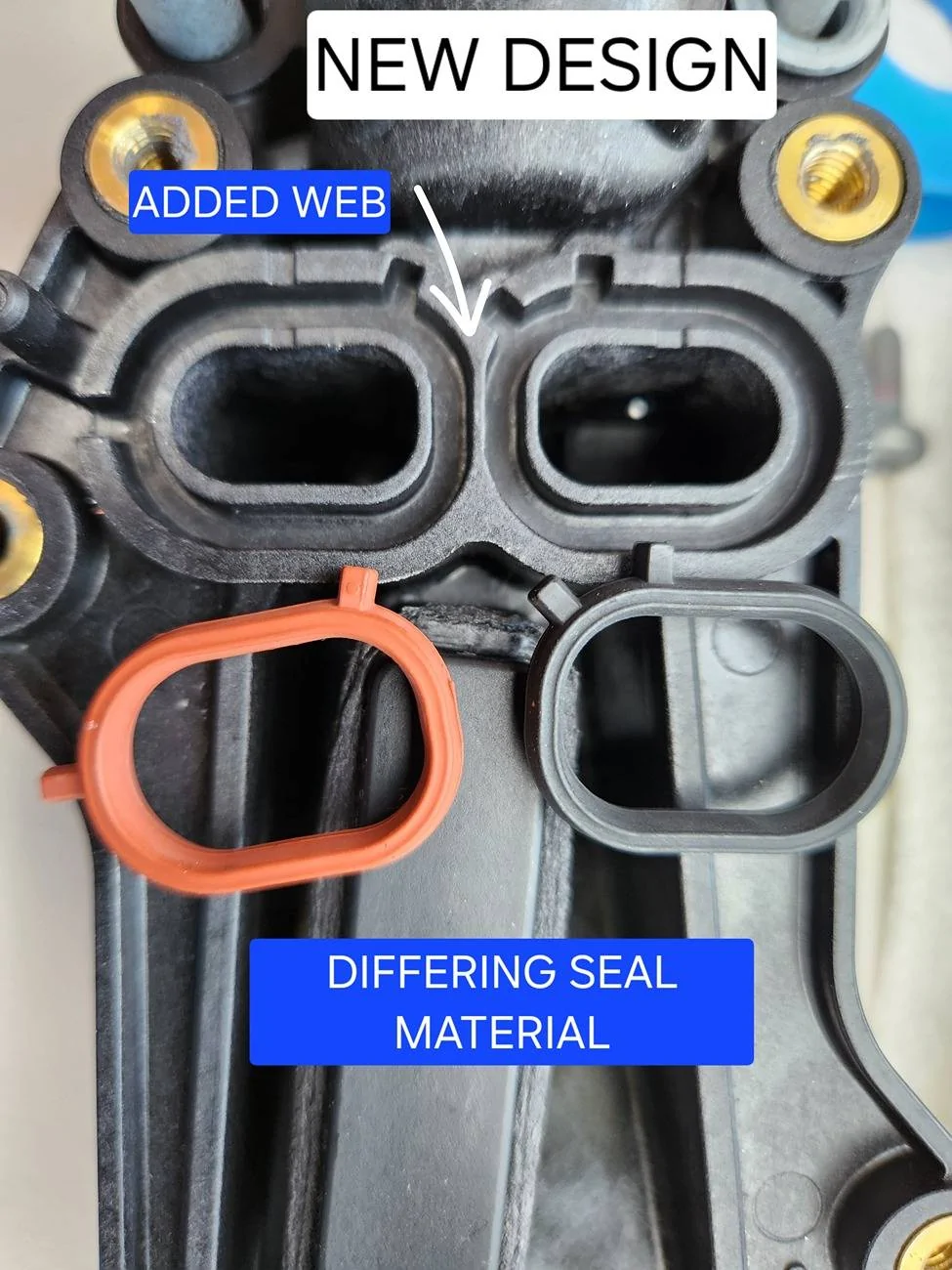

Do we think the new Mopar Filter fixes the issue on the old one and may be superior to Dorman? - I want to change mine as I want my Engine to last my lifetime, and I feel that I am leaning on the new Mopar one.
68596318AB
Jeep Gladiator Oil cooler swap now CEL - oil pressure sensor p0520 1000003099-1
68596318AB
Just did this on my JK and I used the upgraded Mopar plastic housing instead of the aluminum dorman that still uses the figure 8. The most common leak is the seals as long as you do your own oil changes and don't over torque the housing.
