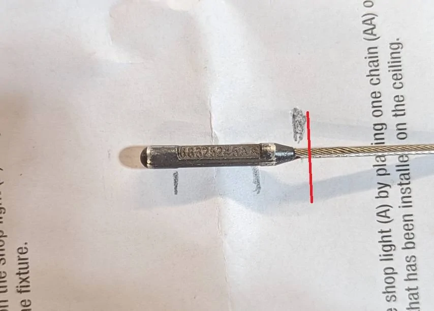

Here's pics of the dipstick from my current 2022 JT (keeping in mind I also had a 2020 and it always followed exactly as this one as far as oil level/dipstick readings)
Mine typically reads almost as far right as the red line here. When full, shortly after an oil change it will read pretty much to the red line. I've never seen it into the right-most pencil line and it's certainly never read onto the "flats" of the lower portion of the dipstick. My 2020 may have read onto the flats after 5 or 6K miles but that's as low as I've seen.

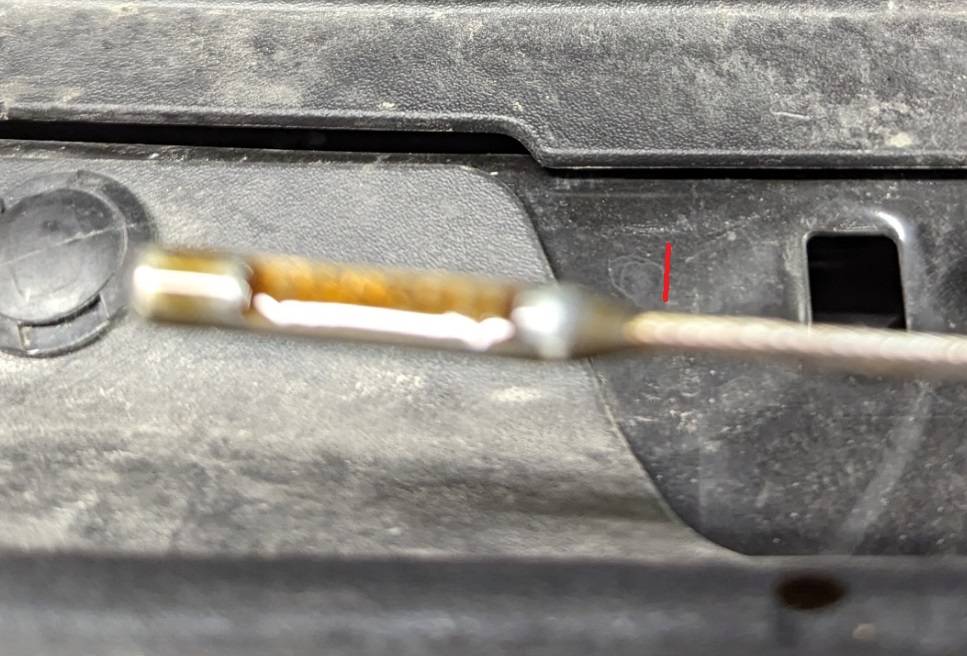

And this is today - 3,500 miles and after pulling 4 ounces out for an oil sample.
Jeep Gladiator Oil level rising PXL_20230621_143454113
3,500 miles, 4 ounces taken out.
So it's 5 x 32 ounces per quart for a total of 160 ounces, minus 4 for an oil sample, it's sitting at 156 ounces or 4.875 quarts in theory.
It's still just above the taper on the lower part of the dip stick.
If this followed through to its logical conclusion and I do an oil change at 5,000 or more, I'm looking at never adding any oil between changes. That's how my 2020 was as well.
I suspect these sticks weren't properly calibrated after the engine's pan and oil cooling system was redesigned for 5 quarts in the JT.
Many dipsticks that are flat have a twist in them so it doesn't "wipe" the inside of the dipstick tube going down and back up to allow a more accurate read. Always read from the lowest dry spot on the stick, not the highest wet spot - but I bet 101% of all people here know that anyway.
