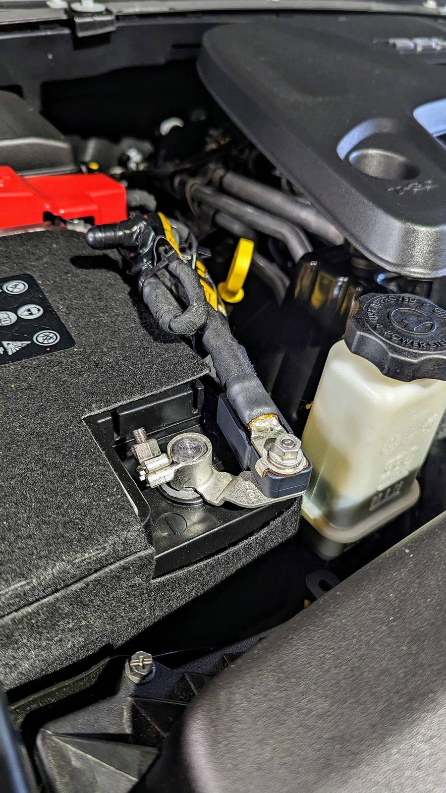

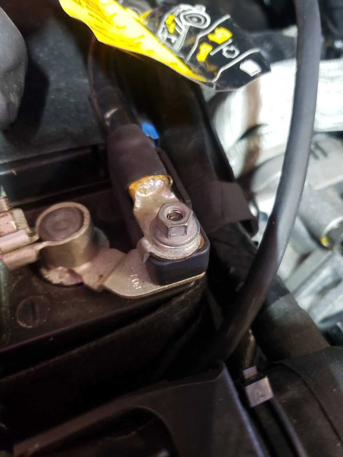

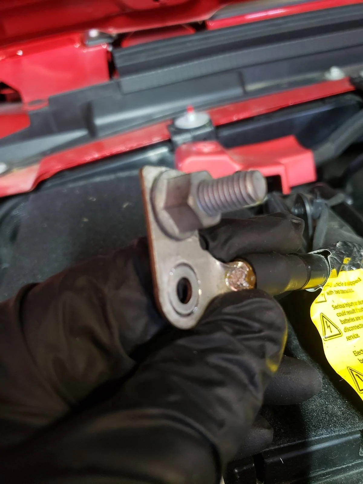

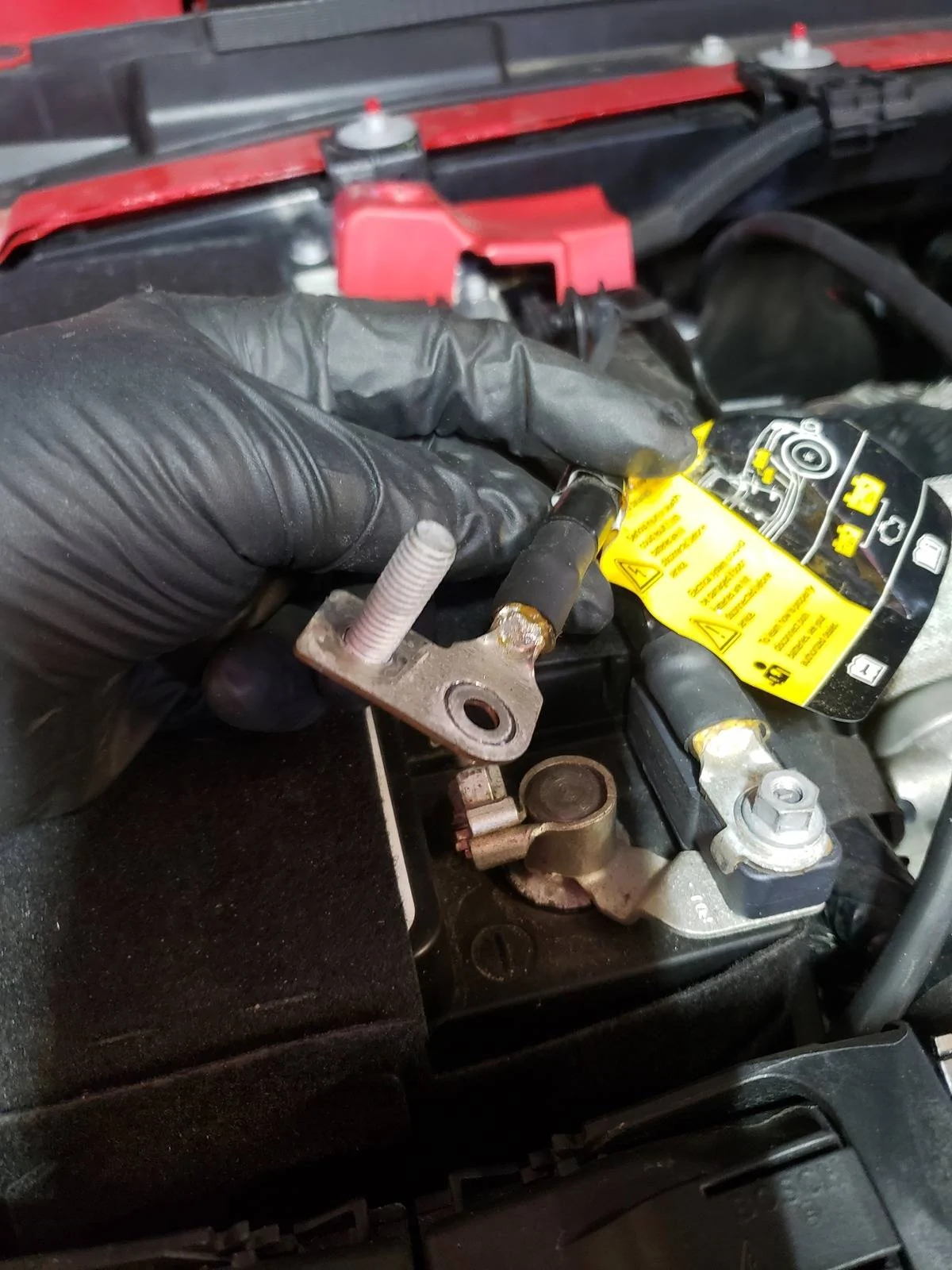

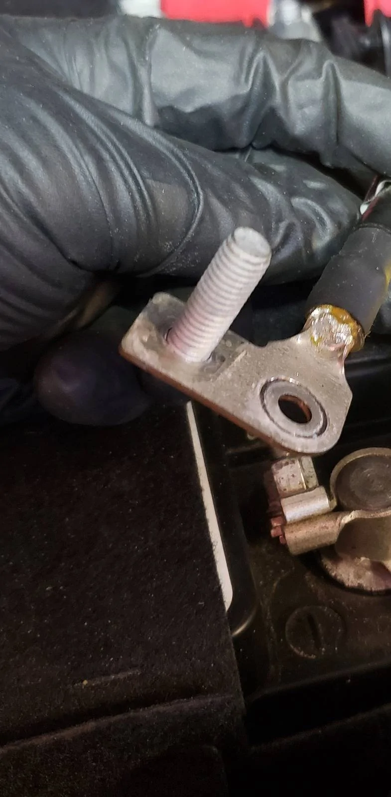

Ok, so im out here doing the disable the aux batt thing ive read on here. So there is one heavy negative cable and one smaller, but the terminal is not a separate deal. I took the smaller one off which has the terminal for the heavier one integral w it. So i put the heavy one on the remaining small stud and used a washer to provide better nut retention. Then pulled the #42 fuse. Everything seems ok. Here are pics. So you can see the small cable has the larger stud made into it so i have no choice but to remove it and use the remaining small terminal to relocate the larger main ground.
I dont really like this set up, maybe there is a replacement multi terminal for the neg batt side? Maybe a marine/rv type?

Ok, appreciate the feedback, disnt seem right. Im gonna source a larger multi stud batt terminal and make it back better

Just remember everything needs to go on top of that IBS otherwise the computer won't understand loads correctly. Don't be putting anything to the post under the IBS.

Really, didnt know that either..well then
