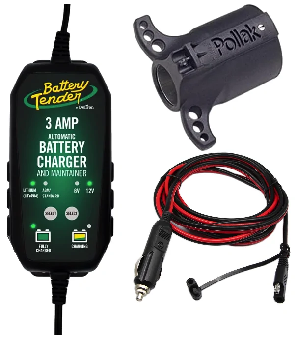

How to fix this? Run a battery maintainer (trickle charger) at night.
Y-Guy
Steve
Dec 30, 2022
2,482
11,332
E. Washington
2025 Gladiator Mojito! Mojave X
That's what I do. Started it a year ago with my 2020 Gladiator as starting was becoming belabored and I figured it would get me through the winter before I tackled replacing the batteries. Worked so well I kept doing it and now do it once a week with both my 2025 Gladiator and my wife's 2024 Wrangler. Here is what I use. Here is a thread on the subject.
Jeep Gladiator Cold weather, no remote start, aux batt delete Battery Tender Jeep Charge Setu
