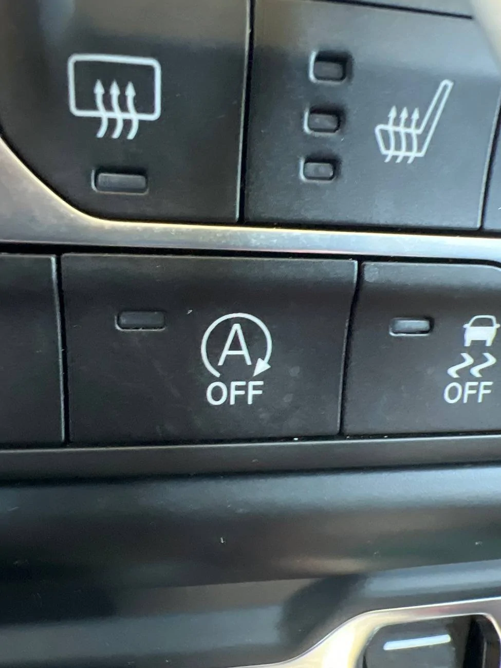

Did the aux delete, used Tazer mini to perm disable ESS.
Pulled fuse 42.
ESS Avengers button stays lighted all the time(off), good.
What happens if I push the ESS button now? Does it reactivate ESS without the aux battery or what?

Copy. Is it an issue? Like can it cause issues? Asking as I had someone driving the other day and they inadvertently hit the ESS off button.
Just asking if it can cause an issue without the aux batt connected.

Tazer did not disable ESS. It allows ESS to remain in the last state that you have selected on future restarts. Push the button ESS will/should work. If not, you have an issue and not related to the aux battery. Assuming you deleted the aux correctly and just not pulling f42.

Having ESS on without the aux battery can cause a voltage drop during ESS events that might trigger your computers to reboot, essentially leaving you stuck in traffic until you can completely restart the truck.
Long story short, don’t turn on ESS if you don’t have both batteries. Might it work just fine? Yes. But now you run the risk of getting stuck.
