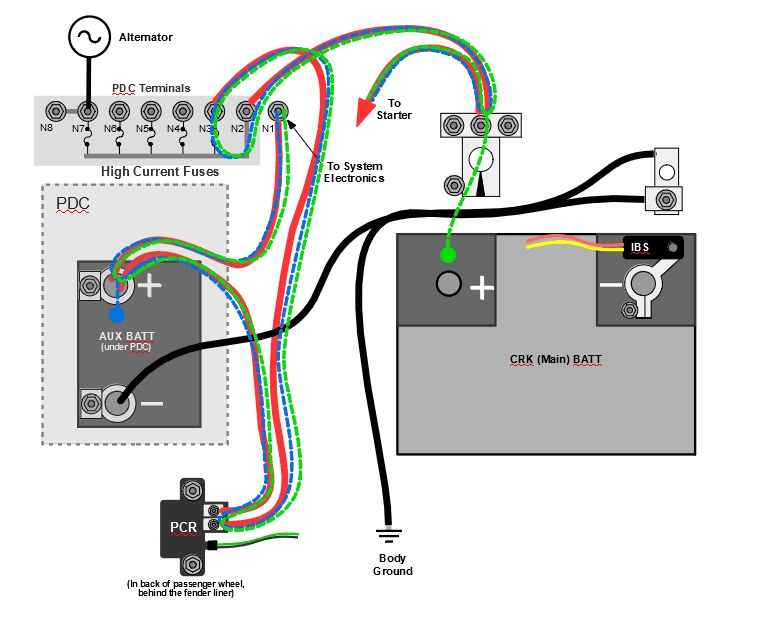

So there’s been 2 occasions that someone has had to mess with my battery(s) on my JTS
1. When the shop installed my front locker. They also damaged some wires and paid for the dealership to fix it.
2. When the dealership fixed the wires that the shop damaged.
That being said, recently I removed the Aux batt and the F42 fuse. Everything has been working okay until yesterday. I lost all power, dead!
I started looking around and noticed the main batt + terminal was loose. I’m sure that’s my fault, I removed it while removing the aux batt. I tightened it and still nothing.
Then I noticed that N1 on the fuse box was loose and sparking while I was moving it. I tightened it up and all power was restored. That’s when I thought I remember N1 should be dead if no aux batt is installed.
Am I mistaken or is N1 where I should only see voltage from the aux batt not the main batt?

No, N1 should be hot because the main/crank battery and aux battery were connected in parallel. That means that unless you remove all of the cables and PCR from the aux battery area, the main battery will still be connected to N1
Follow the dashed line from the crank battery + and it ends up at N1.
Too much bad info out there...................
If N1 was dead, no power, your truck would be dead, too! That's the truck's electronics, HVAC, cluster, radio and more.
With that fuse removed, the PCR can't open. In fact, it doesn't open anyway except during an ESS stop event. That means that the two battery positives, aux and crank, are always connected together. Main battery is always connected to N1 as is the aux battery. The PCR is normally closed so the two are connected together.

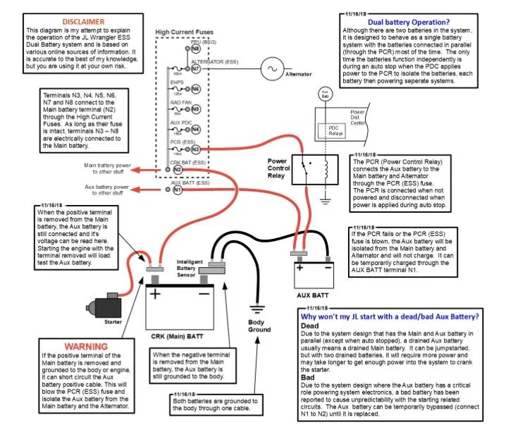

So the PCR is strictly for the ESS? If you remove the Aux batt you can remove the PCR too? I have an invertor that I want to put into the space of the Aux batt after removal and run power to the bed.
180
29,491
35,083
Yes - but keep in mind that you lower your reserve capacity if you remove the aux battery - meaning everything comes only from the main battery and you'll drop voltage more quickly.
Otherwise with the aux battery in place any load is able to draw from both batteries so you have a higher combined capacity.
