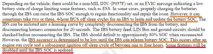

After an IBS reset, the IBS needs to re-learn the battery SOC (state of charge). It should default to 80% SOC. But the FSM states that it may take some 'cycles' and some features (like the ESS) may not work until it updates. So, even if you immediately get the circled A, give it a cycle or two or three for it to go away.
From the FSM:
Jeep Gladiator Olde Phart Tryin', wilst comin' out the udder side. 1734813977355-fj-
