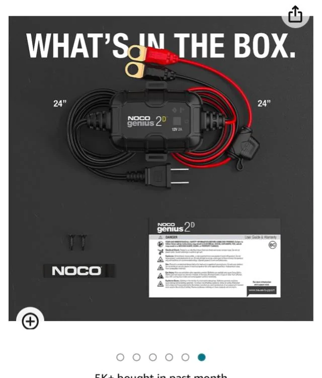

Has anyone installed a onboard battery maintainer on a diesel? If so where did you mount it? I know there very limited space under the hood. I have been using a maintainer but would like to mount one permanently now. Thanks

Yep. Five minute job. Bought the Naco 2 and used heavy duty Velcro to the top of the fuse box. The short cord reaches just below passenger side front fender liner. I have one zip tip at the bottom so it doesn’t move. When I park, I just grab the extension cord and plug it in. Plus people see my Jeep is plugged in and won’t steel it thinking it is a hybrid. :{)

Great. That's exactly what I was thinking of doing. Just wanted to know it would fit before I bought it. Thanks
